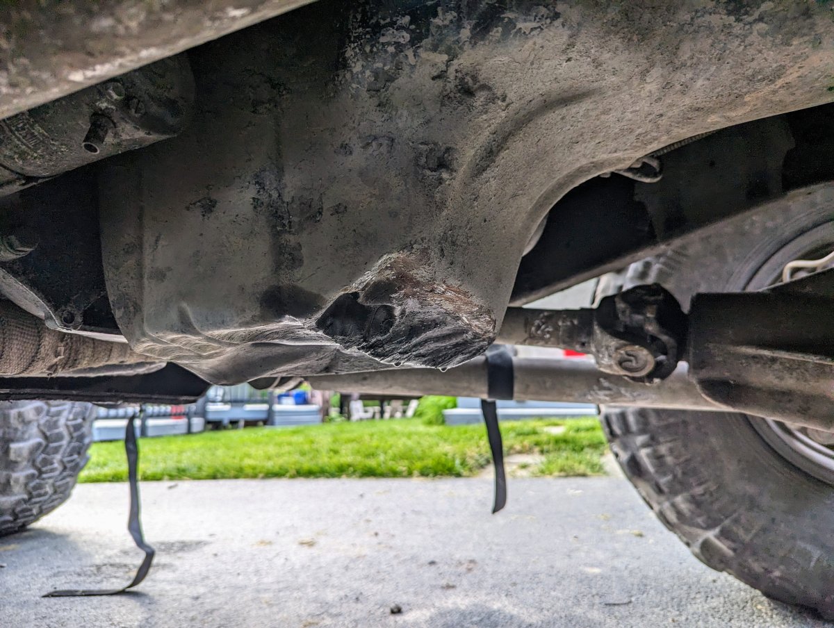

This is the most amount of damage i've done to a vehicle in the shortest amount of time. First trail of the day...

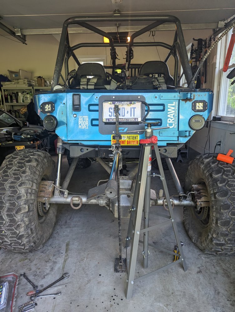

Got my strut removed and off to Jensen Brothers for a rebuild. A little sketchy but it worked out in the end

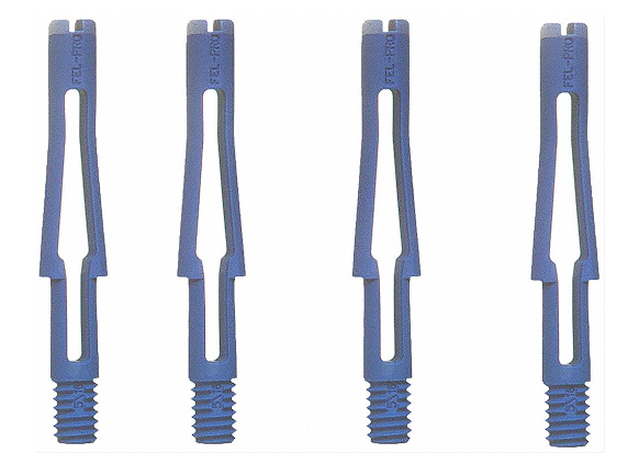

Little blue clips? Or little blue pills? I'm so confused.

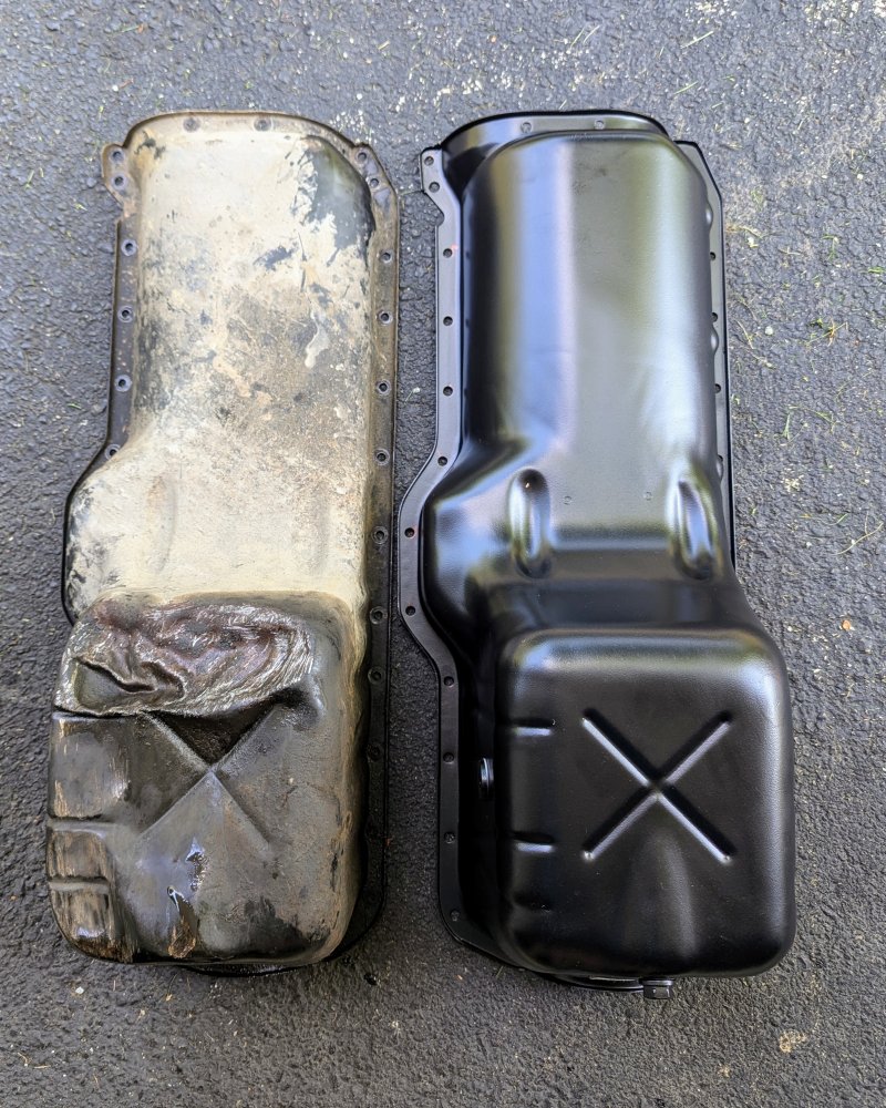

I did finally get an oil pan skid in that worked well enough, forget where it was from but I love these from Rock hard to keep the bolt heads protected

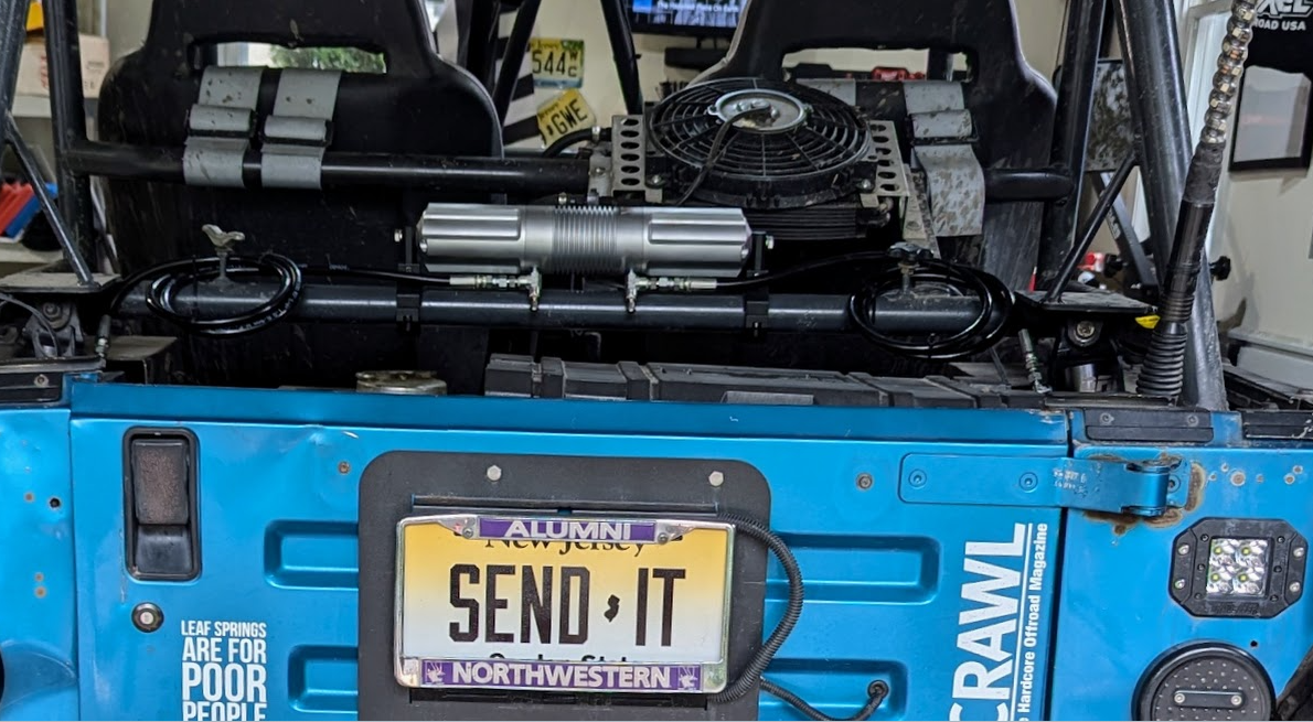

Splurged a bit with Jensen Bros when they rebuilt my strut - I ordered a level it from them. It's essentially a pneumatic sway bar and provides stability without the rigidity of a traditional sway bar. My suspension has a lot of anti-squat and got a little nervy on side hills. This helped a lot to stiffen one side in these situations
