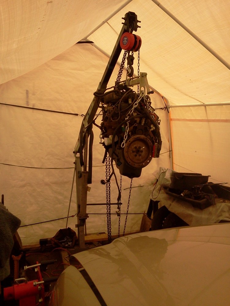

using the chain hoist I was able to be under the truck and lower it very slowly for maneuvering.
worked solo on both.
