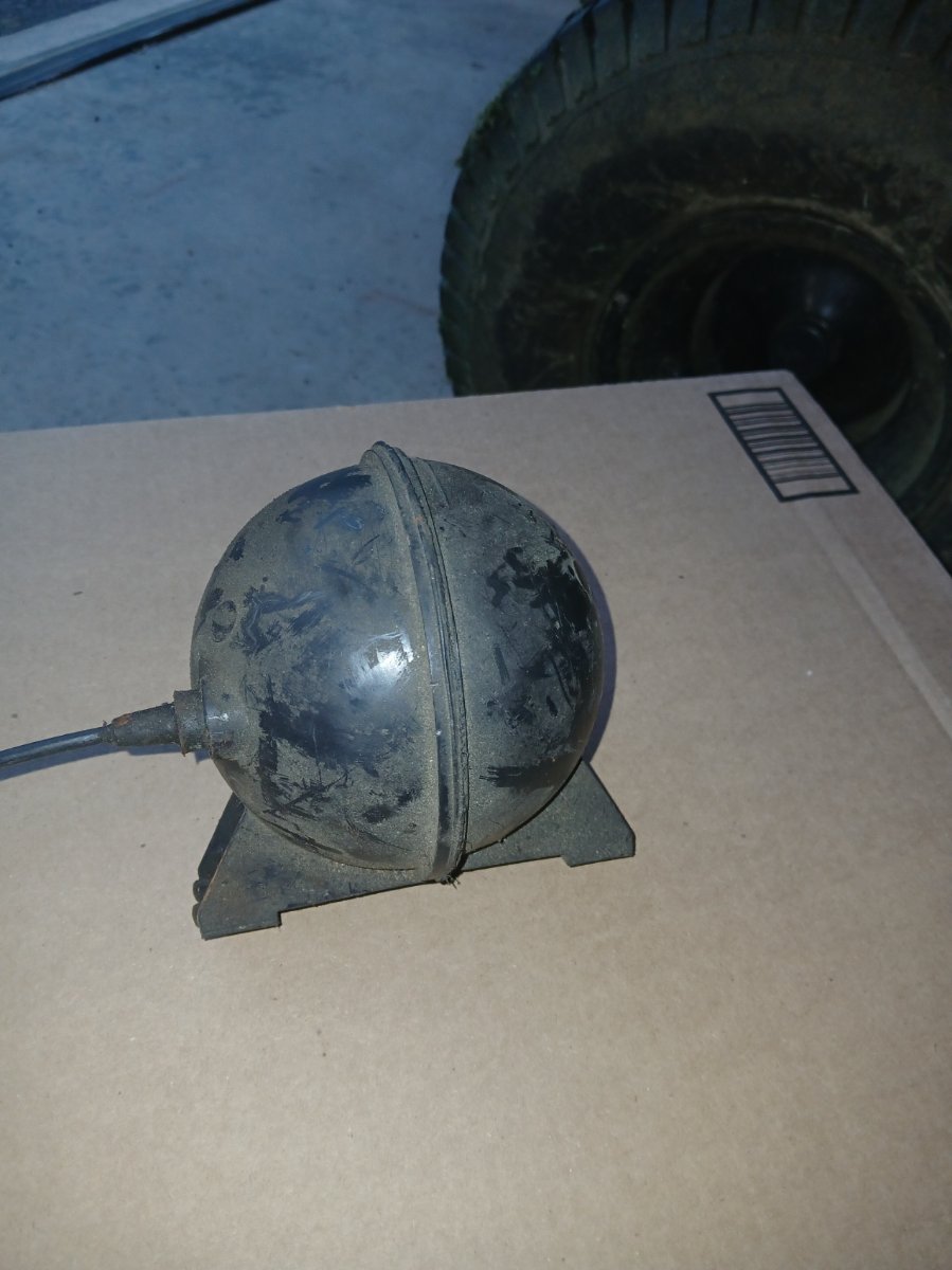

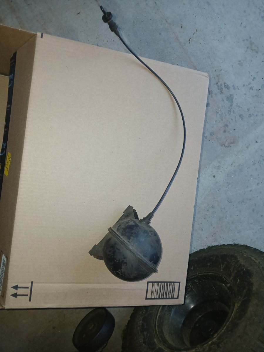

This vacuum ball was tucked up behind the oil filter and was just hanging. First question is what is it?? second is where the hell does it go???

That's a vacuum reservoir for the HVAC system.
I believe it goes on the passenger fender well. Near the blower motor.
One side to manifold vacuum... the other side goes into the dash HVAC controls.

It really doesn't matter where you mount it. Just keep it away from extreme heat. On my 96 Explorer, it was under the unner fender un the front passenger side corner of the engine bay. In my 93 Ranger, foe tje past few months, I just had it lying on top of the heater blower box, not even scrwed down.
It mounts to the passenger fender well. There are two holes that align with the mounting points. It's just plastic on plastic.

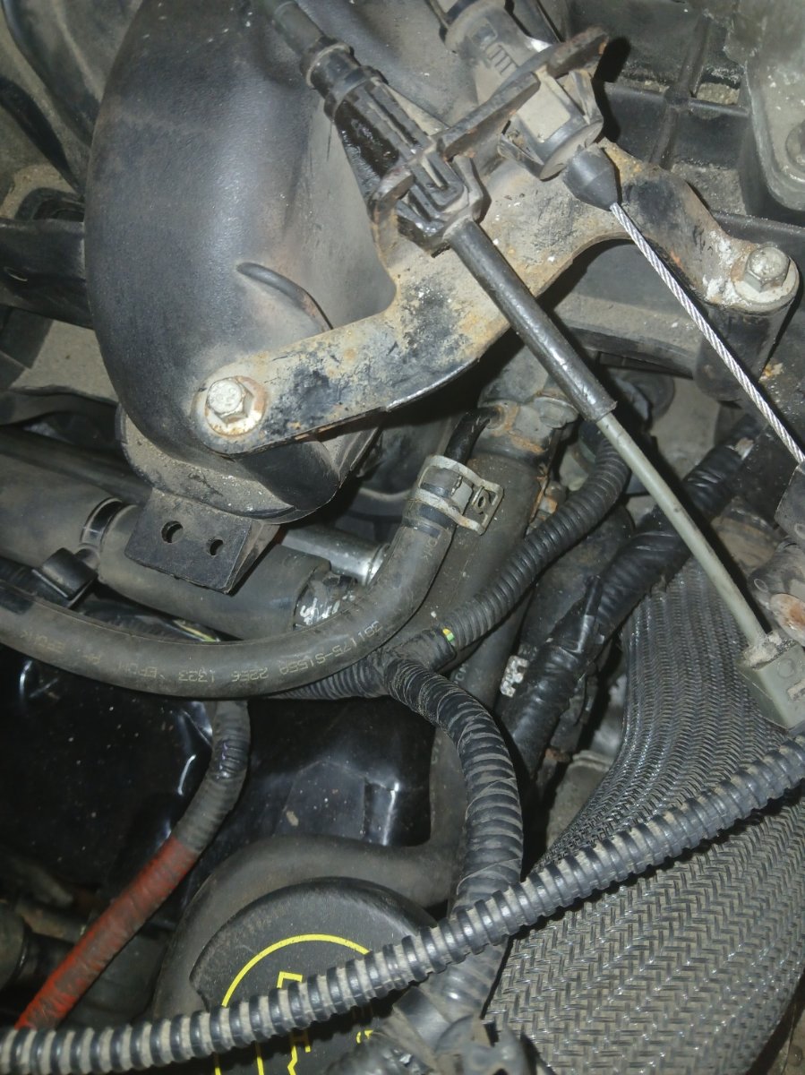

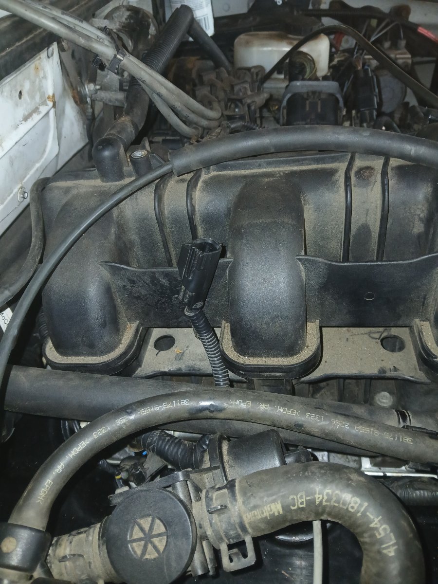

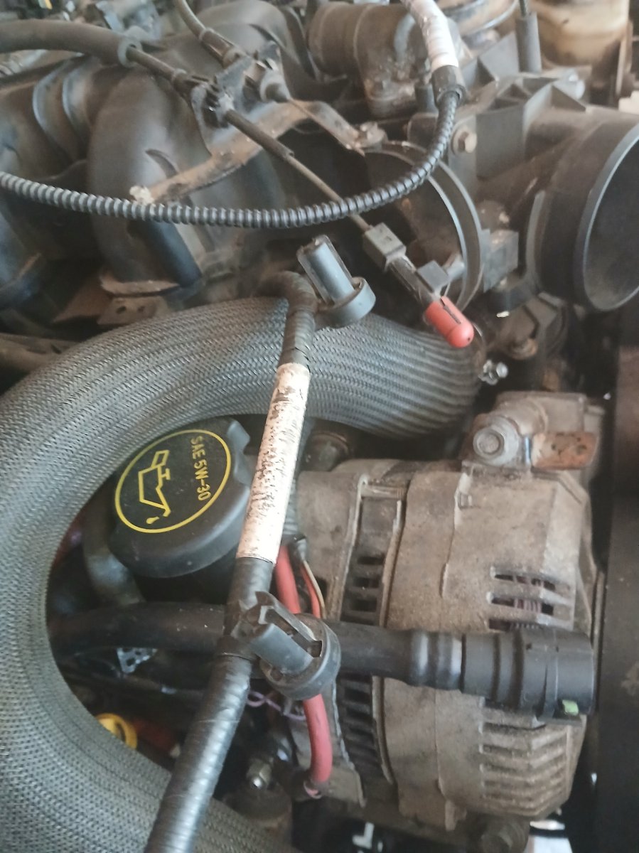

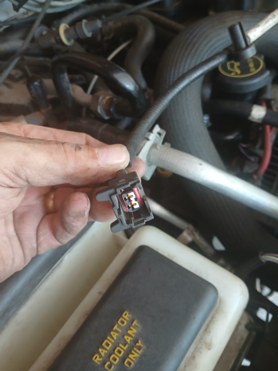

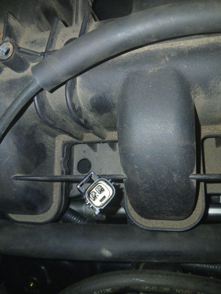

Vacuum is figured out and now I have a wire that I cant place at all. There is a similare wire on the drivers side that plugs into a fitting on the valve cover but nothing on the passenger side that will accomodate this plug.
This is part of the injector harness on the passenger side...
CLUELESS!
Thanks!!!
just added a pic of a second wire...
