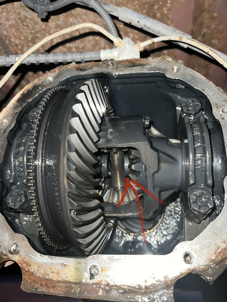

My truck makes a humming/whirring noise that seems to reverberate up through the bed and cab as I accelerate and am maintaining 25-50 mph speeds. Even at highway speeds, you can still hear it.
I have thought that most likely it is the rear differential with a bad pinion bearing or something causing the noise. (I don't know exactly what that bearing does, but I do know what the diff's role is, and that the bearing is tough and expensive to replace). It is not a limited slip. I'll post the tag code when I can remember where I put the thing/pull it from an old post.
I have looked at the rear diff twice now. There are no chipped or ground gear teeth. In my opinion the diff looks like it's in really good shape. The first time I looked at it almost a year ago, the fluid was milky gray and looked pretty bad/old. I obviously, changed it sealed it back up, and this time I looked maybe 10k or more miles later it looked pretty good/fresh still. Here's a picture I took of it last night, I'm not sure if the spacing where the arrow is is normal or not, but that's the only thing that looks possibly off to me.

Arrow is pointed at the end of the axle shaft, yes there will be a space, thats the in/out movement you feel when tire is off and you pull and push on the axle
