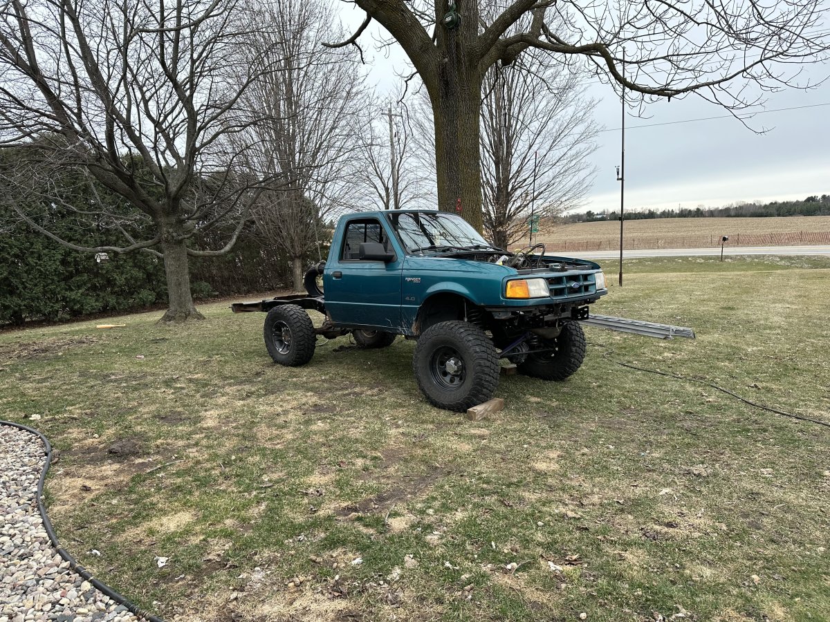

There you go, a ‘94 cab on a ‘90 frame.

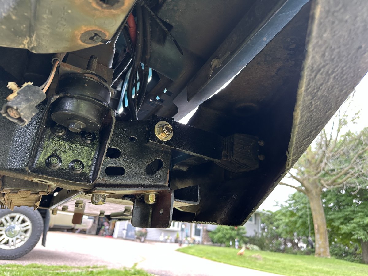

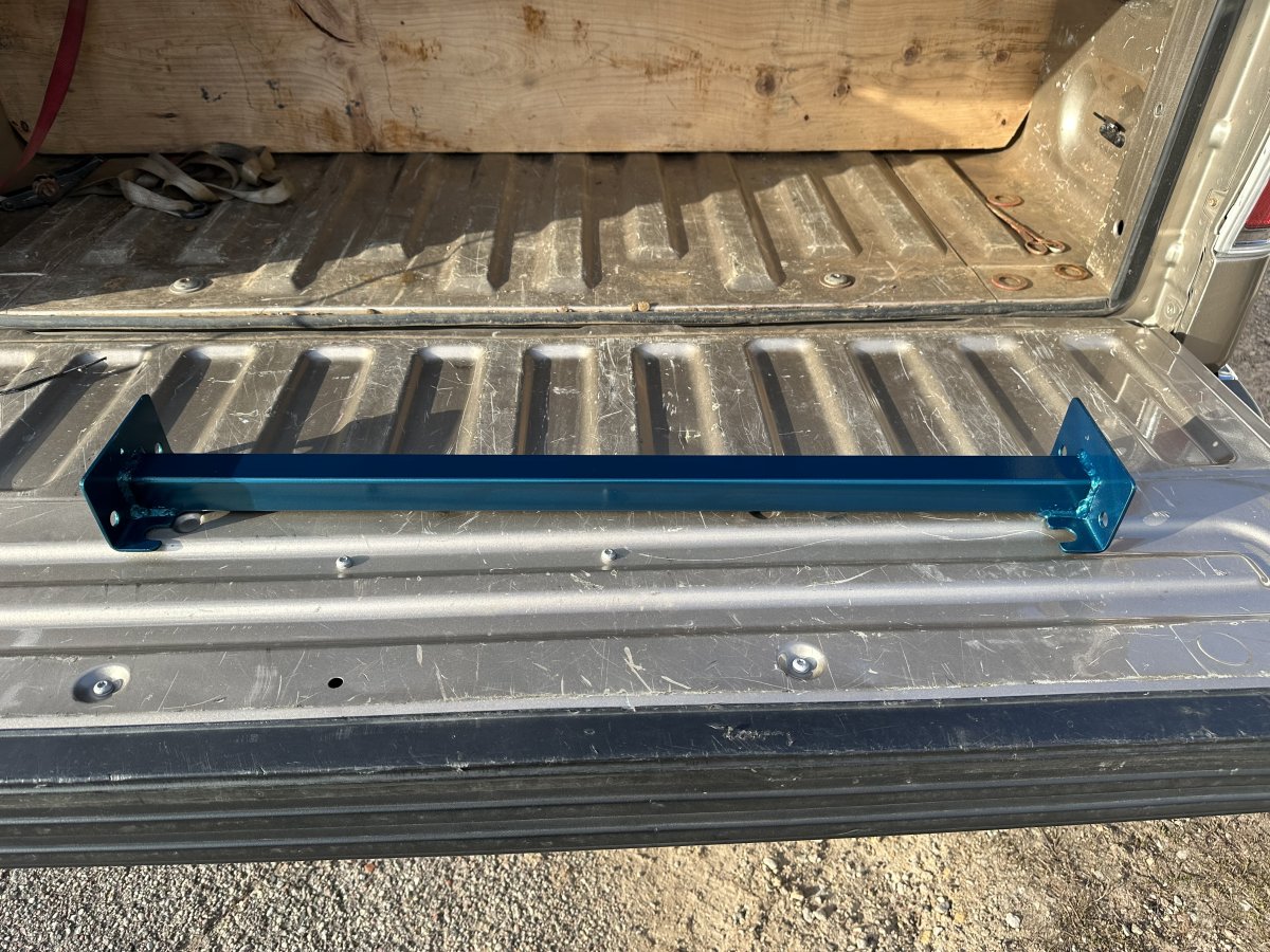

The only thing I’ve accomplished since I got the winch mounted back up is to make and paint a rear crossmember.

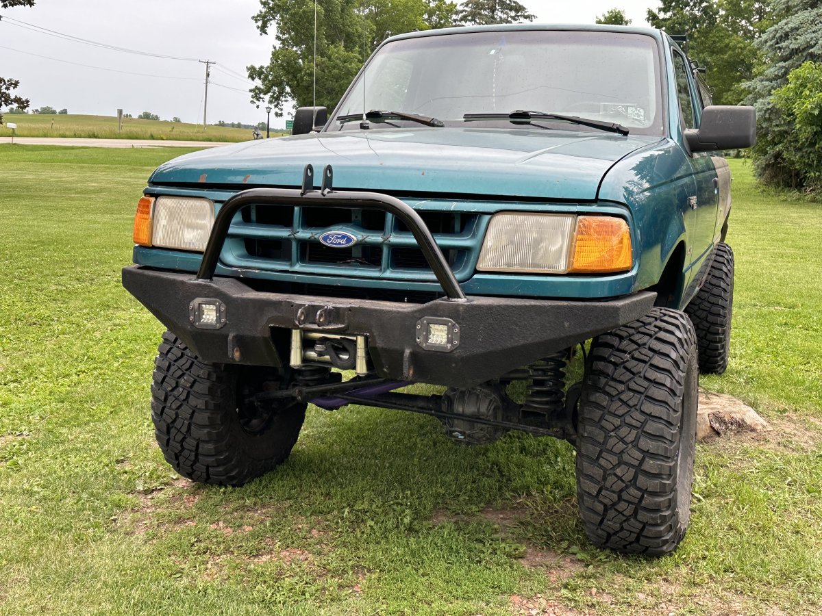

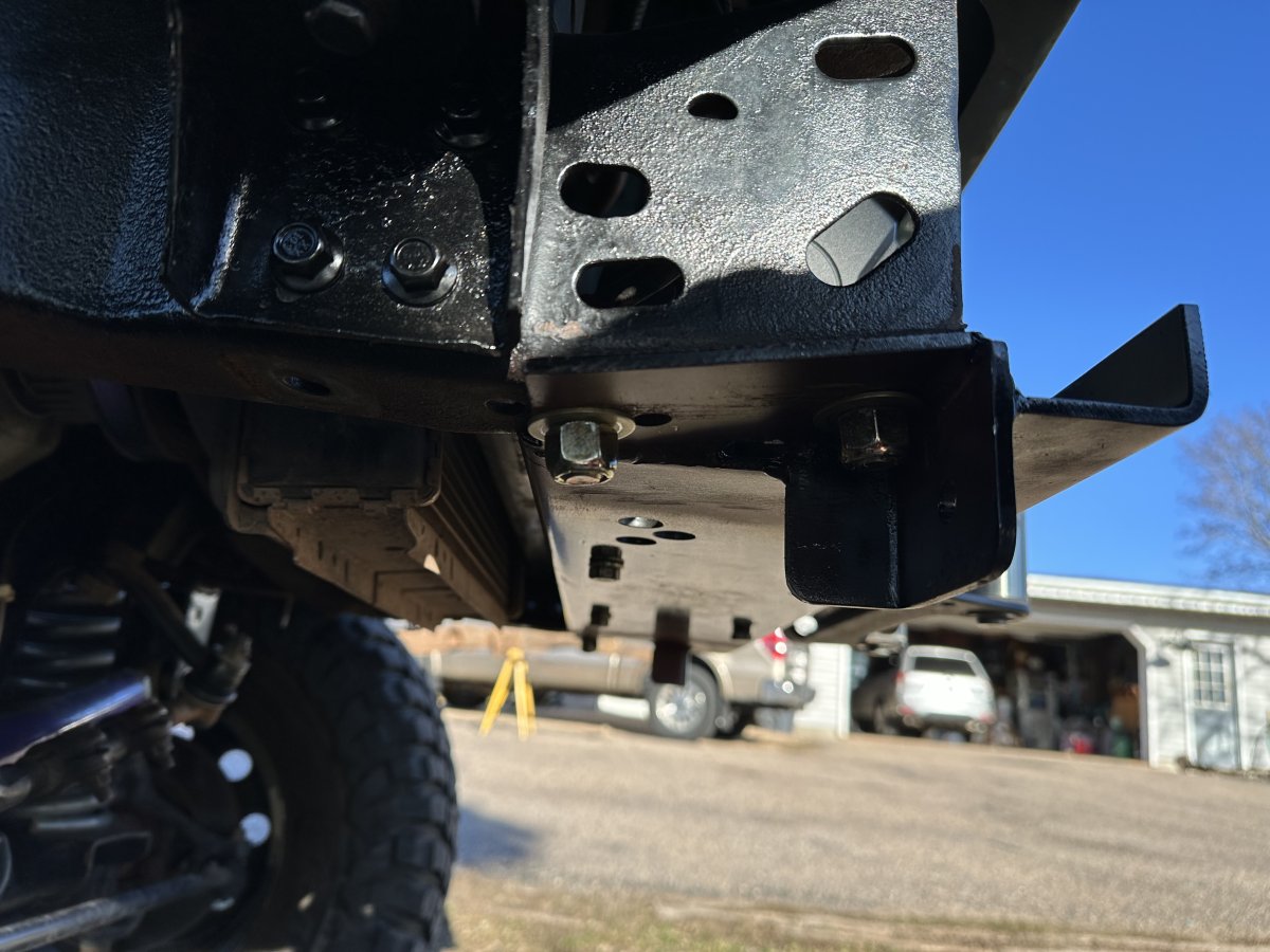

Finally got the front bumper back on with the winch mounted. Remote mounted the winch controller connector.
I can mount my plow pump without removing the winch now.

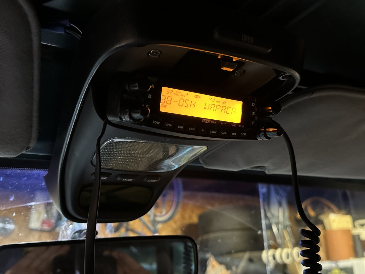

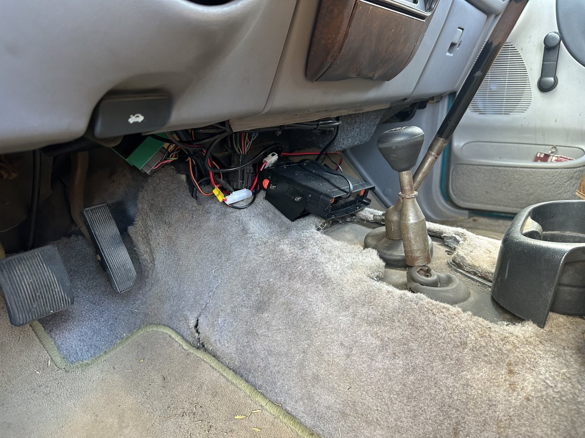

Radio mounted. TYT 9800D plus programmed for ham and GMRS. This radio is 50 watts max on vhf and 40 watts on uhf/GMRS and functions as a cross band repeater. It’s clipped on to the factory springs for the garage door opener compartment door.
Body of the radio is mounted upside down on the floor so the speaker faces up.

That's some good work on the winch and bumper :icon_thumby:
Thanks! I wish I had a fabricating table to pin it to while I welded in the fairlead box. Bumper has a bow in it now but I'm fine with it.

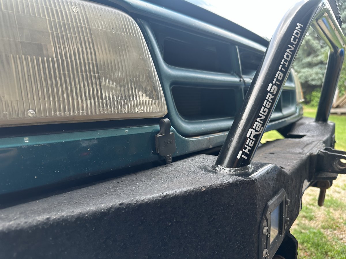

I looked all the way back through your build to figure out where you bought the bumper, only to find out you made it. Darn nice piece!

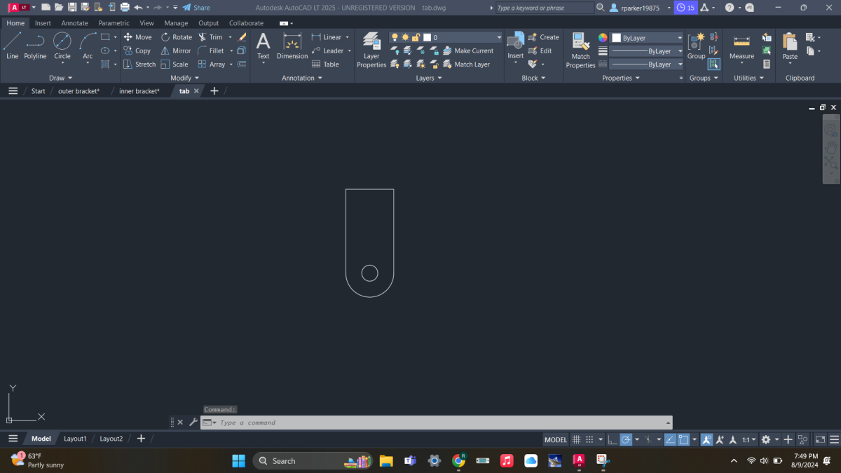

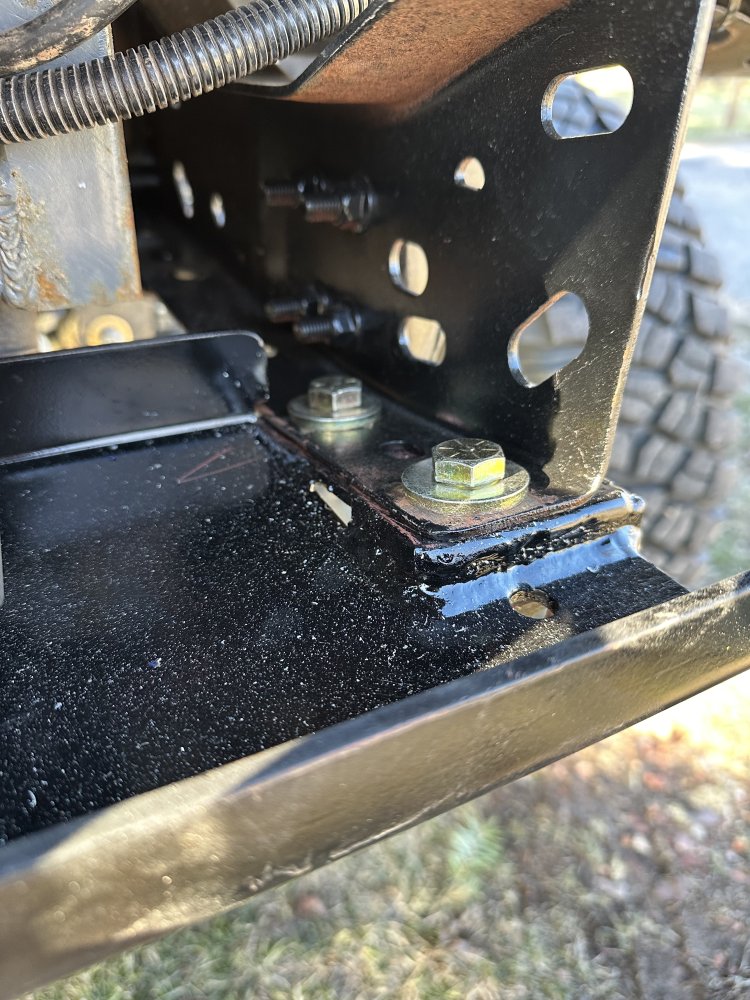

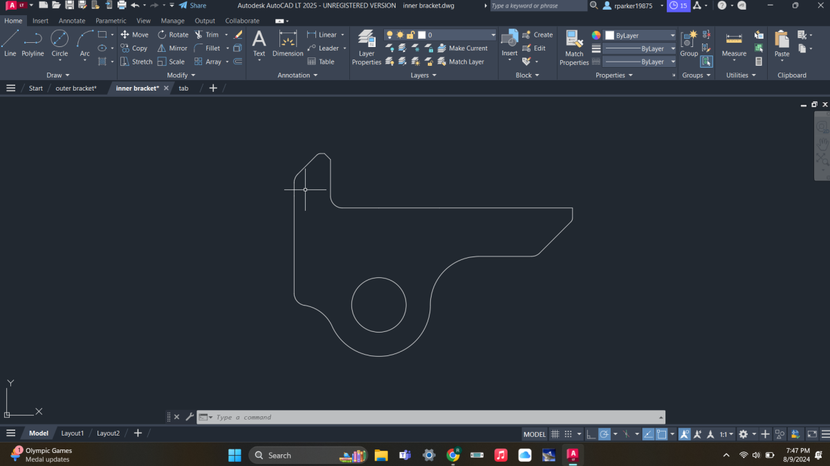

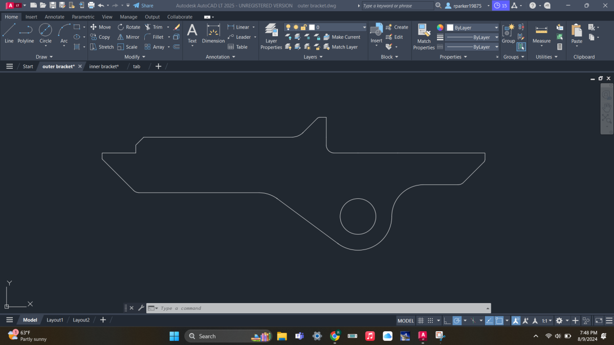

Took a look at modifying the plow mount I made last fall to fit the older frame but the mount just isnt wide enough. Next best option in my mind was to start over completely. You can download AutoCAD LT for a 15 day free trial so I did. The end result was a plan to weld mounts to the bottom of the winch plate. Here's what I drew up;
Pic 1 is the outter plate and will have a tab welded into the notch on the left that will reach out to the forward most sway bar mount hole. The notch on the top right will wrap around the back of the winch plate.
Pic 2 is the inner plate
Pic 3 is the afformentioned tab
Hopefully have everything cut out this monday.
Thanks! Its proved to be pretty versatile
That’s slick! I’ve never messed with auto cad or anything. You cutting that stuff out with a grinder at home? Or have access to a plasma table?
Also what do you think that bumper weighs?
I have access to a high definition plasma table. The pin holes are 1.125” for reference.
As far as weight goes, I think I had figured out at one time that the bumper came in around 70 lbs.. I can easily pick it up by the bull bar and hang it on the truck myself. It bolts to the fair lead part of the winch plate then has some outriggers that bolt directly to the frame horns higher up. I’m trying to keep it to where I don’t need the chainfall to disassemble the front end.
