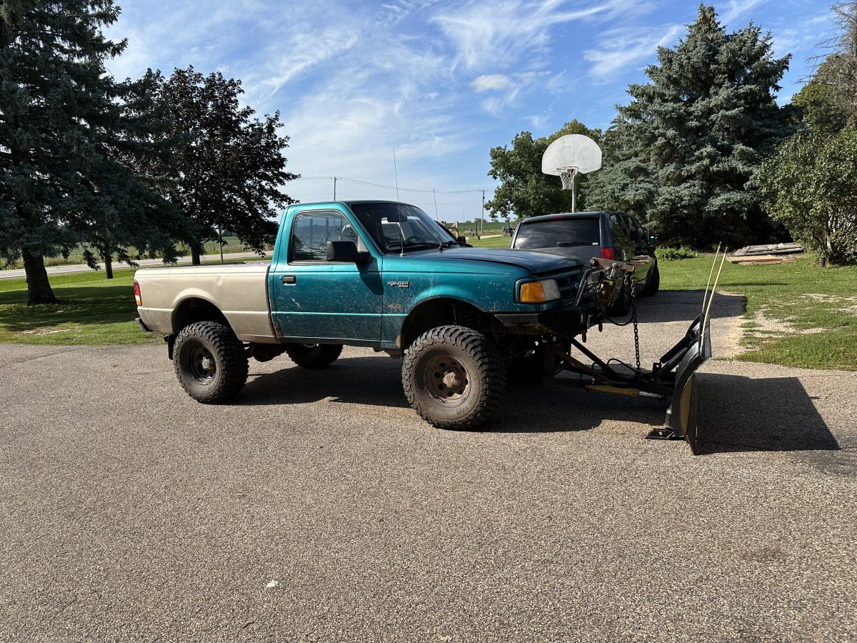

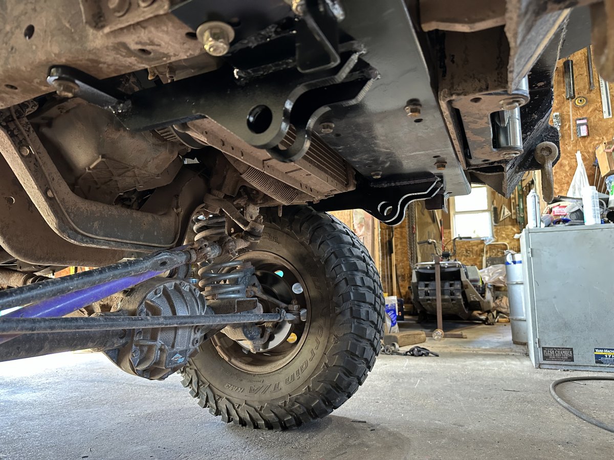

It’s all 3/16 material other than the two outside pieces under the fenders. Those are 1.5” or 2” channel. I’m sure it could have been made much stronger but at the time, weight was an issue. Between the winch, bumper and plow pump, I probably hang an extra 200lbs on the front end. I’d say the plow itself is 350-400.
Sounds plenty strong unless you’re bashing things constantly. Weight, especially so far out, is such a killer for suspension. I can tell it’s hurting my front shocks. I either need for compression valve, stiffer springs, or less weight and I don’t want to tear into the shocks.
That plow must sag the front a good bit
Exactly 1 inch. I couldn’t believe it because the springs are only something like 190 ppi. They are 3.5 inch lift springs for an Early Bronco.
The Bilsteins I have under my front end are getting to the end of their life. Not sure where I’ll go next. If it wasn’t for the plow, I’d consider coil overs.
I’ve been looking at coilovers for a future upgrade as well. But then I think about how easy it is to service stuff with separate shocks and springs. Bilstein needs to get their crap together and release universal fit zone control shocks already. I’d love to not have to hack up my front frame to put in hydro bumps.

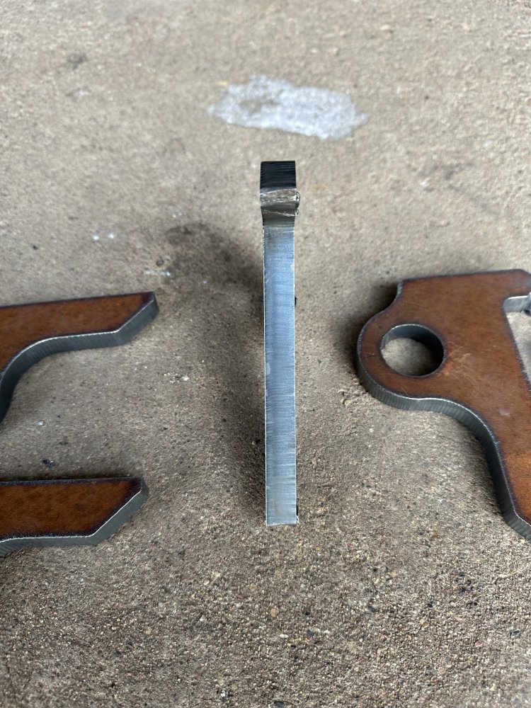

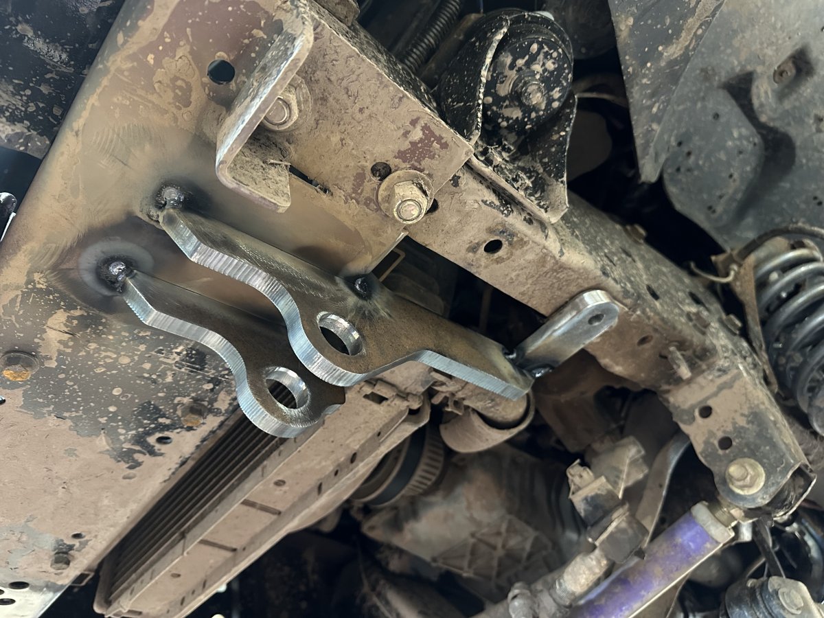

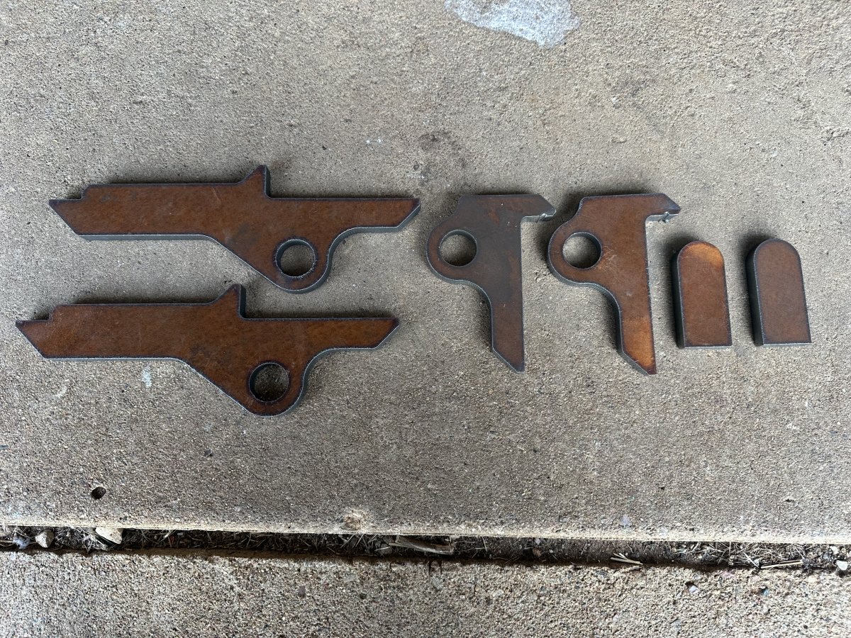

Got plow brackets cut today. Hopefully get time to get them tacked on and welded up this weekend. All 1/2” plate. I’m thinking I might weld a 1/4” doubler plate to the winch mount before I weld these on.

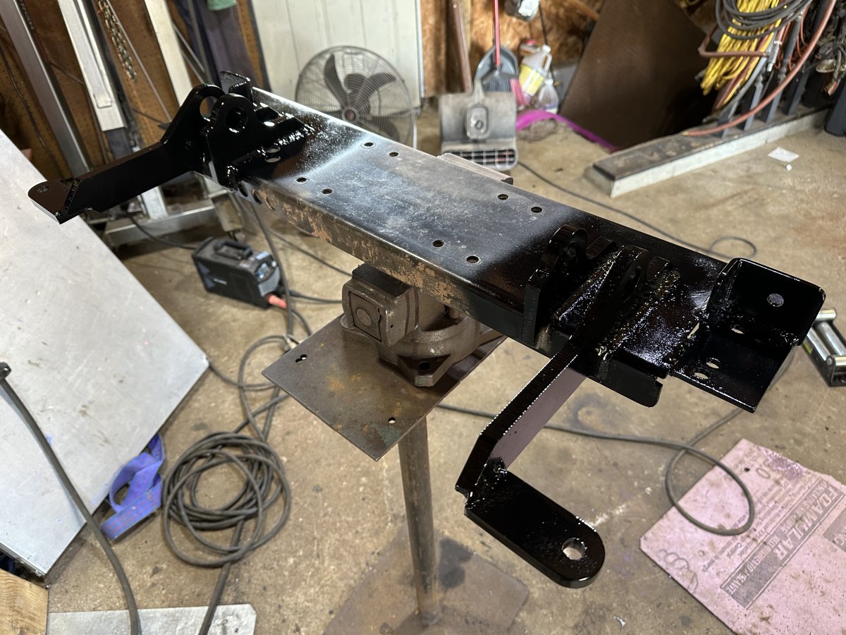

Plow mount is done. Putting the pump on now so I can see how everything sits. This one should be 2” higher than the old one which is a good thing.

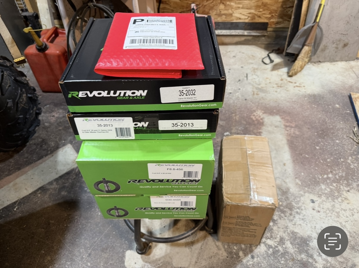

BUT! I did order gears for the truck finally. After searching high and low for a US company that still manufactures gear sets in the states and coming up empty handed, I settled on Revolution Gear. Good price and supposed to be of the highest quality. We’ll see.
I won’t get around to installing them until the kids go on spring break from school. My wife has to have her gall bladder removed and scheduled surgery for my first day off that week. Kind of bummed because I lose a day but she’s more important.
Ordered a crush sleeve eliminator from Bronco Graveyard. I don’t think I’ll have the room to crush a crush sleeve working on the floor. I don’t think I could do it even if I started it in the press.

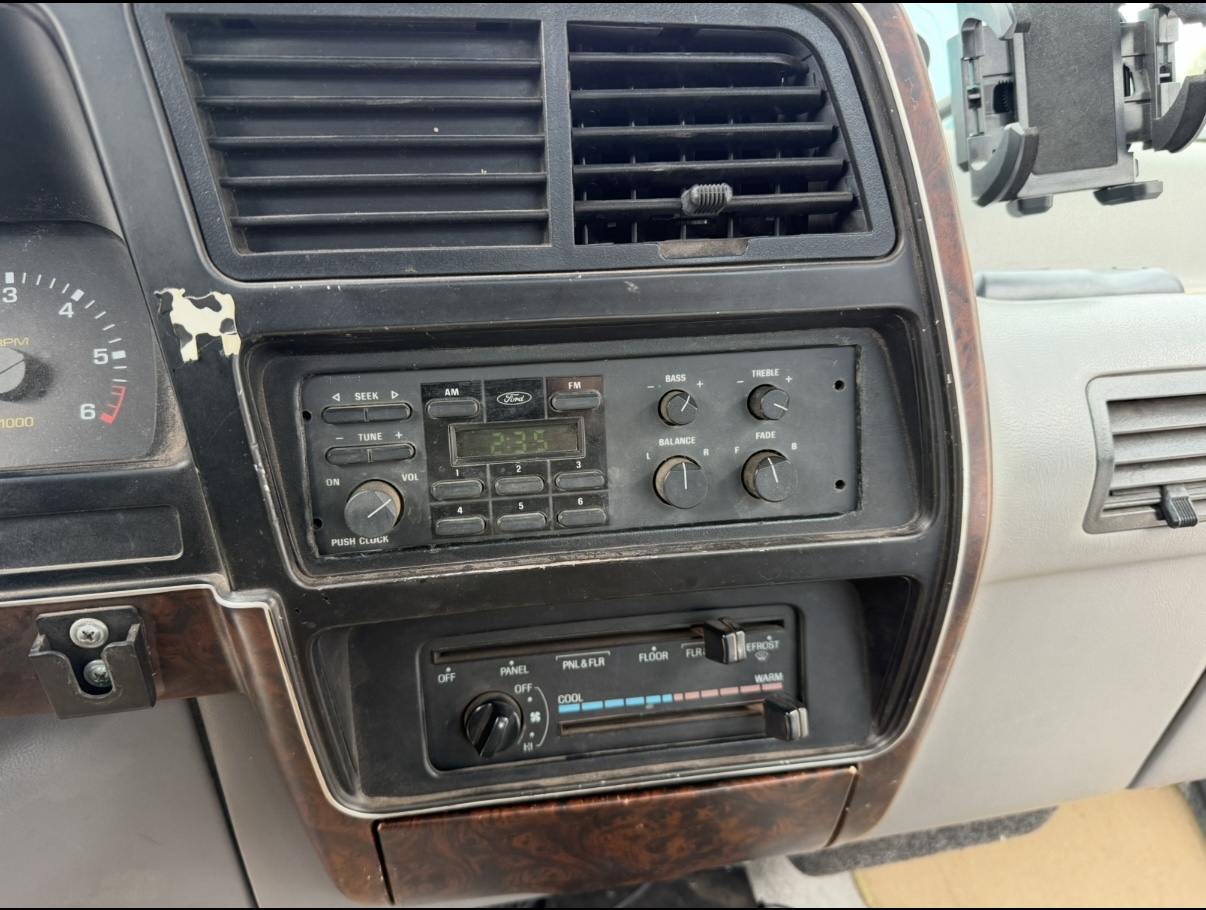

Also pulled out the craptastic Car Play radio. It would randomly shut off and seemed to overheat after that happened a few times. I don’t need Bluetooth or a nice radio so I tossed in a Ford radio I had laying around. Kind of bummed I cut the opening in the bezel to take an aftermarket sleeve.
Some careful work with a dremel or rasp and sandpaper could make that bezel indistinguishable from factory...
