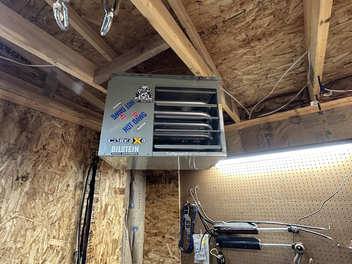

Got the sucker hung anyways and tossed some stickers on it. It’s not plumbed for gas yet nor the exhaust. I also need to pull wire for an outlet in the corner for power.
‘94 4x4 Swap/Build
Once the electrical is ran, I can finish insulating and sheeting the shop side of the garage.

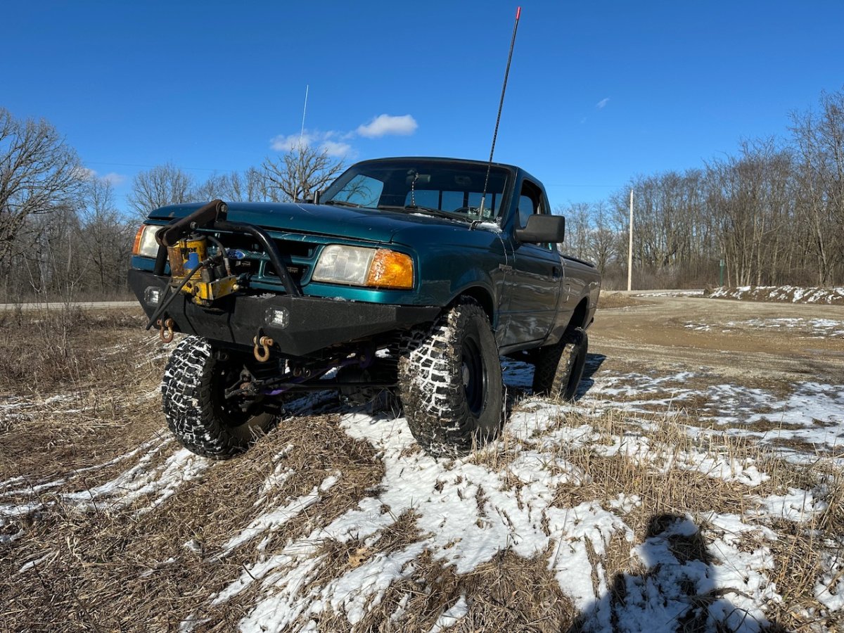

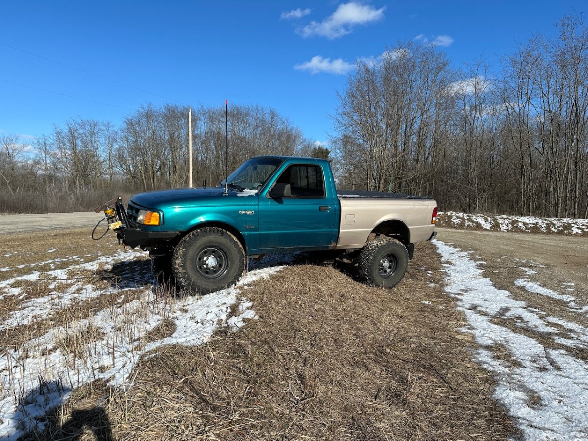

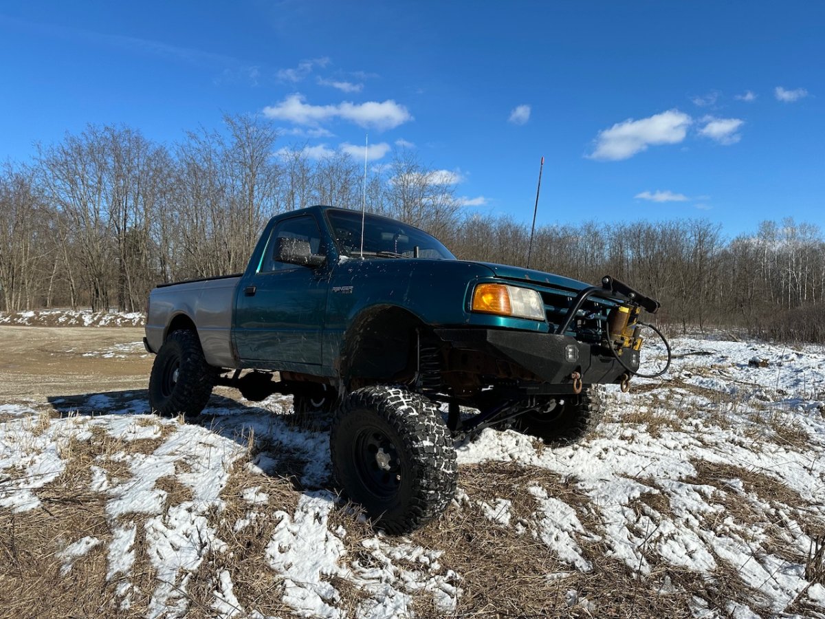

Went for a ride today to see how hard I could get the truck to flex. I think I could stuff a 35 pretty easy but I can’t get a 33 up in the fender well yet. I’m afraid to try driving it over the taller berm in that same area. I have myself convinced the truck will get stuck or break. I’m sure that would get me closer though.
Currently working on some adjustable coil buckets and want to switch to f250 shock towers when I get the buckets done. May have to push the front axle forward a bit in the future.
I need to get my crap straight and regear the truck. The 3.73’s are useless with 33’s unless it’s in low. The next set of tires WILL be 35’s so I’d like to go to 4.56. I don’t even remember what torque feels like lol. I’d also like to finally get the dang thing out on some trails that will give it a workout.
