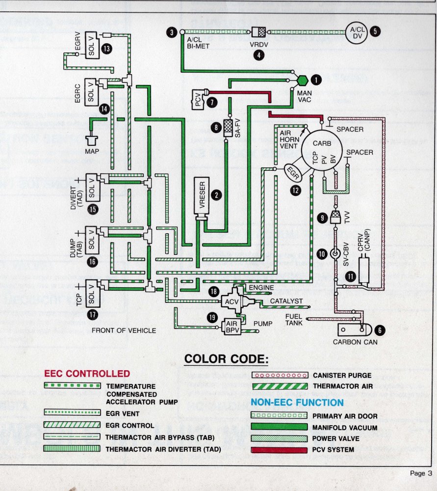

On a truck so old and so original, the plastic vac lines will be really brittle and you may run into a broken line creating a vacuum leak. Here's a diagram for your truck in case you need it:
Finally, the original setup on the 2.8L was a "computer controlled carburetor" system. These systems are complicated, really didn't work well when new, and with age can be tough to make run right. Some parts are hard to find (and there's a lot of them!). I have an '84 2.8L, and at first I tried to keep the CCC system intact, but finally accepted reality, and converted mine to Duraspark. I hope that your truck responds well to a little TLC, but if it doesn't look hard at the Duraspark conversion (it's the best thing I ever did on my '84). There tons of info here on TRS, and it's easy to use the "search" function to find it.
