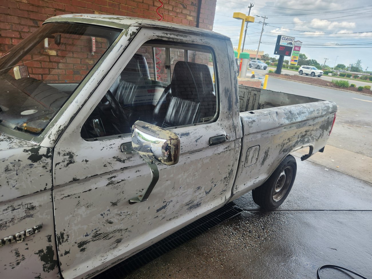

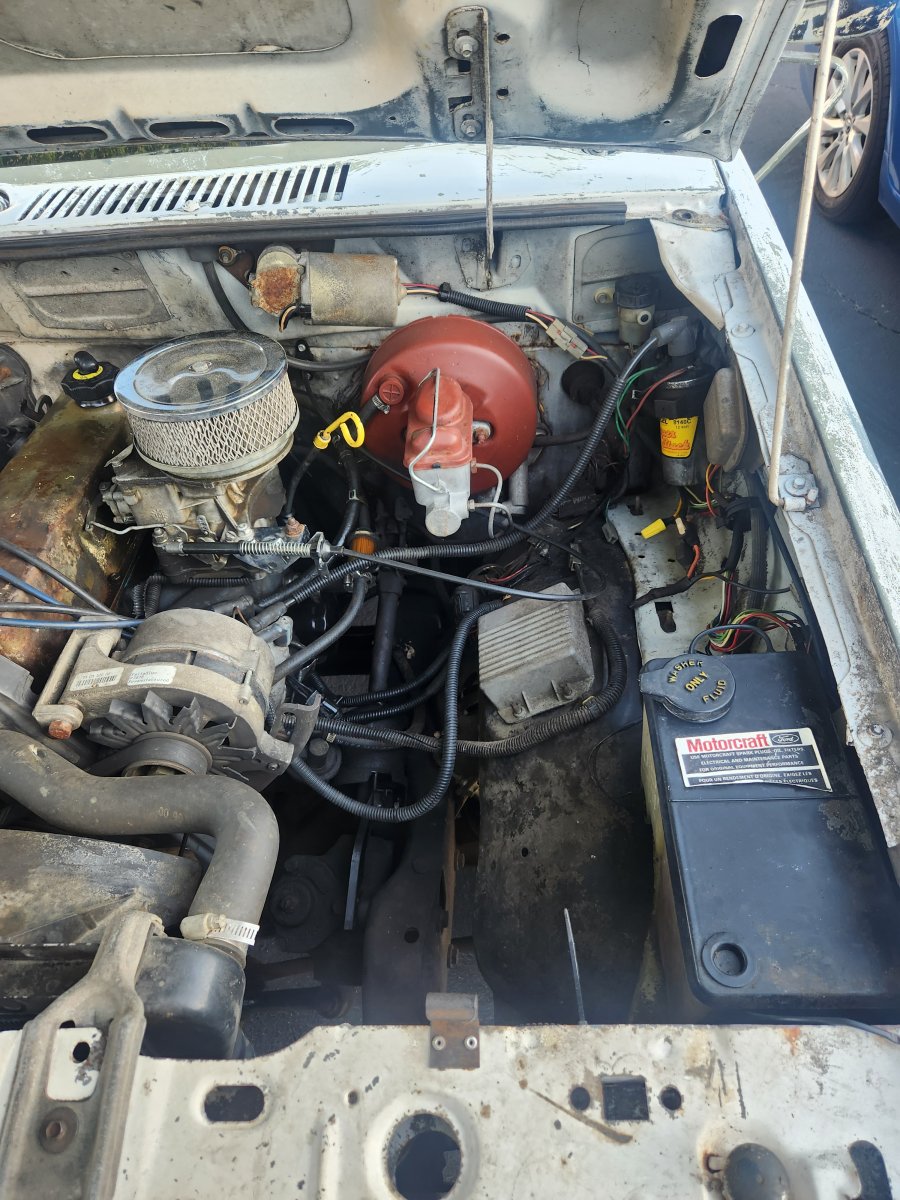

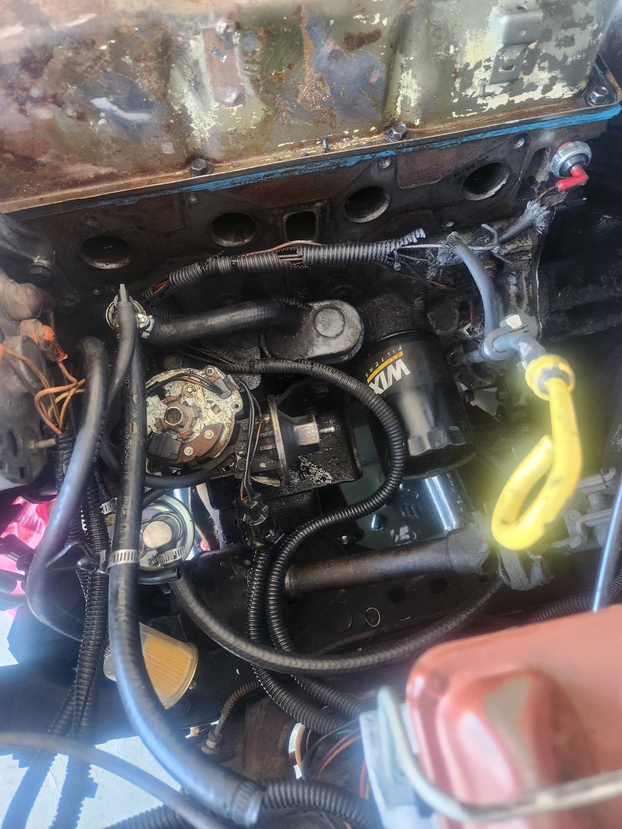

Here are some pics of the engine/head, plus some of the truck just to show. Most are all before I've done any work on it. I'm not worried about cosmetics rn. But yes, the manifold i took off the guy claimed was from a boat and the bores didn't line up in the slightest. I can double check how far off and add a spacer like you guys suggested. I did see a 2.3ltr manifold on FB market place but wasn't sure in what diection i should go with this engine, or how strick i should be with the head match issue. I even considered doing a full swap to a 302 v8. Yet i love rare things so i struggle with accepting defeat, lol. Give me some time and I can take a pic of the manifold I took off. As you can see, I'm missing quite a bit in the bay and what is there is a mess. No coolant lines to the engine so it's no surprise it blew a gasket and leaked oil. How invasive would i have to be swapping to a 2.3ltr? Would the tranny still line up or would I have to swap the gear box too? - I can work on aircrafts but vehicles are still a learning process for me. I appreciate you guys help.

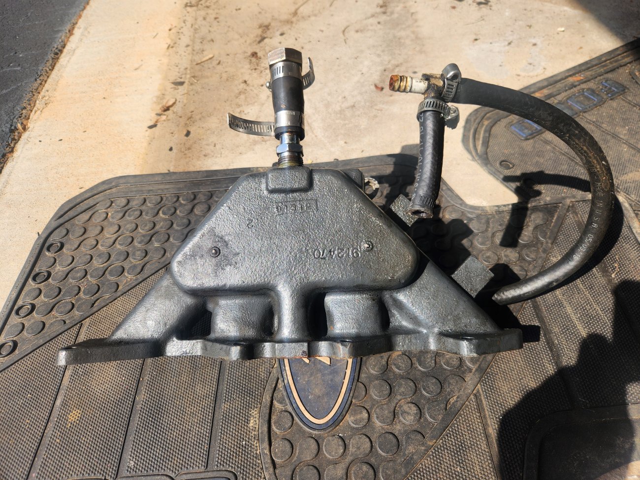

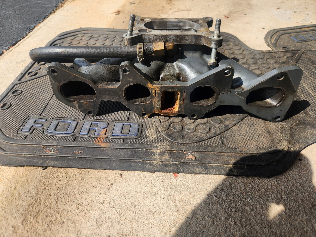

That would be better than whole engine pics. Unfortunately a Lima looks like a Lima. Unless it's got a big sign on the intake or valve cover (or EFI) most of us wouldn't know a 2.0L Lima engine from a 2.3L Lima engine on sight. Some might be able to identify parts with the engine disassembled, but I know I wouldn't except in a very broad sense.

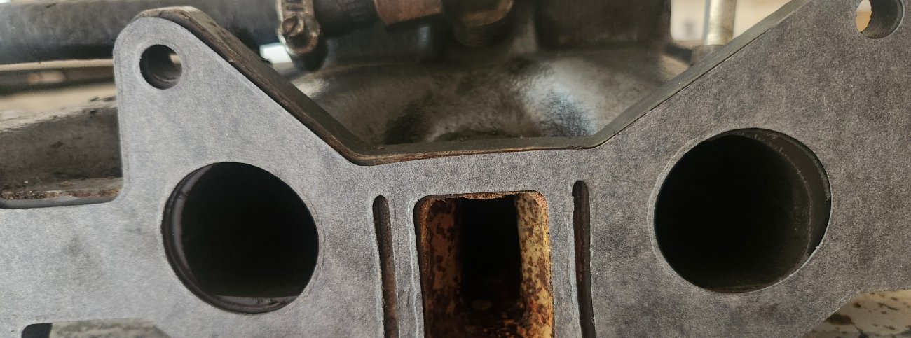

You've shown the head ports, but the manifold was pretty hidden. Some more detailed pictures of it would probably help in identification and determining if there is a missmatch issue.
I certainly won't discourage you from that. It's something that only you can decide. There are advantages to having a little 4 cylinder truck. You won't find a smaller, lighter 4 cylinder truck made in the last 30 years. Ok maybe an early Nissan or Mazda, but good luck finding on in decent shape (physically or mechanically) and as affordable.

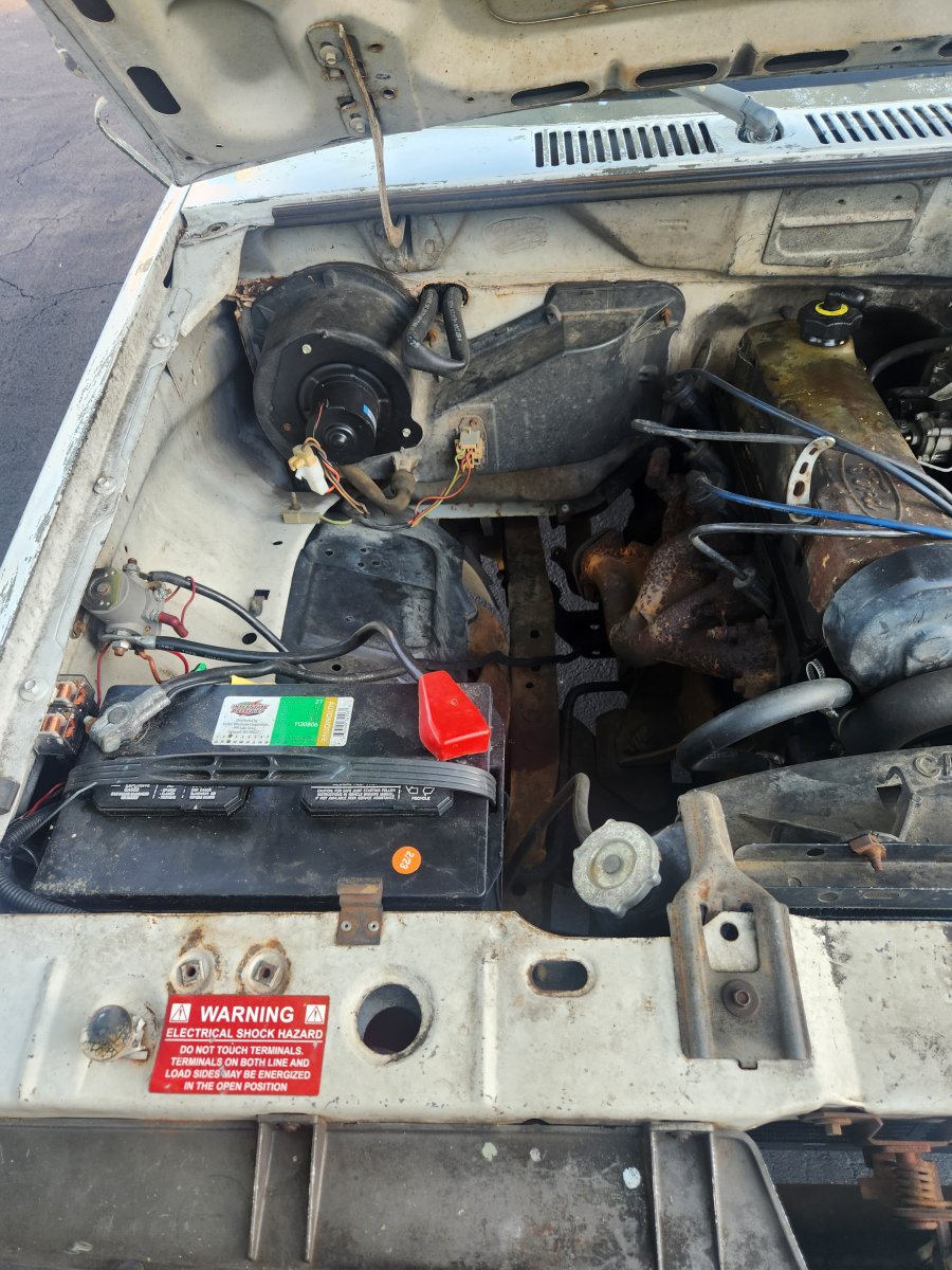

Maybe not. This was apparently a base model truck, not a lot of options. It didn't have EFI or AC, so there isn't really much more that would have been there from the factory. You're missing some coolant hoses to the heater cor, they've been looped and bypassed. Might be missing an airbox, not exactly sure what these had with the carburetor, but that aircleaner isn't stock. Maybe some emissions equipment removed, but the 2.0L might not have had that stuff to begin with.
Really, I can't see where you are missing very much. It was a very stripped down engine bay from the factory.
The coolant lines that matter appear to be there. You've got the ones going to the radiator. The heatercore is bypassed with those ports looped on the engine. That was probably done because the heater core, or a hose going to it, developed a leak and it was bypassed at the engine. A couple of caps would have worked just as well since coolant isn't required to flow through those ports, but hose and hose clamps were already available on the engine for bypassing. PO then decided he didn't need it enough to replace it.
Entirely possible that the leaking heater core caused it to run low on collant and blow a gasket, but bypassing the core itself would not cause that issue.
Fix your leaks/gaskets and carry on. If you want the heater back working, check your core for leaks and replace if necessary, then run new hoses from the engine to it and back. Word of advice, since that truck does not have AC. When you repair the heater core install a valve in one of the hoses to shutoff flow. Then you can close the valve in the warmer months when heat isn't needed and it might decrease the vent temps a little. I know that helps on the super duties that always have air blowing through the heater core (even in AC mode) and in stock form always have hot coolant flowing through it too. Cant recall how the Ranger's air path looks in various modes.

Summit shows the 6001-DP available for the 2.0L, but I would not spend the money on it. Instead, I'd do the 2.3L swap and invest in parts for that. Cost more, buy I think you'd be happier with the results. From an unique or original standpoint, no one looking in the bay is going to know the difference between a carbed 2.0L and a carbed 2.3L unless there is a sign like mentioned previously.
Numbers being 91312 and 912470. Am I to assume it's a 2ltr given it has a stand alone #2?
It does bolt up. However, the inner bores are more restricted given it makes a ( ) shape when comparing to the gasket that lines up with the head. I suppose that wouldn't matter as much since swapping to a 2.3ltr does seem more logical than trying to restore this 2.0 that will most likely cost the same if I'm being honest and are right about the moisture being in there. I've never seen a sparkplug look like this before.

On that plug it's just some oil probably from rings or valve stem seals. I would not worry about that amount of gasket mismatch, that's nothing...
It was on all the spark plugs, but thats good to know. Like I said, I wasn't sure how stict or worried I should be about the bores lining up. So I'm glad I don't have to worry about it too much and can use what I have. Thank you all for your input. I appreciate the help getting a game plan together.
