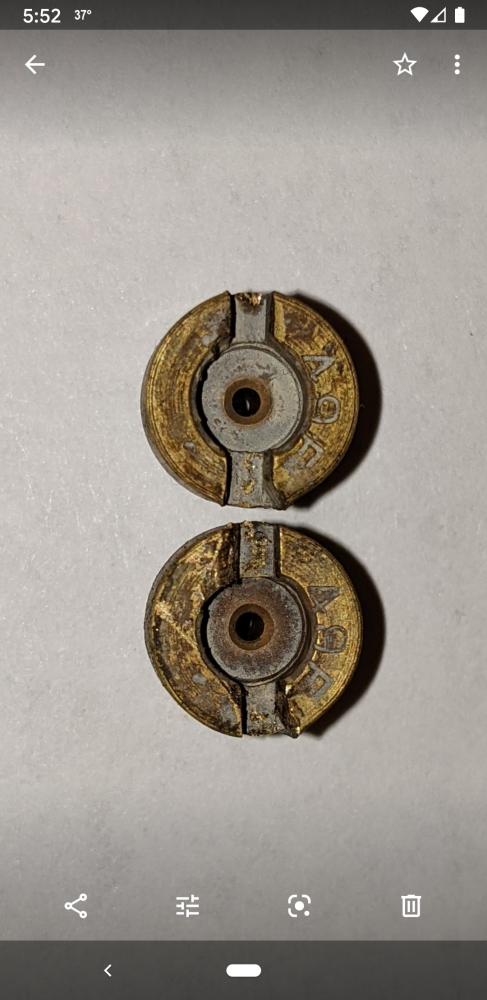

On another note, I went and pulled the jets out of my 2150A carb that was on it. Looks like they were #49. I need to pull the top off my other carb and see what the 70's offered up in comparison. I'm at around 800' above sea level. If the ones in there now are smaller, I'll swap in my 49's and experiment. I might order some other sizes later and see what gives me the best results.

Change one thing at a time so you know what worked and what didn't. I would address the centrifugal advance first and swap jets later. I have a bunch of 2150 jets, too.
Good advice. I'll start with the timing. Time to get a good timing light on order.
