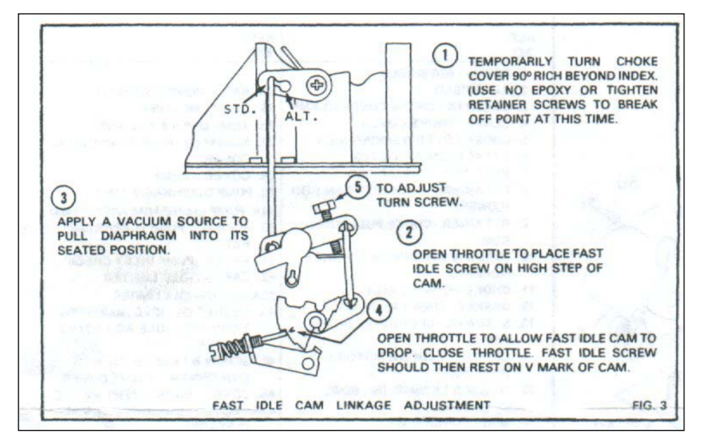

If the choke is set up properly you should have to step on the gas about 1/2 to 2/3 of the way to the floor once, release the pedal, and turn the key. After a few seconds on the top step of fast idle you should be able to tap the throttle and kick it down to the second step without it stalling. If you want to take off without letting it warm up for a few seconds you'll need the pull down to be a little tighter, if you let it warm up you can go a little looser.
I think I'm close to that now. I'll have to drive it a few more days and see.
