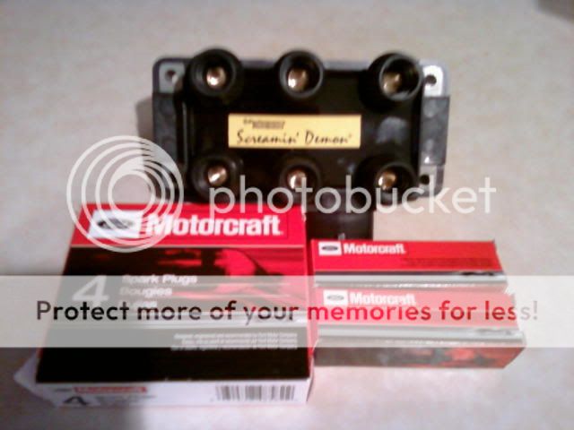

So like many of us here I have been battling a rough idle for quite awhile. Ive cleaned the MAF and IAC, new fuel filter, air filter, seafoam, plugs, wires, and all kinds of stuff. I decided to get a Screamin Demon coil pack after reading lots of reviews on them and hearing about how much they help. I was pretty hesitant about it but didnt really know what else to do. I was really surprised at how much it really helped. I installed new plugs and set the gap at .065". Smoothed the idle out a lot more than I was expecting. I would recommend this to everyone.
(sorry about the crappy pic)

what does the screamin demon coil packs do? Hotter spark? or just a OEM replacement?

Hotter longer burning spark. It allows you to open up the plugs to a bigger gap so it exposes more spark.
