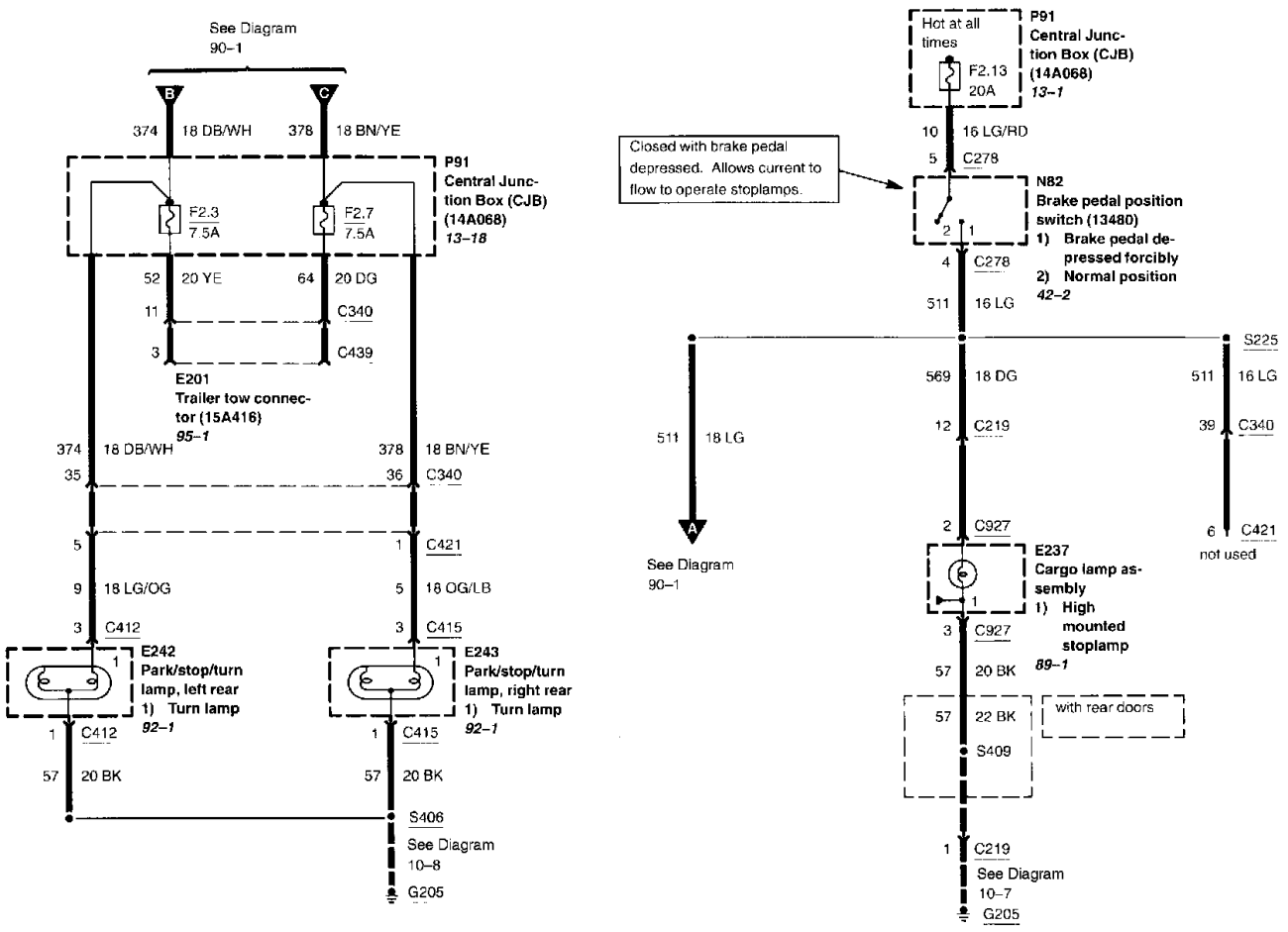

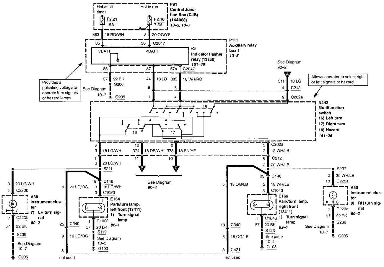

For Curious Hound: I don't have a book unfortunately. The best I could find is a few pages online that I can't really guarantee are correct but it seems pretty accurate and I've used this website before for diagrams for other cars that have been accurate as well so it is a credible source. Here are the 2 pages I do have from there.

Also from the same website is this:

It says most of the system grounds at G205: "Vehicle floor, left front side". Has anyone every messed with this ground? Hopefully I don't need to pull carpet to check that one, or at least hopefully it isn't difficult to pull it. Thanks for the help and ideas so far, it seems like it's getting narrowed down to some sort of main ground or crimp issue.
Looking at the diagram that you posted, G205 does seem to be the biggest common denominator for a lighting problem, suspected grounding issue.

What you describe really sounds like a bad ground and voltage is back feeding through other light circuits to get to ground.
a cheap trick.
hook a long wire, with a 10 amp fuse in it, to the actual negative battery terminal.
take that wire to each socket/lamp and touch the ground side while the symptoms are present.

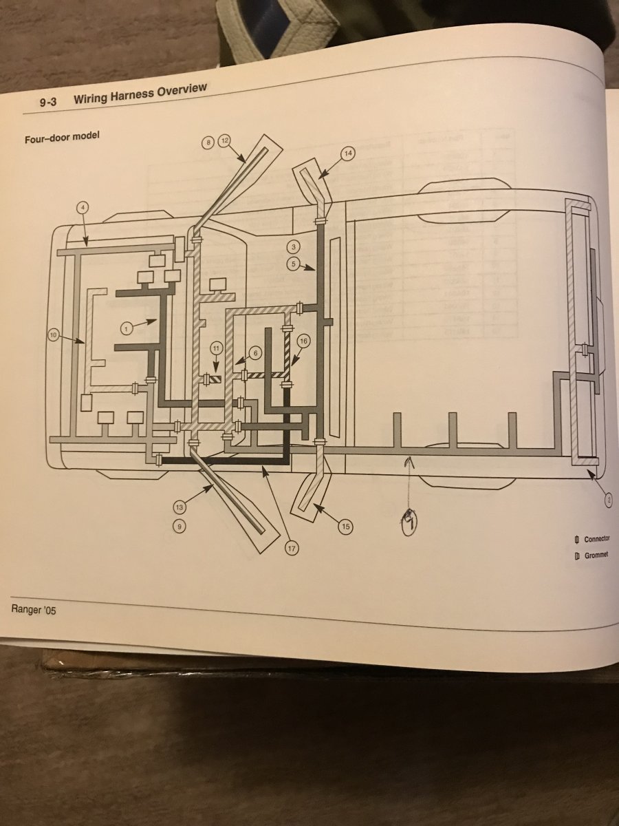

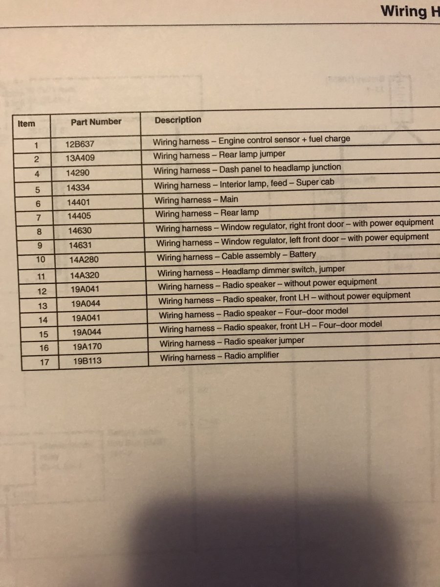

this is from a 2005 factory manual. maybe you can isolate some circuits.
this is a basic flow diagram, does not show exactly where the connectors are.
