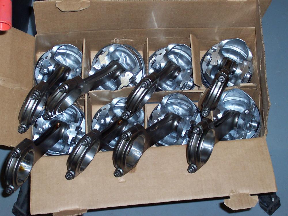

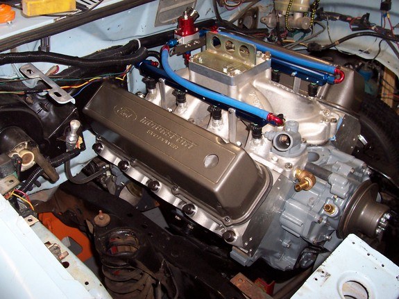

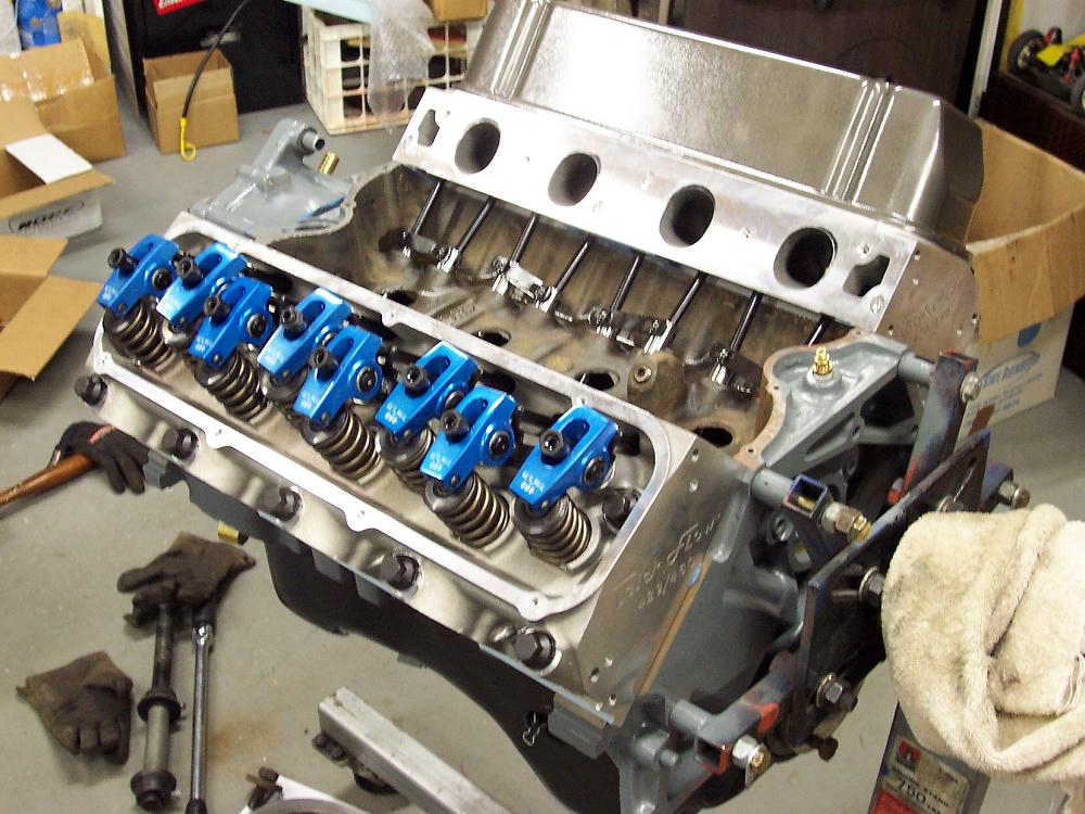

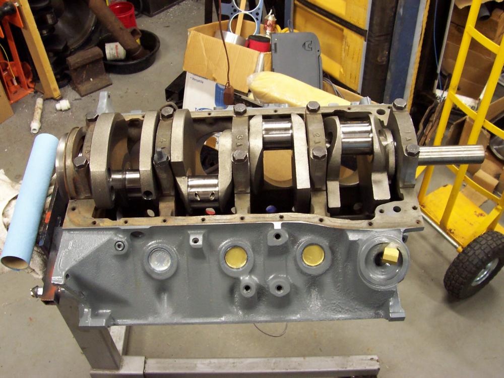

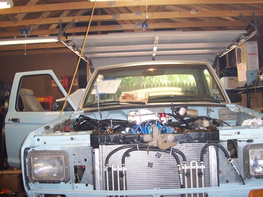

Although there have been a number of people to stuff a big block Ford in to a Ford Ranger, the first known person to do it at The Ranger Station was forum member BigBlockRanger. He stroked a Ford 460 V8 to 545 cubic inches, and then stuffed it in to his 1986 Ford Ranger.

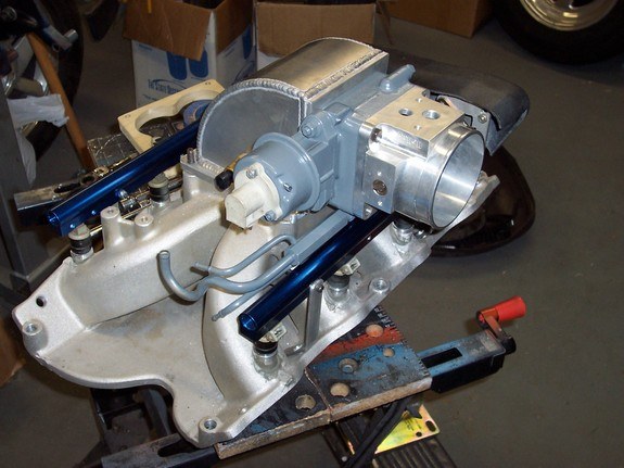

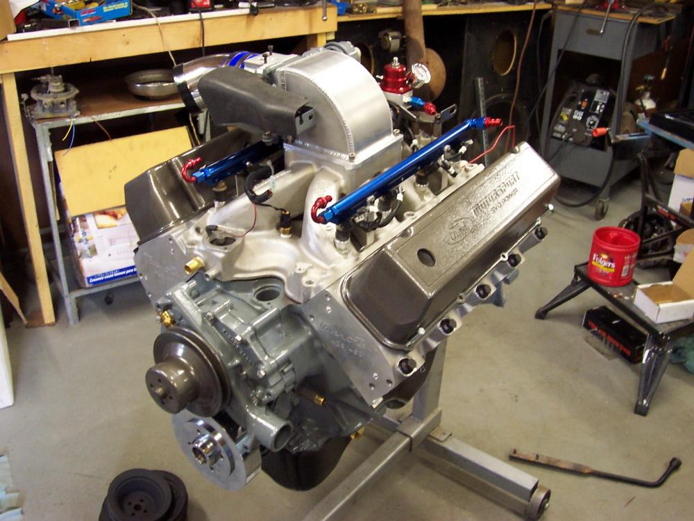

The engine was topped with a Victor intake manifold. The intake was modified for fuel injection by adding fuel injection bungs to the intake runners.

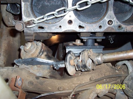

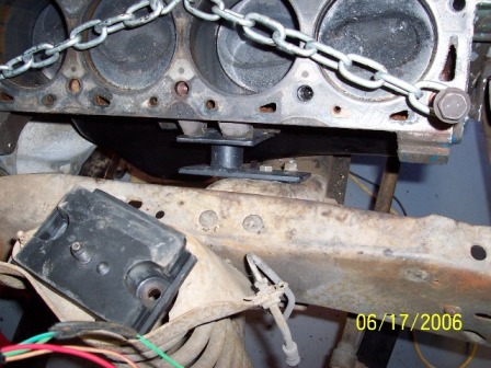

The engine is mounted on the drivers side using FRPP 460-to-Fox body pedestal mounts sitting on a 1-inch thick square tube. The passenger side FRPP mount bolts directly to the engine cradle. These mounts come with rubber isolators, but if used, they position the engine too high in the chassis.
