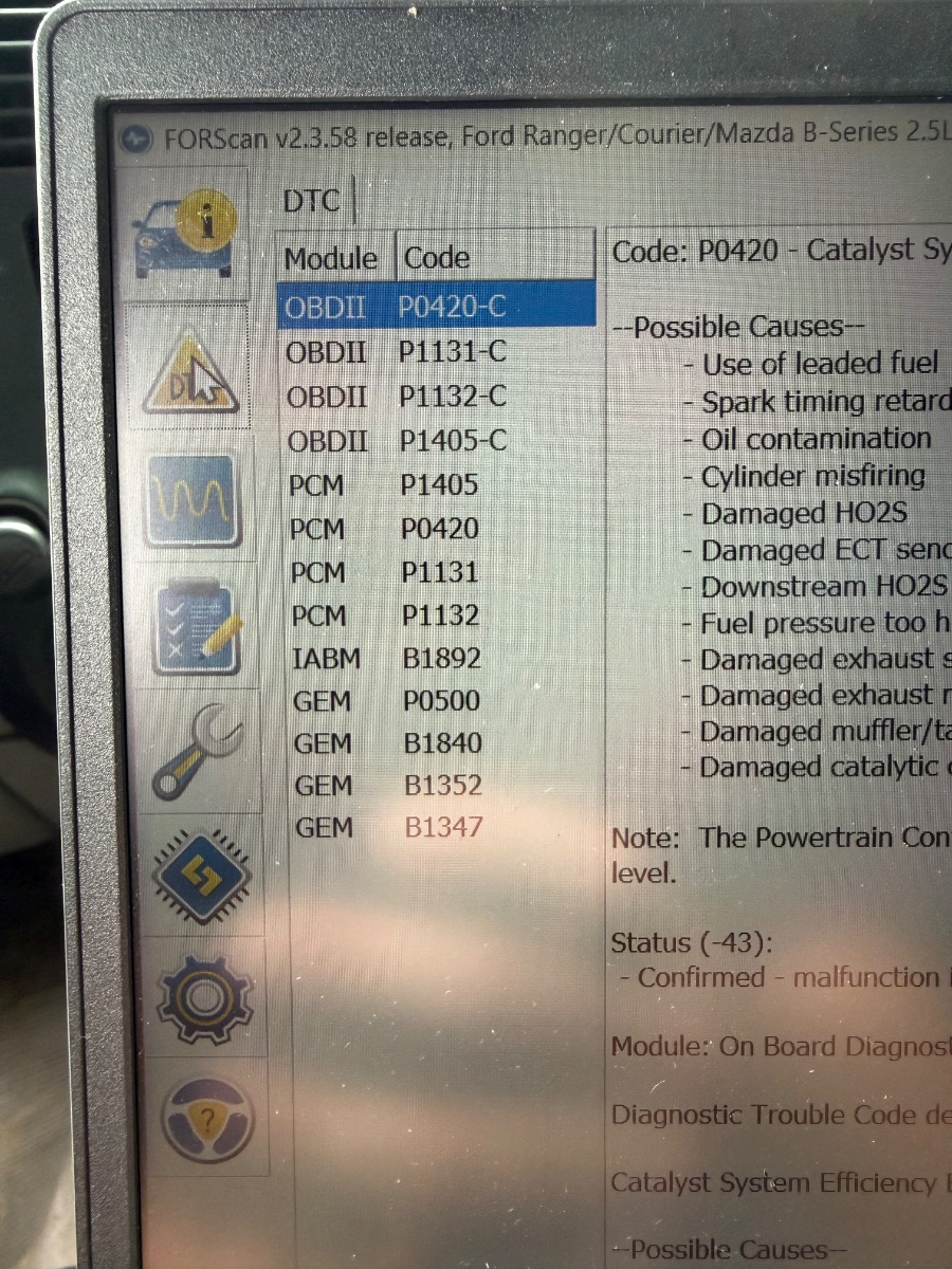

What O2 codes? That would definitely do something as it could be running rich or lean and would tell some of the story.
I’ve attached a pic of the codes. From what my scanner says it’s both rich and lean codes, an issue with the high side DPFE sensor hose.

It’s acting like it’s dropping cylinders or getting weak spark is the best way I have to describe it. I pulled a couple plugs and they still looked good, I have new wires on the way for it. The sensor hose issue was easily resolved. It just came off the fitting.
