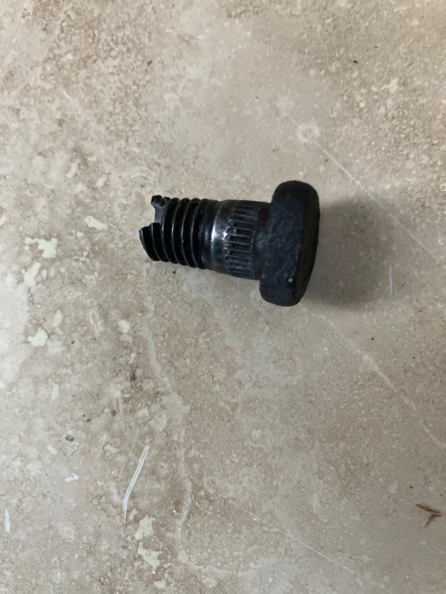

Hello, I’m new, idk if this is the right place to post this, but I’m seriously at a loss for how to find the spindle mounting studs for mid 90s rangers, I’ve searched everywhere and nothing matched the ones I have, if anyone could give some insight on where to get 5 of these I would really appreciate it, I’v been stuck on this for over a week for my ranger
Broken stud pic included, this is about half of it

why cant you replace it with a nut and bolt with lock washers?
Because this has, knurling on the shoulder that bites into the metal, and all the ones I found so far either have a too big shoulder or are 7/16”, which mine is 3/8”
I’ve come across metric ones as well.
I’ve actually knocked good ones out of a junkyard truck and used those when I’ve had a bad one. There was some discussion somewhere on here awhile back about it. I don’t have time to go looking though.
No room on the backside to work a wrench or socket around them with the pesky axle shaft in the way, they have to be studs

II wonder if the Dana 44 studs work? 🤔
