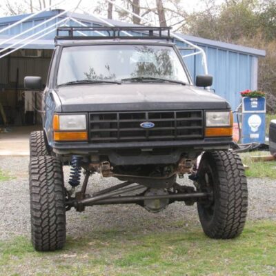

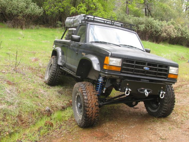

Overlanding (adventure travel) has been gaining popularity, but it has been around for a while. In 2012, forum member ‘Flexfab’ turned his 1992 Ford Ranger in to an ‘Expedition Truck’.
According to Flexfab:

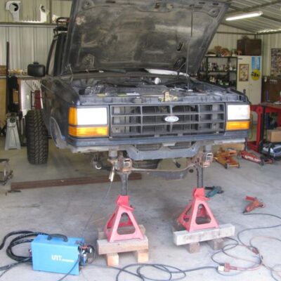

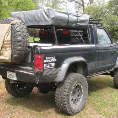

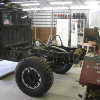

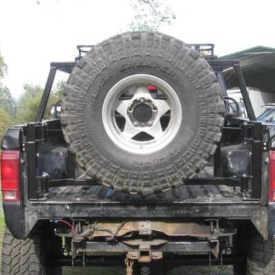

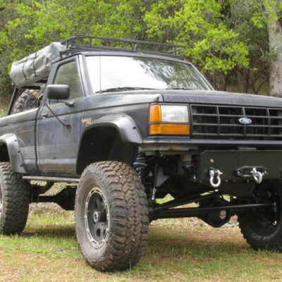

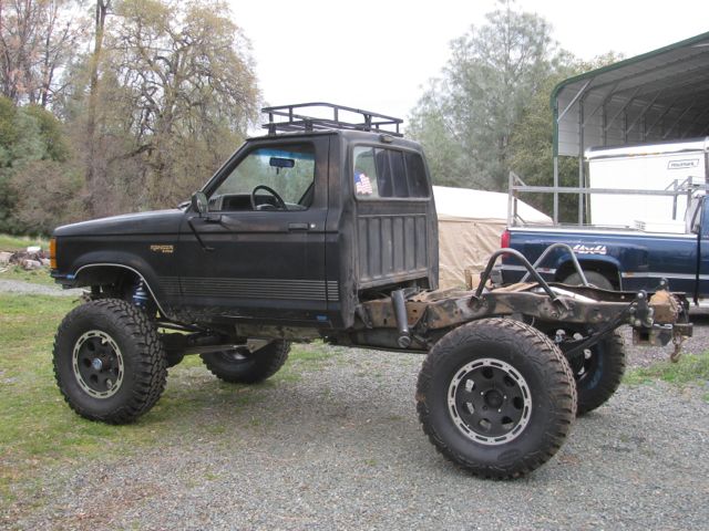

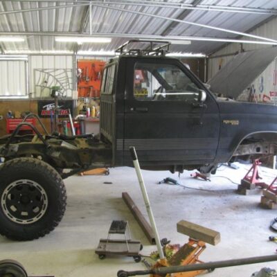

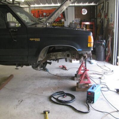

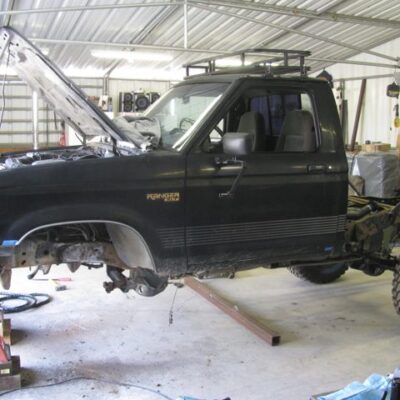

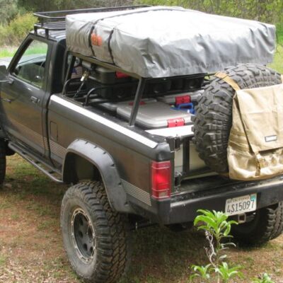

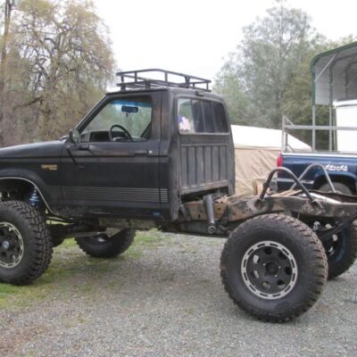

I bought this truck new in 1992 and promptly took it to Baja for 3 months. The truck has been nothing but “Old Faithful”, TTB and all. After wallowing around North America with the worst bump-steer ever engineered into a vehicle, it was time to turn it into a proper camping rig. Just thought I’d share a few of the build shots and some poser finish shots.
1992 Ford Ranger overlanding rig

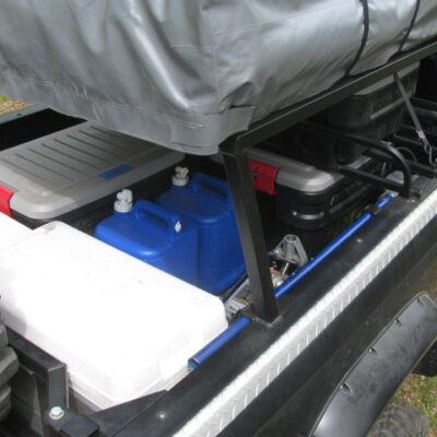

1992 Ford Ranger overlanding truck bed

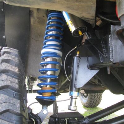

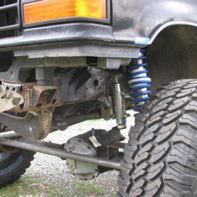

coil over shock
coil over shock and bump stop

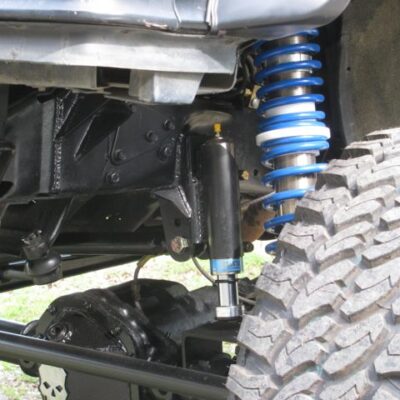

Ford Ranger remote reservoir

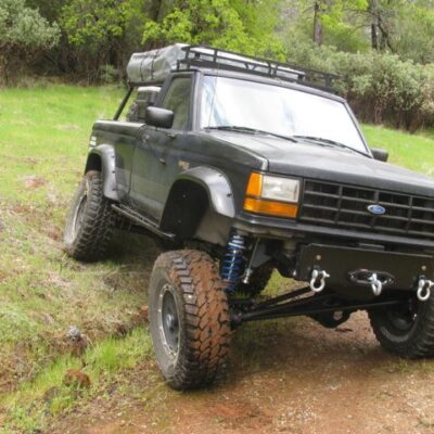

Quick List of Modifications:
  • 35 x 17 Pro Comp Extreme MTs
  • 1979 full-size Bronco Dana 44 front axle
  • 4.56 gears and an ARB

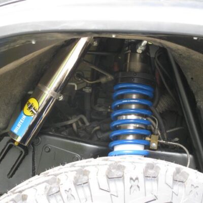

  • Bilstein 2.5 x 12 coil-overs
  • Bilstein air bumps
  • 5.0 Atlas transfer case
  • 1992 F-150 8.8-inch rear axle
  • 4.56 gears and a Detroit Locker

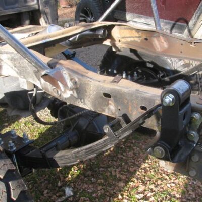

  • All Pro Baja leaf rear springs
  • Bilstein 5150 rear shocks
  • 3″ Deaver shackles with flipped brackets
  • 15 gal extra fuel cell
  • 12,000 lb. winch
  • 160 amp alternator
  • Bushwacker cut out flares
  • Tepui Kukenam roof top tent
