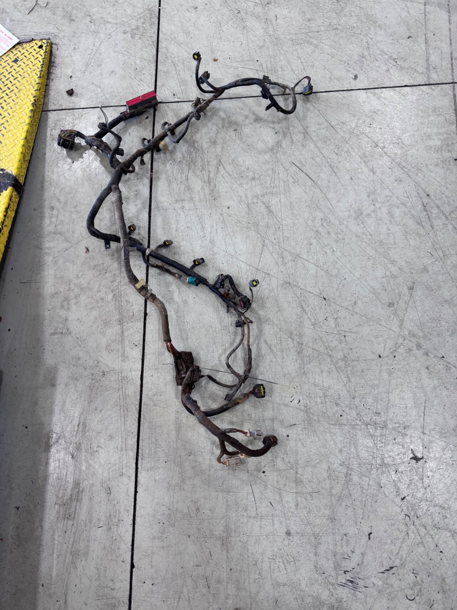

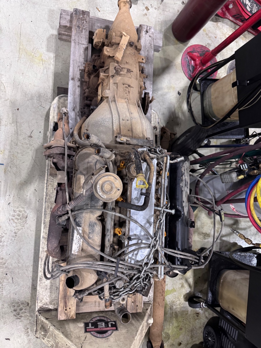

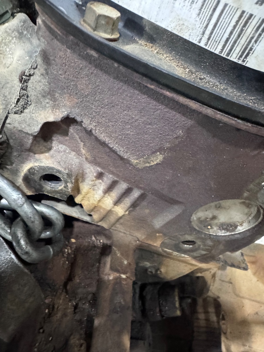

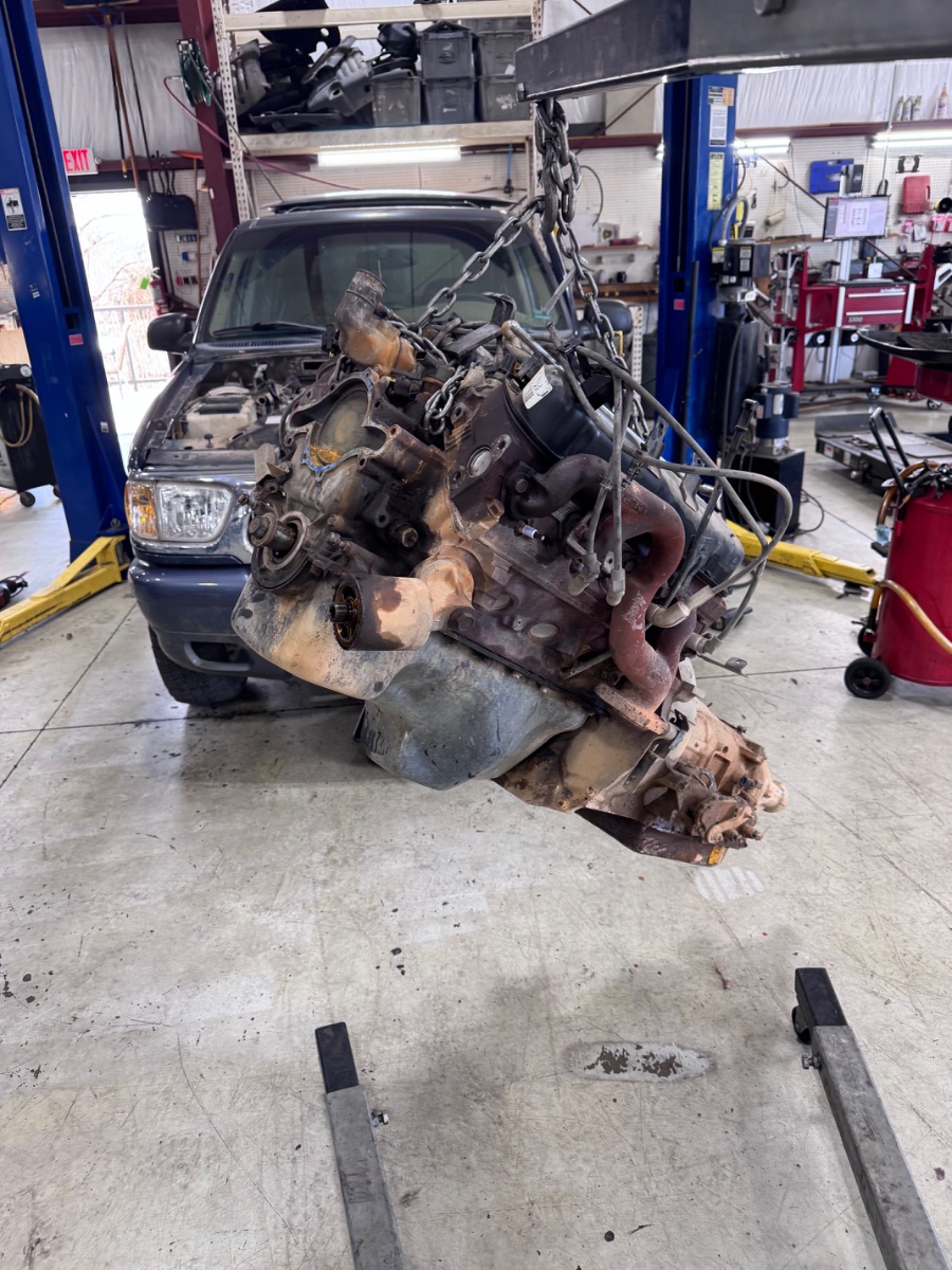

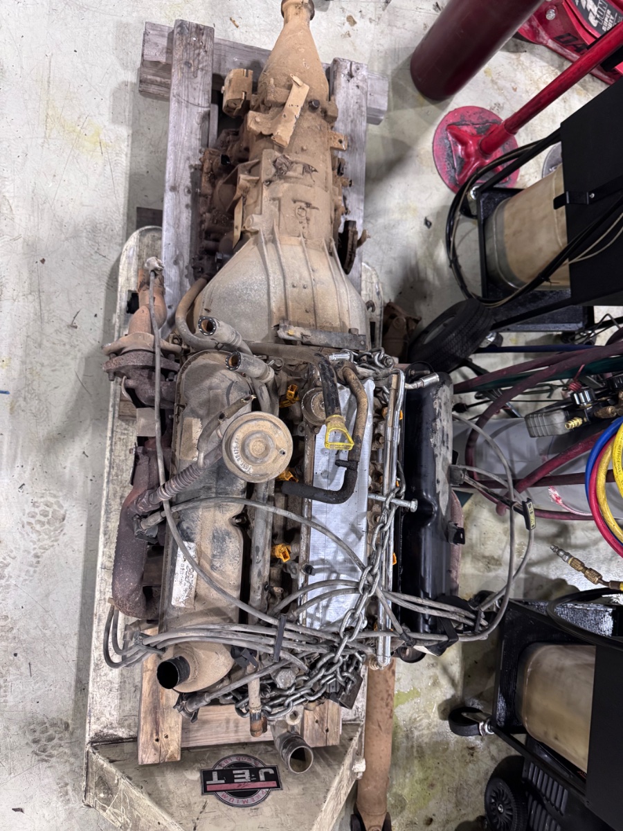

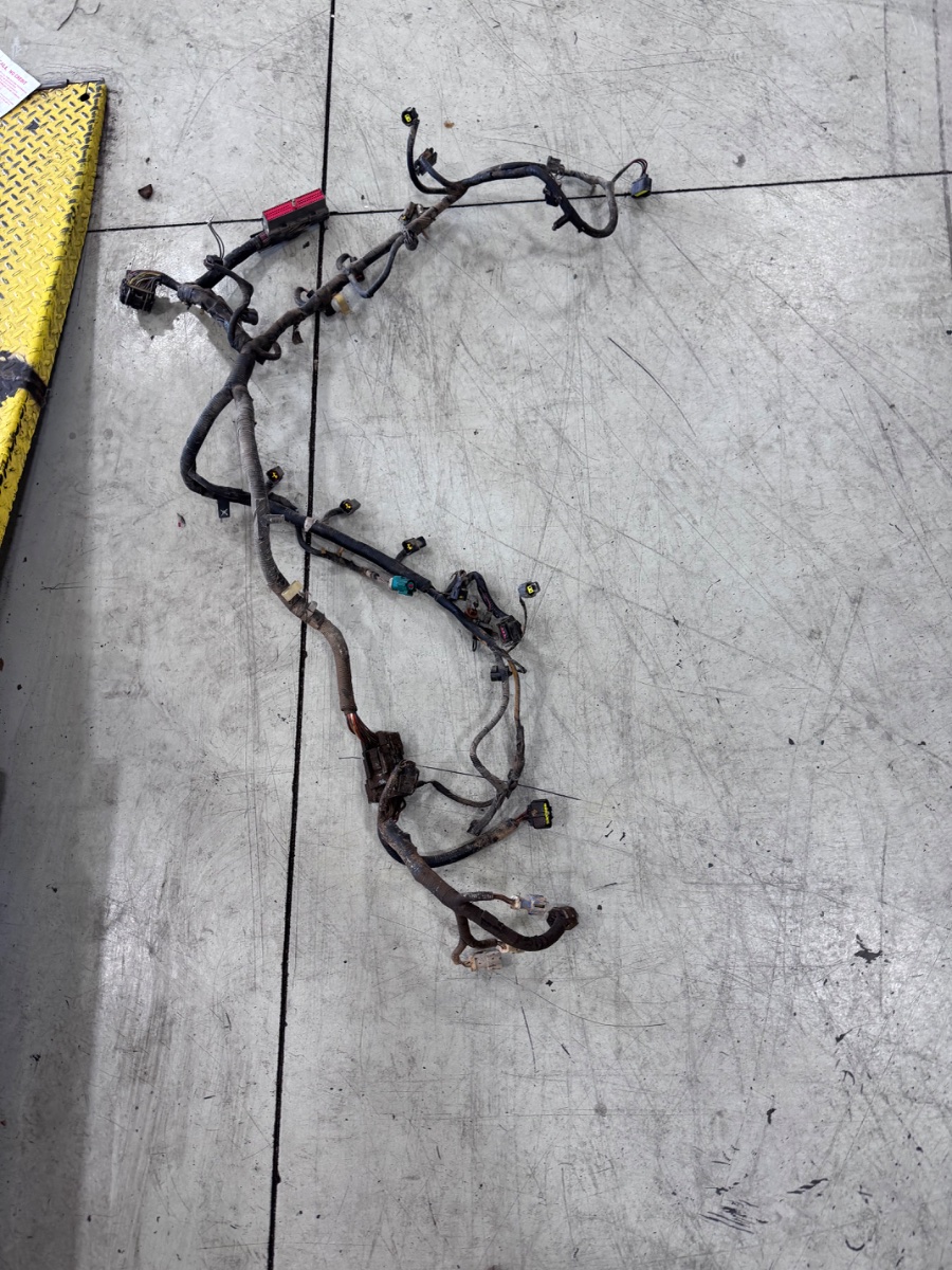

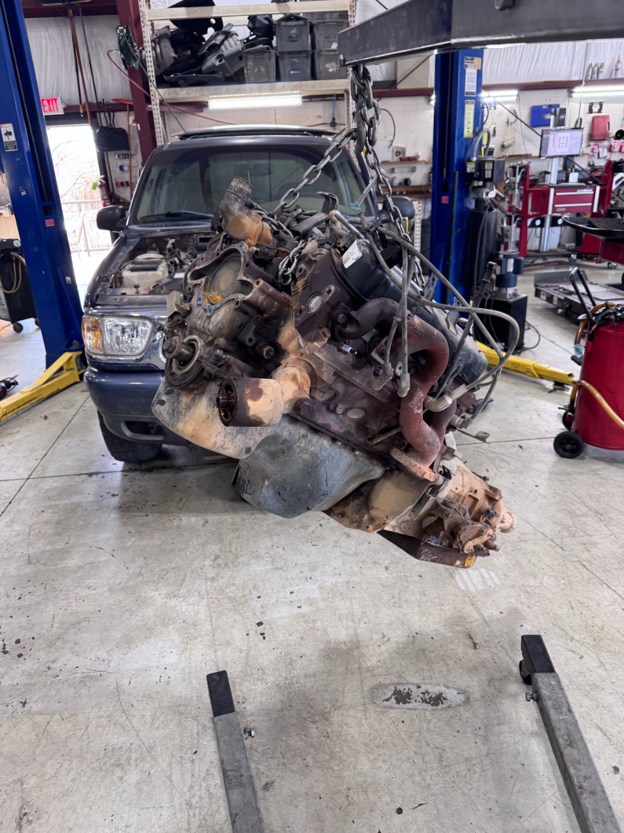

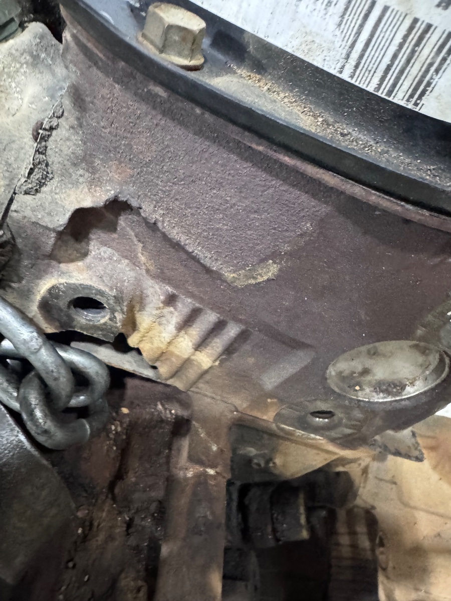

Finally had time to pull the engine and transmission from the Mercury. It does have the gt40p heads, which I am happy about. Going to get the engine separated from the transmission tomorrow. The transmission fluid was really good. I pulled the pan and no chunks in the pan. Next I have to tow the truck to the shop to swap the rear differentials and then pull the Mercury to the house to sit.
