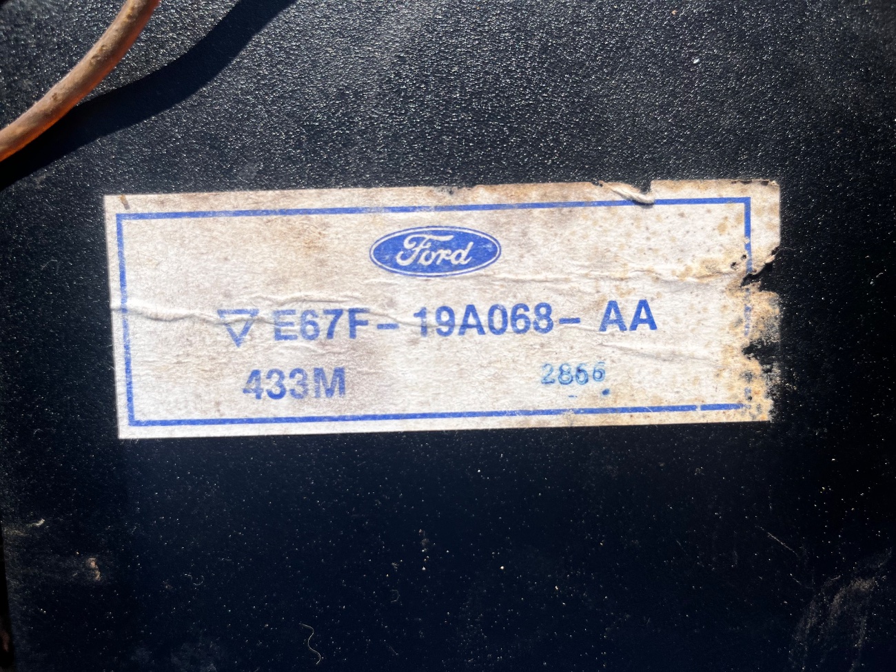

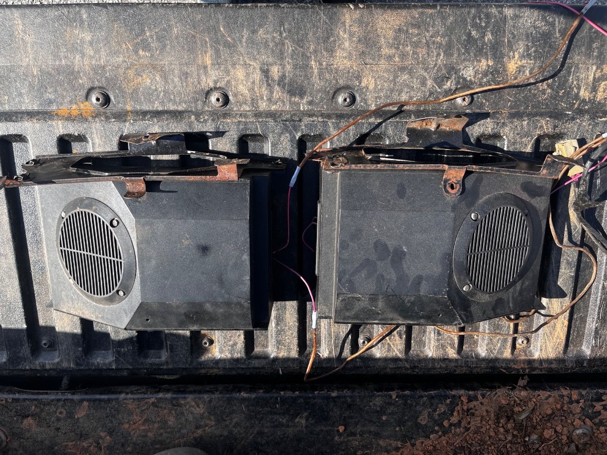

Pulled these out of an ‘85
Was this a factory option or dealership install? I’ve never seen them before.
I’m tempted to yank the speaker out and swapping in something more modern, but keep the OEM box for looks.

Factory option.
I've seen similar boxes in lots of Fords in the junkyards. Getting less likely these days just cause of age.
Factory option. More common on the late first gens and second gens. I've salvaged a couple looking to add rear speakers to my '85 when I rebuild it and wanting to keep it looking stockish. I can tell you that they, like.many old oem speakers, are an odd all size. Don't expect to buy off the shelf speakers that bolt right in and look right. Either they are too small diameter or too large diameter. I'm opting for trying the smaller size, mounting inside the box, and keeping the original grills.
Speakers mount from the inside, so you have to be careful working the back of the box off. It's glued on pretty good

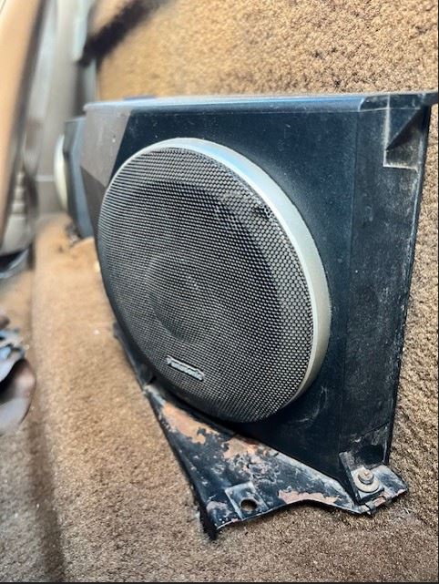

These are the rear speakers in my 88 Regular cab XLT. The box looks like it is the same as the others in this thread, I am wondering of these Panasonic speakers are aftermarket, since they are mounted from the outside. I'm thinking about upgrading the sound system, and would like to use the same boxes, I'm just trying to figure out what is there first before yanking everything.

Someone modified the boxes to fit those speakers. I did the same to mine.

That's helpful, thankyou. The front two speakers don't seem to be working correctly, either both are blown, or there is a wiring problem somewhere down the line. The front speakers are also Panasonics, so I guess the whole system was upgraded at some point. Hoping that if I just replace the speakers everything will work properly without having to rewire the whole thing
