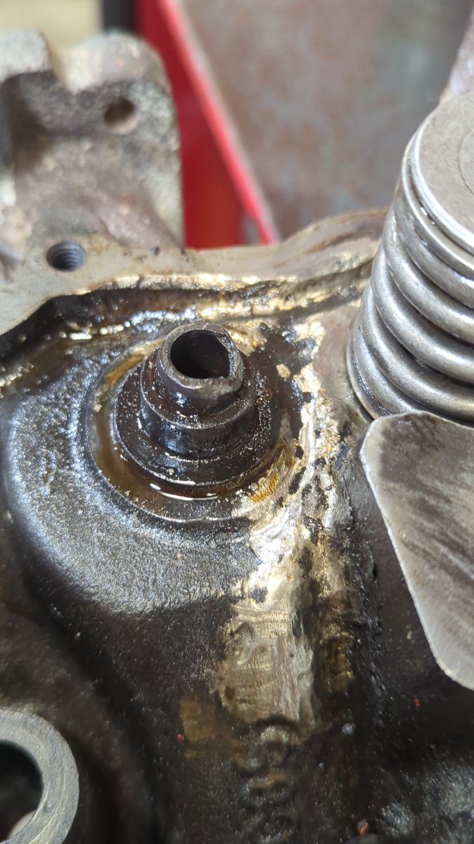

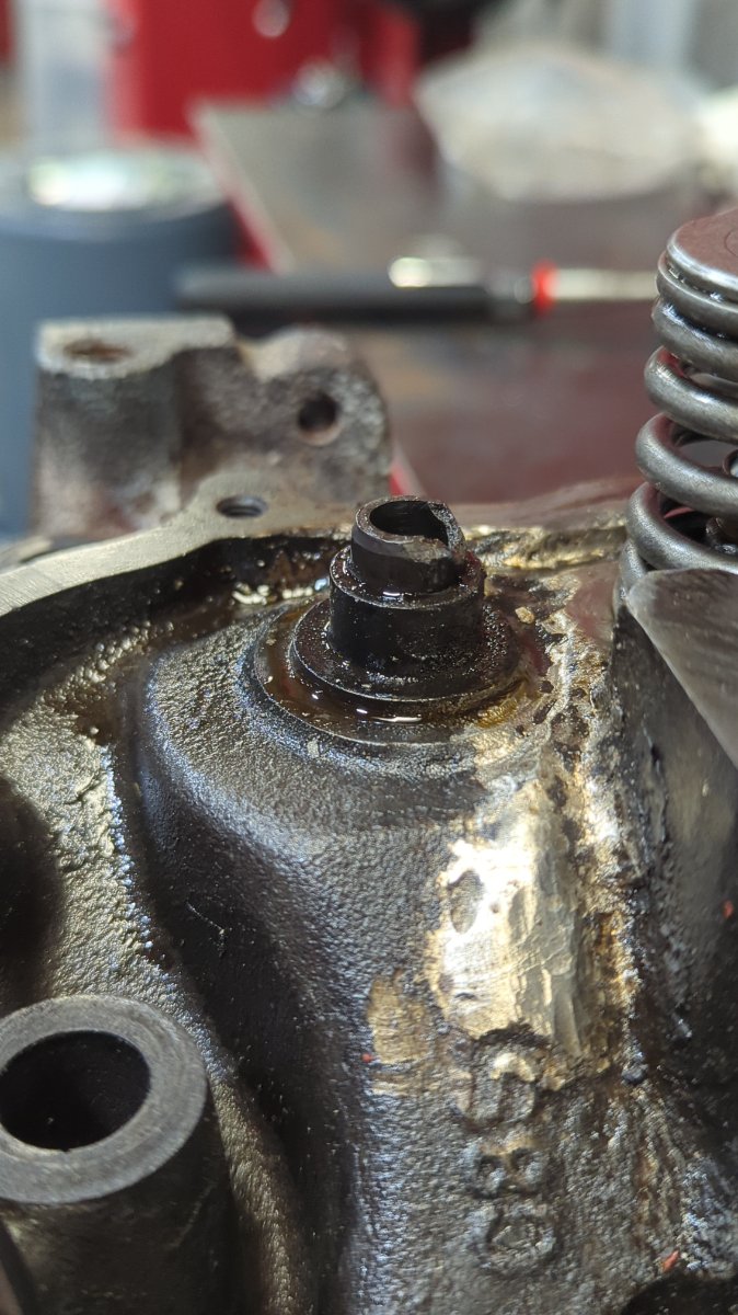

But you see that is the thing, it overheats very quickly, it already is a problem lol. The coolant is running into the oil and when i had the engine apart i noticed someone welded one of the heads and i dropped a head aswell when the valve spring hit me in the face, concrete floor. Whoever did that original "fix" didn't fix it at all.

Well for starters, I haven't been able to drive it enough since i got it to see how much oil it uses. I just had the motor out and entirely apart. I dont recall if the coolant was rusty before i believe it was all in the oil like it is now, you can see it on the dipstick and my oil level is about twice what it should be. Also the leaks i dont see any just a little seepage at the drain plug.
Someone had the truck before me and they did some rank stuff to it, truck is real clean but has a salvage title for some reason, one of the valve guides has been jacked by a doofus who got hold of a grinder lol not sure what he was thinking, another fella tried welding one of the heads but i dont think he did a good job and i think thats why he ditched it. Here are some pics of the evidence i found.
