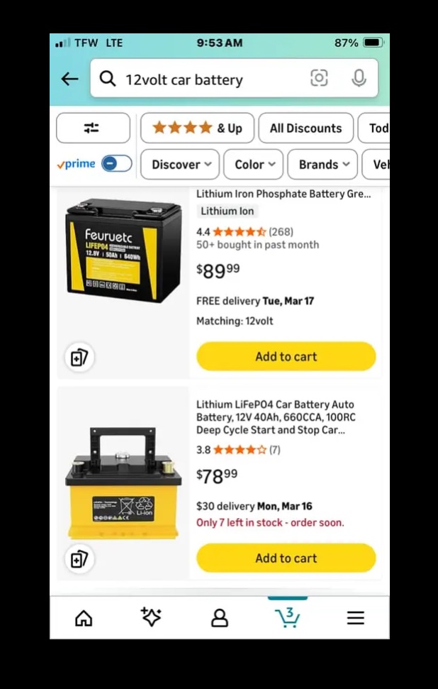

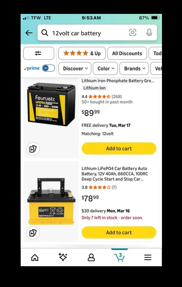

i vanlife and charge a lot of my stuff off my lead acid battery and killed another one after only three years. i was suggested replacing with a lithium ion battery, as they are now cheaper than lead acid.
the only caveat is that they require a Battery Management System. are the LiO batteries with the bms cheaper?

I don't want to sound negative but I would be very careful with batteries like that for a few reasons. I don't think automotive lithium tech has advanced far enough that a safe lithium car battery will be cheaper than lead acid.
I helped a friend spec out a marine system and I found troubling inconsistencies between sales brochures and data sheets. The battery my friend wanted to use bragged about having a "built in BMS for safety" but when you dug through the tech specs it required an (expensive) external regulator to protect the battery. When he contacted their sales they said "no, the alternator regulator isn't enough, it needs very stable power for charging". And this wasn't cheap Amazon stuff, it was quality marine -grade gear.
Just be really certain of what you're buying and I'd say resist the temptation to go too low on price with lithium - there's just too much dangerous junk out there IMHO. If you need durability that's definitely compatible with vehicle 12v systems, consider an AGM or deep cycle battery depending on your exact use case. Yeah, they're not super cheap but they'll survive deep discharges much better than normal starter batteries.

I'm afraid I left room in my comment for misinterpretation - sorry about that. I never meant to imply that LiFePO4 batteries aren't safe. What I was trying to say what that given current cell prices and the cost of a proper BMS to charge a pack that can supply 500+ amps, it's not possible to build a proper LiFePO4 car battery for the $85 as shown in that Amazon screenshot. I was trying to say that at $85, you really have no idea what's in that yellow box, and _that_ would be my concern - not LiFePO4 batteries in general.
If you know of a high quality, safe LiFePO4 car battery I can get for $85, please let me know, I'll buy 100 of them today. 😉

I believe most (if not all) commercially-made LiFePO4 batteries sold for 12V use have a BMS already built into them (some also have internal heaters the BMS will activate if it's too cold). I've seen them for around $180-250 for non-heated 100Ah units, maybe $50-70 or so additional for self-heated ones.
LiFePO4 appears to have reached similar $/Wh as AGM lead-acid... It's certainly to a point where it can be a practical consideration for an average budget on a camping / overland / RV rig aux battery.
