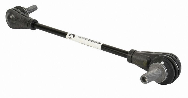

The factory front sway bar link in the 2019-2023 Ford Ranger is not very durable. In our 2025 Colorado Adventure, one of our guys had one break driving across California Pass (Cinnamon Pass – Alpine Loop).
Stock Ford Sway Bar Link
Here’s the factory sway bar link:
2019-2023 Ford Ranger Stock Sway Bar Link

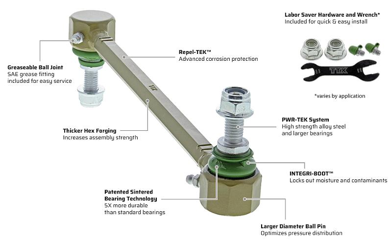

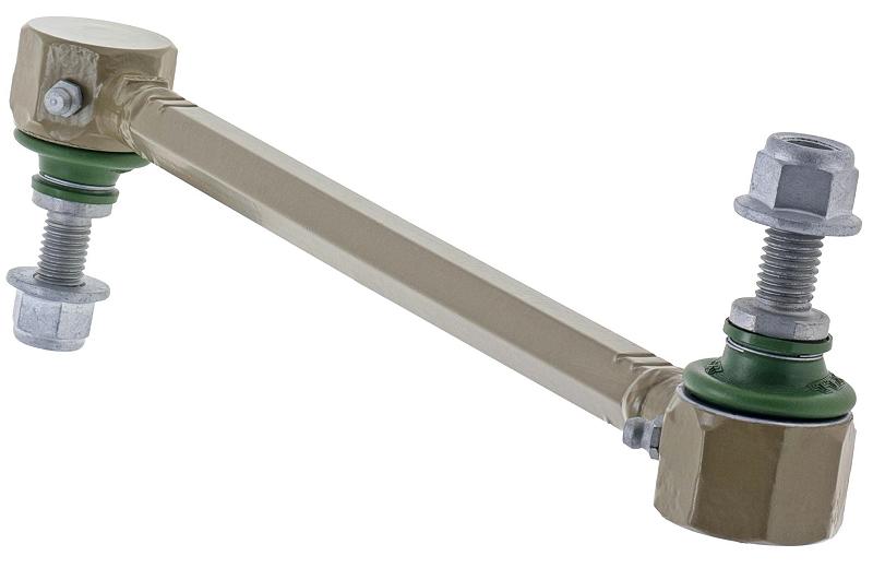

MEVOTECH TXK80252 Replacement / Upgrade
MEVOTECH offer a heavy-duty replacement under Part TXK80252.
Engineered for extreme conditions, TTX stabilizer bar links deliver top-tier performance. With Repek TEK corrosion-resistant coating, high strength steel, thicker hex forging, and advanced ball joint technology, they offer maximum durability, minimal maintenance, and all-weather dependability.
Sintered Metal Strength – Get longer life and durability with patented self-lubricating greaseable sintered bearings engineered to excel under high heat and heavy loads.
Greaseable Ball Joint – SAE grease fitting included for easy service.
Keep Water and Debris Out – Patented multi-lip boot mechanically locks into housing to seal grease in and keep contaminants out.
More Material – Thicker hex forging and larger diameter ball pins provide additional rigidity for extended part life.
MEVOTECH TXK80252 Replacement / Upgrade Sway Bar Link
MEVOTECH TXK80252

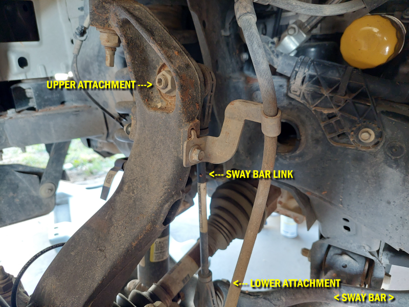

  2. Locate the sway bar link. The front sway bar link connects the sway bar (stabilizer bar) to the lower control arm or strut end (depending on trim). You’ll see a link with ball-joint ends and mounting hardware at both top and bottom.

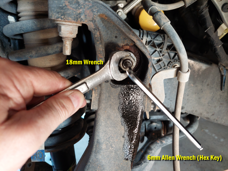

  4. Hold the stud with the 6 mm Allen wrench. On most Ranger sway bar links the stud has an internal hex (6 mm). Insert the 6 mm Allen into the stud to prevent the stud from spinning.
  5. Loosen the nut with the 18 mm wrench. While holding the stud with the Allen, use the 18 mm wrench to break the nut loose. If very tight, use a breaker bar or short extension on the wrench, but do not round the nut.
