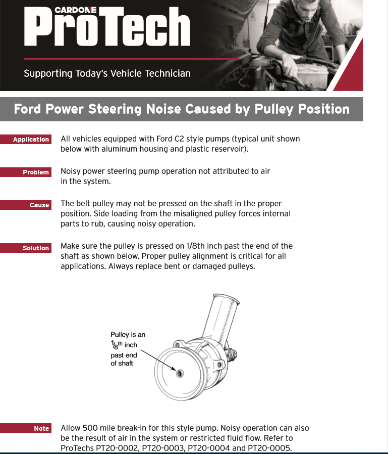

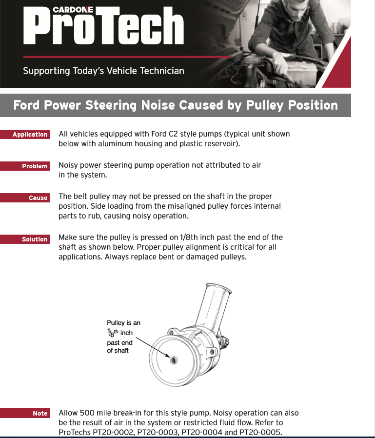

Go by this attachment & it should take care of the whine. It did for me.
This is when installing a new/reman. pump. You can try to correct it with your current pump but
it may be too far gone.
  • Type F or is there a better PS fluid?
