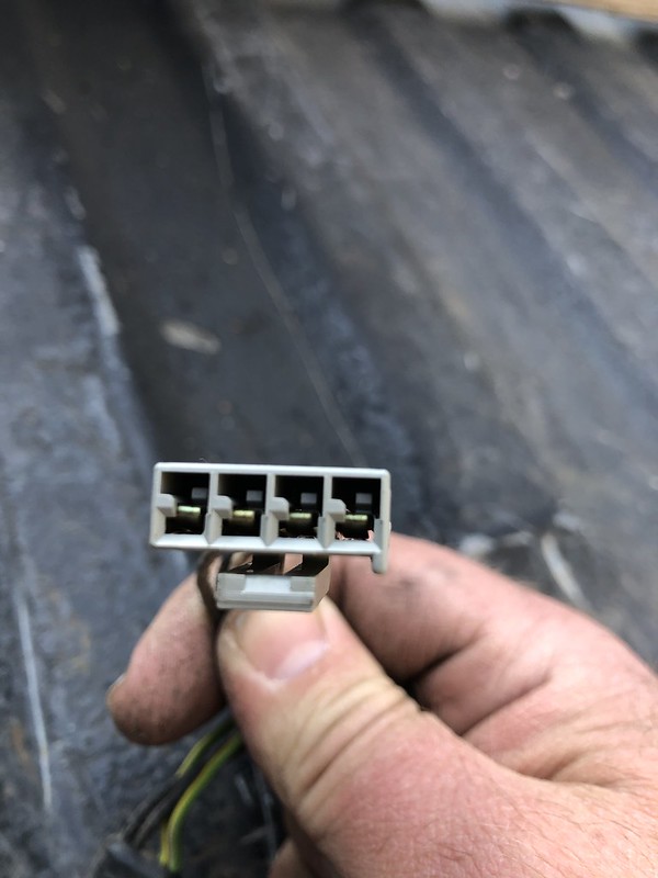

would anyone happen to have the wiring diagram for the overhead flip down map light with clock and date that came in the 1984 b2? I've checked Mitchell pro demand and all it has is the normal dome light. I know I could likely disassemble it and figure it out but I'd rather not chance it and cook the unit. it will be finding it's way into my ranger once the cab is installed, in place of the second gen explorer unit currently there.

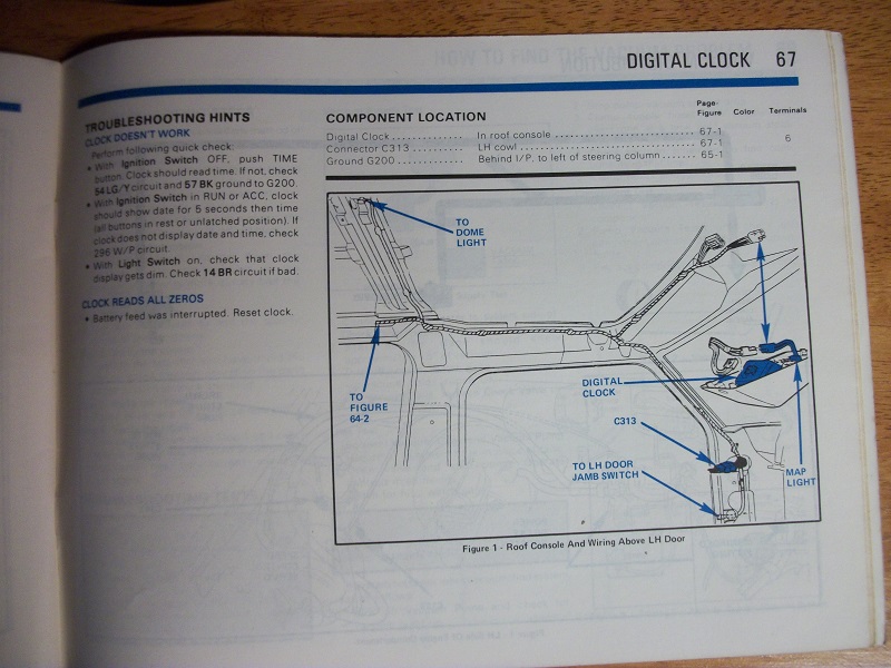

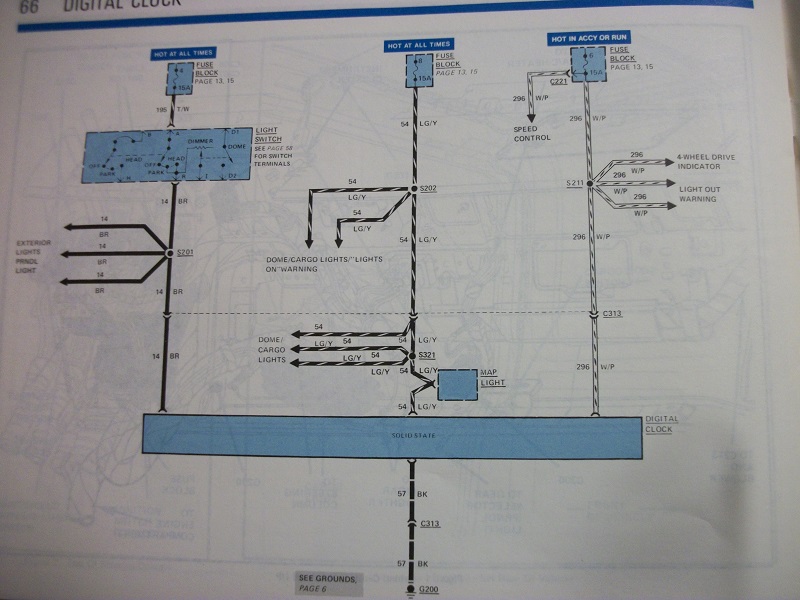

These are from the '84 B2 EVTM. I'm sure that you know already that you'll need to run wires, so I included the troubleshooting and location drawing page too. The Ranger EVTM is identical; C313 would be the sweet spot for your connection points, if you can get to it.

Thank you very much, that'll do it

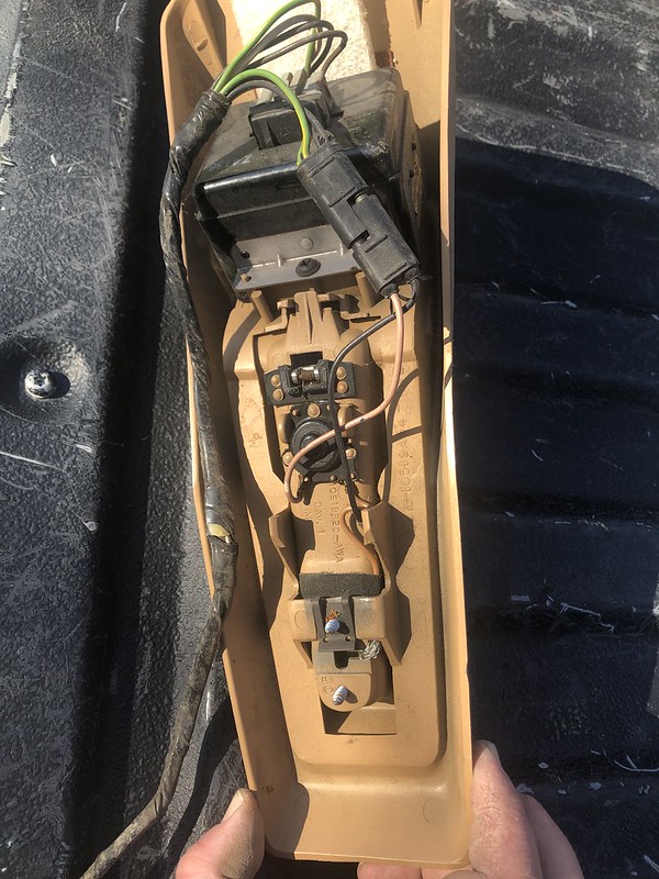

There really isn't much to the little guy

I figured there wasn't much to it, just didn’t want to play guess and smoke a 42 year old part. I have the b2 bracket, but I'll make it work in a single cab without much issue. Wish the one I have was red but I've got paint that matches perfectly.
