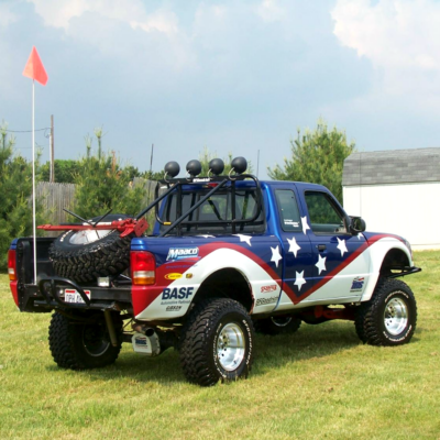

The body was in great shape with a rust free body and frame. The front fenders were removed and replaced with Fiberwerx fiberglass fenders. The bed was flared out to match. The truck was then sent to Maaco in Columbus Ohio for paint. The body shop was being overseen by TRS member Randy Miller.
Once the truck was back from the body shop, I made the white vinyl stars, hood logo, and some of the sponsor logos.

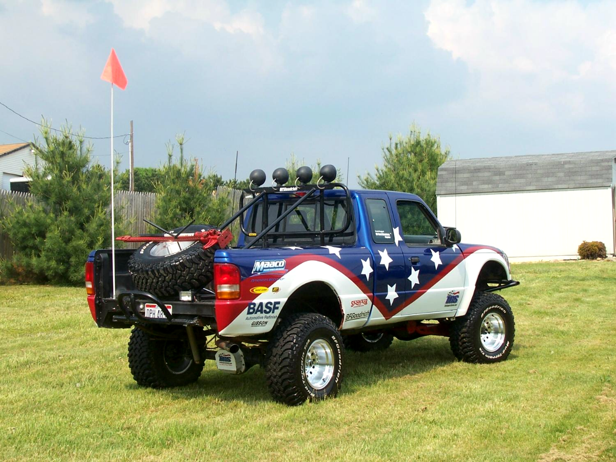

Bumpers and Bed Cage:
The bumpers and bed cage were all cut and bent by me. Everything was welded up by my friend Bob ‘Ozzy’ Osborn.

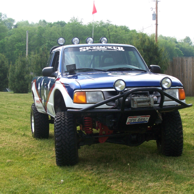

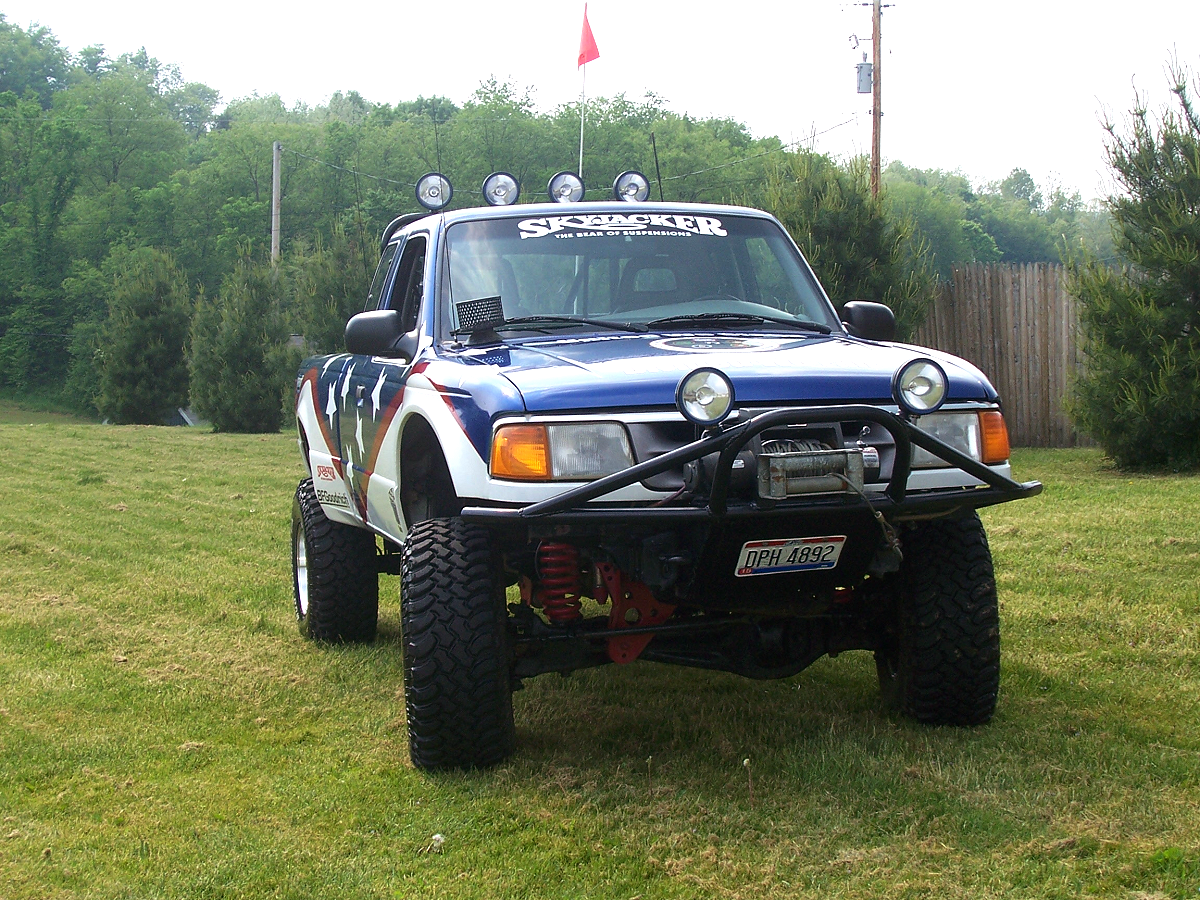

The front and rear bumpers were made from 1-3/4″ DOM tubing. The front bumper also uses 1/4″ steel plate for a skid plate and winch mount. The bed cage is made out of 1-1/2″ DOM tubing.
The bed cage holds (4) ProComp 100-watt lights and a 55-watt rear facing work light. The bed cage also houses a large plastic bed box, dual battery boxes, and a tire carrier. The plastic bed box houses a fuse block and relays for the lights.
The front bumper holds (2) Pro Comp 100 Watt lights and was originally equipped with a Mile Marker E12000 winch. However….a spotter let the cable spool up to much on end of the the drum and it broke the supports. The winch was replaced with a Warn XD900i.
1-3/4″ DOM front bumper with 1/4″ steel plate.
1-1/2″ DOM bed cage with mounts for spare tire, battery boxes and bed box.
(Flag was for entering the Badlands at Attica, Indiana)

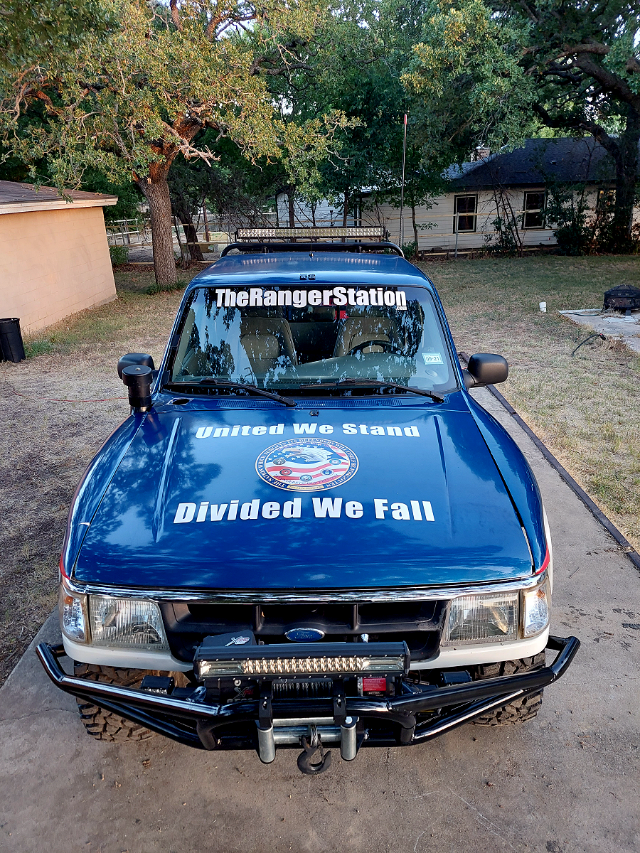

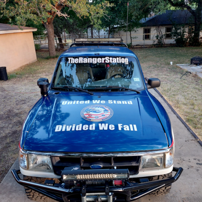

Here’s a look at the decal on the hood.
There is a logo for each of the armed services with a POW/MIA decal in the center.

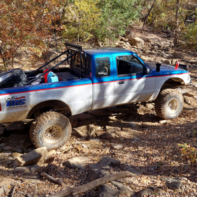

The Ranger performs great! The truck will go anywhere that it can get ground clearance. My wife and I enjoy sitting back and watching others fail or struggle to climb and obstacle, and then go right up when its our turn.

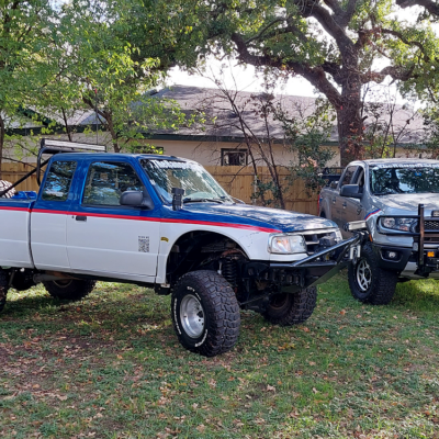

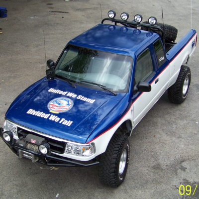

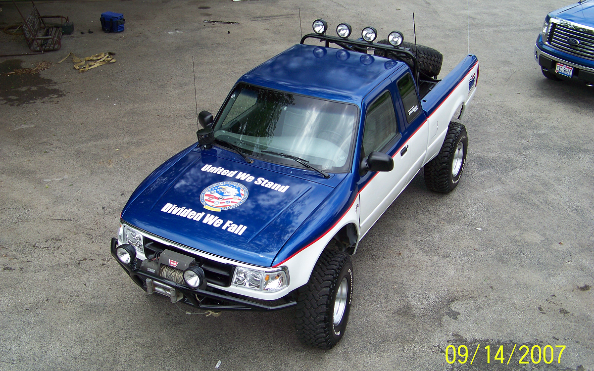

The Ranger took quite a beating and was beginning to rust. In 2010 the Ranger was repainted more in the tradition TRS color scheme, but the military tribute was retained. Some of the damage on the truck was severe, and although it looks good at a short distance, a close up inspection will reveal that I didn’t bother to remove every small dent and ding in the truck. I couldn’t see going through that much work just to dent it up again.
Replaced the headlights with projector headlights and clear corners.
I replaced the chrome trim around the lights and above the grill to give it a new look.
