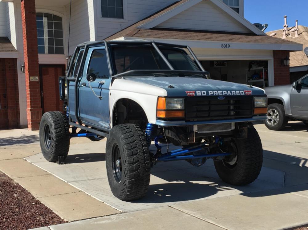

I loved the factory color and STX stripes of Grunizzle’s 1991 Ford Ranger 4×4. The combination of the factory colors and the blue James Duff suspension and black wheels makes for a nice looking 4×4.
But as you can tell from the lead photo, the truck didn’t stay like that long. The 1991 Ford Ranger has been constantly transforming in to hard core trail rig with every modification.

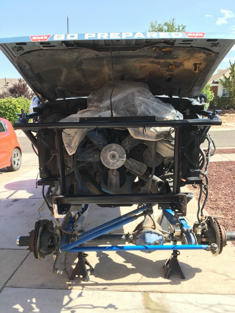

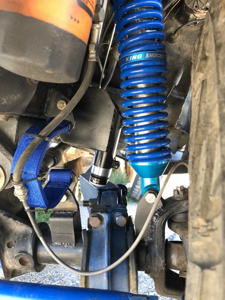

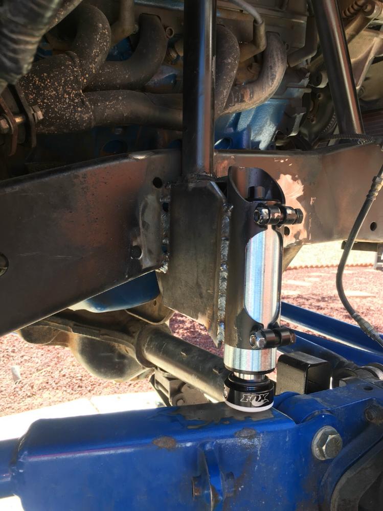

Suspension:
James Duff 78-79 Bronco radius arms
James Duff panhard bracket
King 2.0 14” travel coilover 200/200
Fox 2.0×2” bumpstop front
Knuckles and pitman arm reamed for Ruff Stuff steering kit
Custom triangulated 4 link setup
2”x.250 links
Ballistic Fab flex joints
King 2.5 16” travel coilovers 100/150
Fox 2.0×3” bumpstop rear
TK-1 racing sway bar
Axles:
Ford 9-Inch rear axle with 4.56 gears, Grizzly Locker, 35 spline moser chromoly axle shafts
Fullwidth Dana 44 front axle with Yukon chromoly shafts, Yukon hardcore locking hubs, 4.56 gears and Grizzly locker
Ruff Stuff diff cover

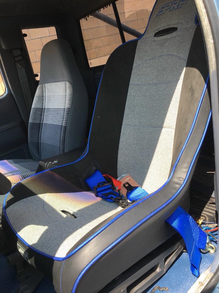

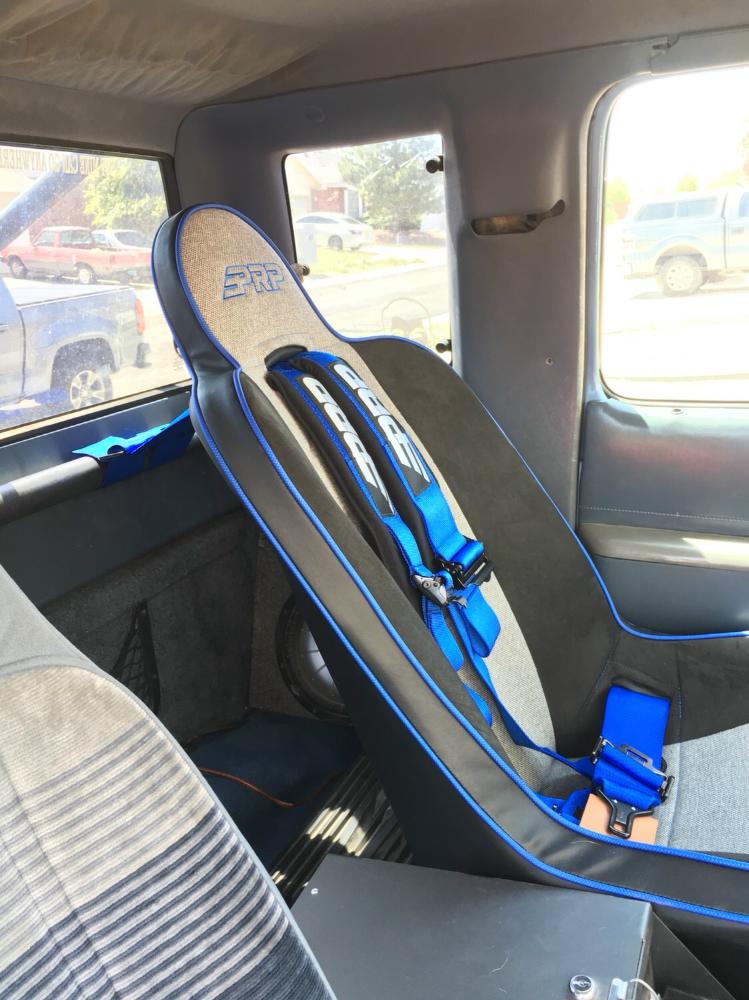

PRP premiere seat & 4 point harness

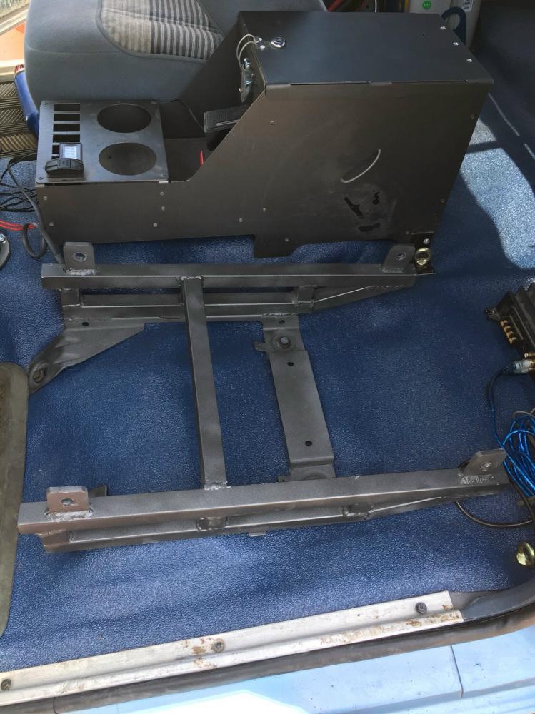

(custom console with B&M shifter)
