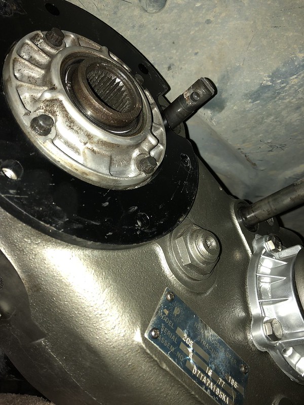

I have done basic parts like this way and it is pretty cheap. A 3/8" thick ring for my transfer case was $14 for machine time and material. (the black thing)

It would break from the torque, not a heat issue
And thats a metal ring not plastic

Yeah, it is 3/8" thick steel the local machine shop cut out with their laser table.
