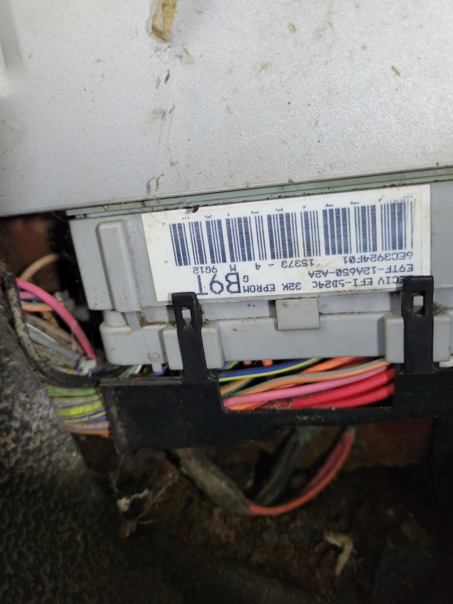

I bought a 1991 Ford Ranger std cab 4x4 5 speed. I got a code for 22 (MAP) however do not find a map sensor or plug in on harness. I do have the mount on cowl (where my parts truck has one) After doing some inspection, I noticed the ECU was E9TF. Truck was built 08/90. I believe I have the wrong ecu for the truck. Could anyone point me in the right direction?

I did a google search, it comes up with 5.0 computers but it also came up with a 1989 ranger. How many flashes or indications did you get when you first pulled the codes? That gives you a indication how many cylinders the computer is programmed for. 2 flashes, is a 4 cyl, 3 is a 6 cyl, and 4 is a 8 cyl.
Most all engines those years used a MAP sensor.

The 2.3L switched to MAF in mid '90 model year so roughly around '90 (my '90 had a MAP sensor but was built in '89), I think it's similar to when the 2.9L switched to MAF as well.
With an E9 it's probably the wrong ECM, you're likely going to want a '90-92 ECM for it to work right.
that is what I figured, not sure the differences besides the manual vs auto. figure look for f0 or f1 ecu

Those all look to be V6, price is reasonable...
