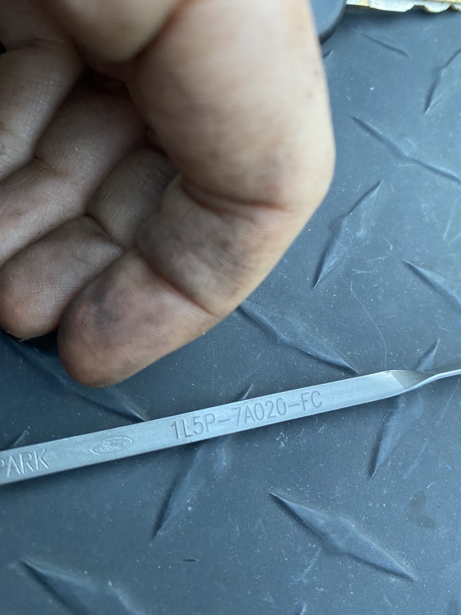

my door sticker is scratched off cant really read it... but i pulled the transmission dipstick and it has a part number on it. i googled the part number and it does come up with a 2002 ford ranger dipstick but it doesnt say what engine its for. now im confused.

well... 2 numbers different part number ("Z" not "P" and "FB" not "FC") is for a 2.3L with 5R44E mfg before 2/20/03 - dunno what they changed on that day...
looks like it was replaced by 3L5Z-7A020-BA
both of em say "oil" not engine oil or trans oil... but they are on the "internal parts - transmission external" diagram so they are tranny parts.

well now im extremely confused because from what im understanding i have the correct dipstick.... why the hell does it show overfull everytime i check it no matter how much fluid is in it. im checking it warm with the truck idling in park...
did you find the 5P....-FC somwwhere? cause I couldn't find it anywhere short of asking a buddy to dig out the microfish reader (parts counter guy)
