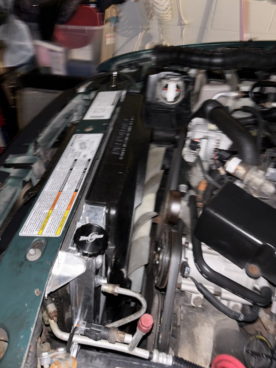

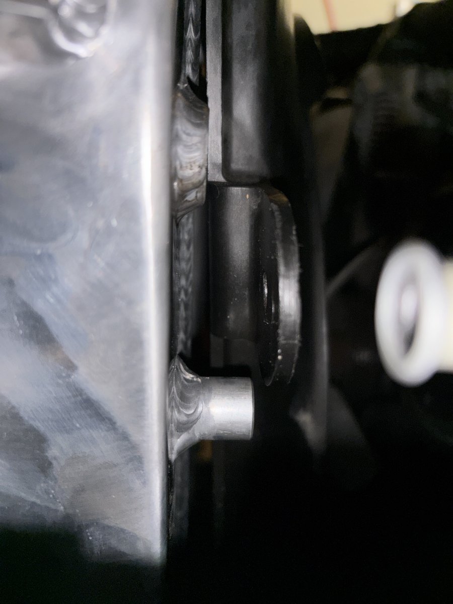

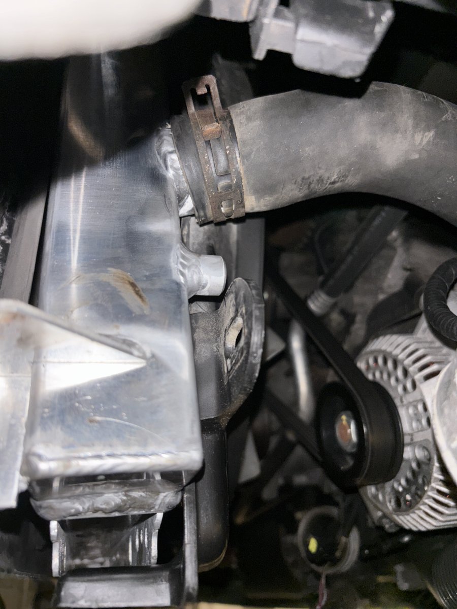

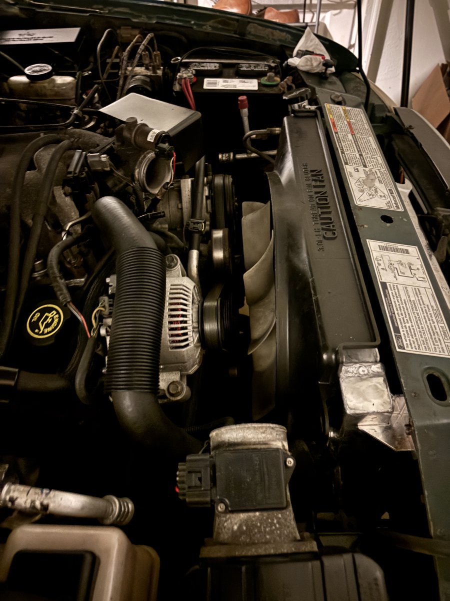

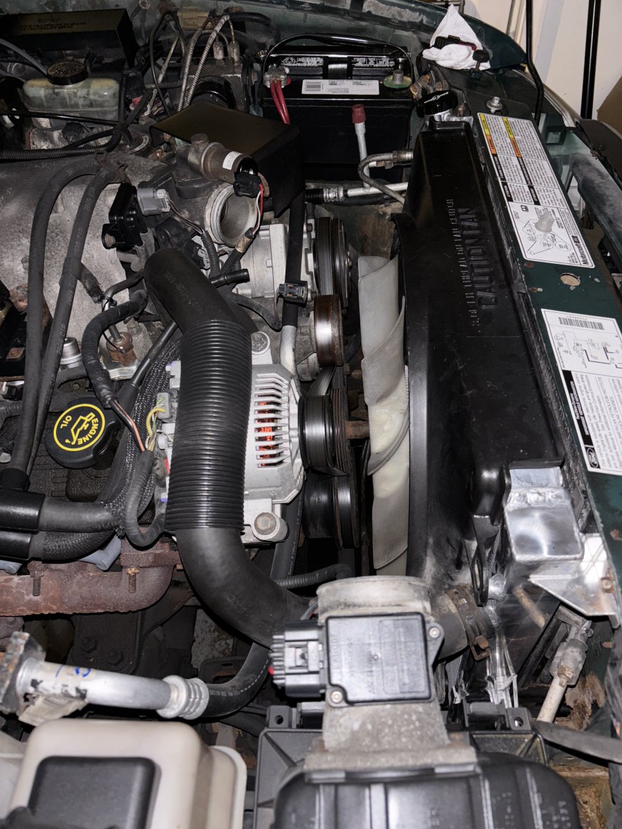

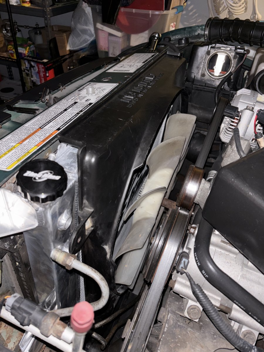

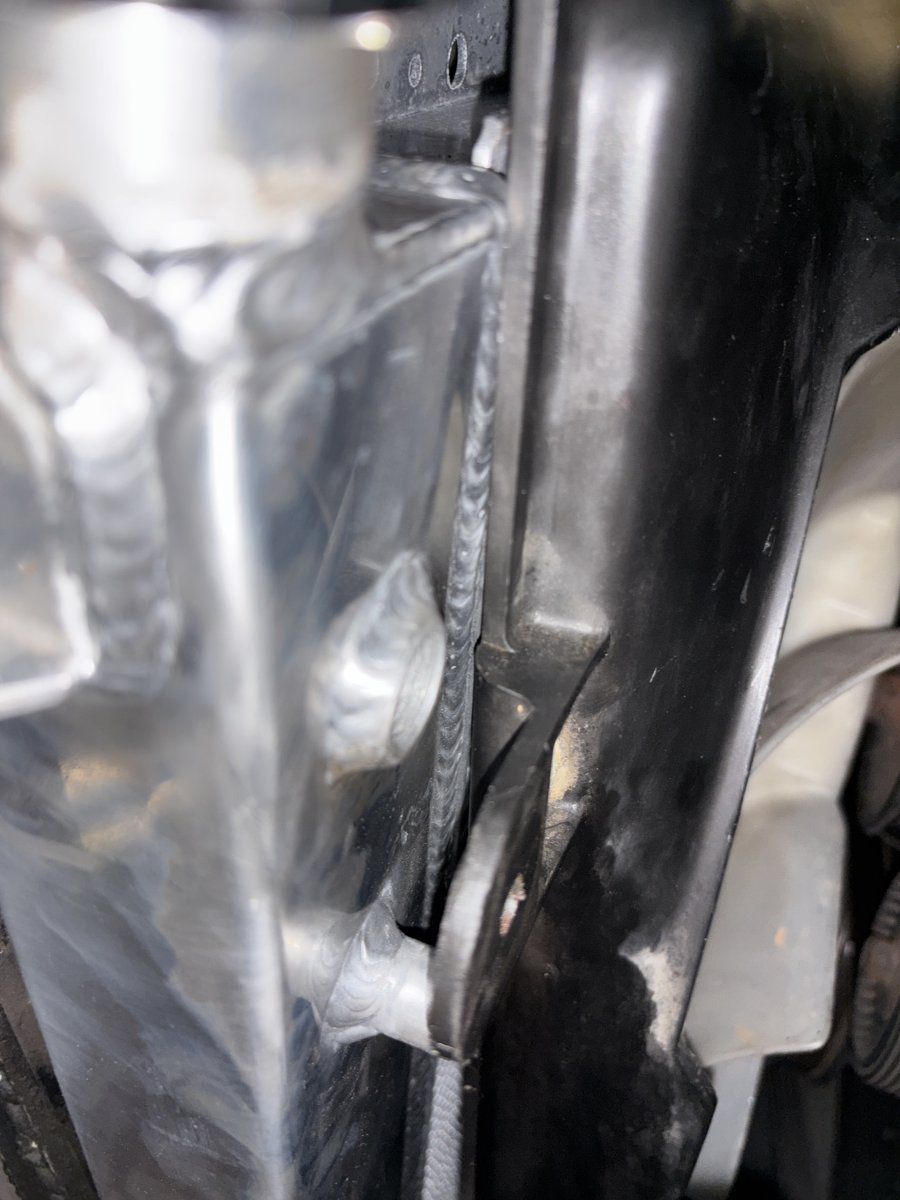

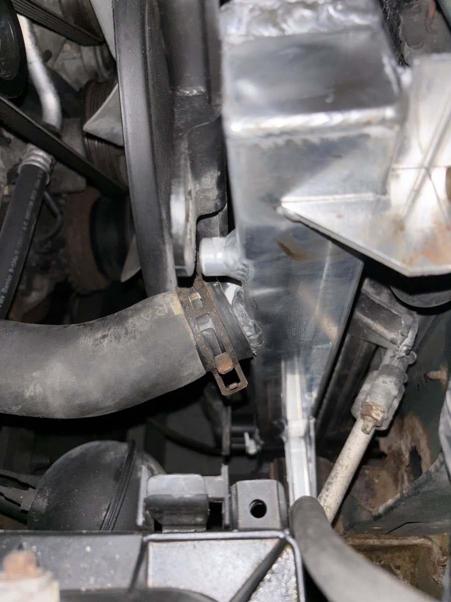

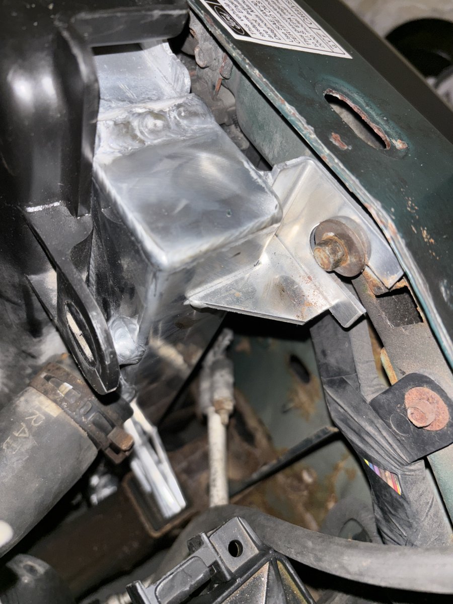

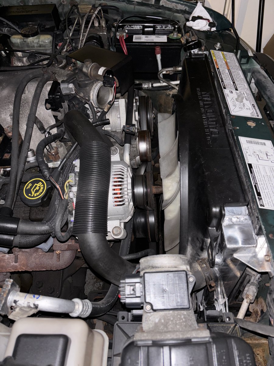

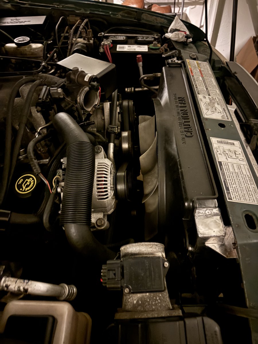

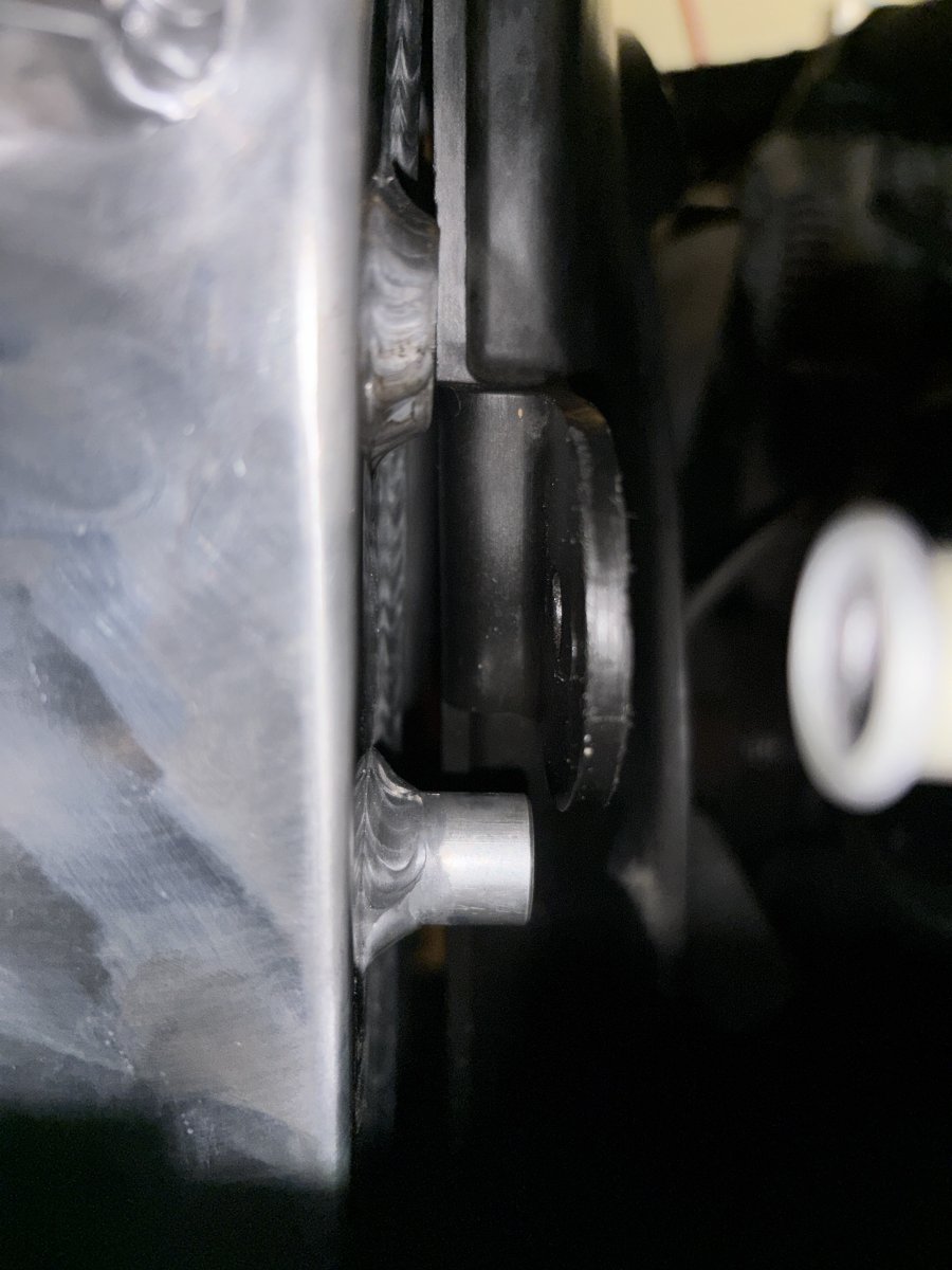

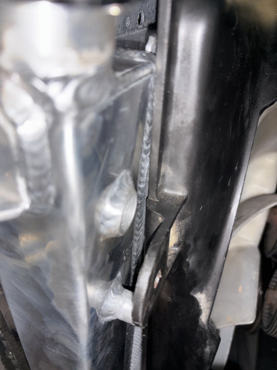

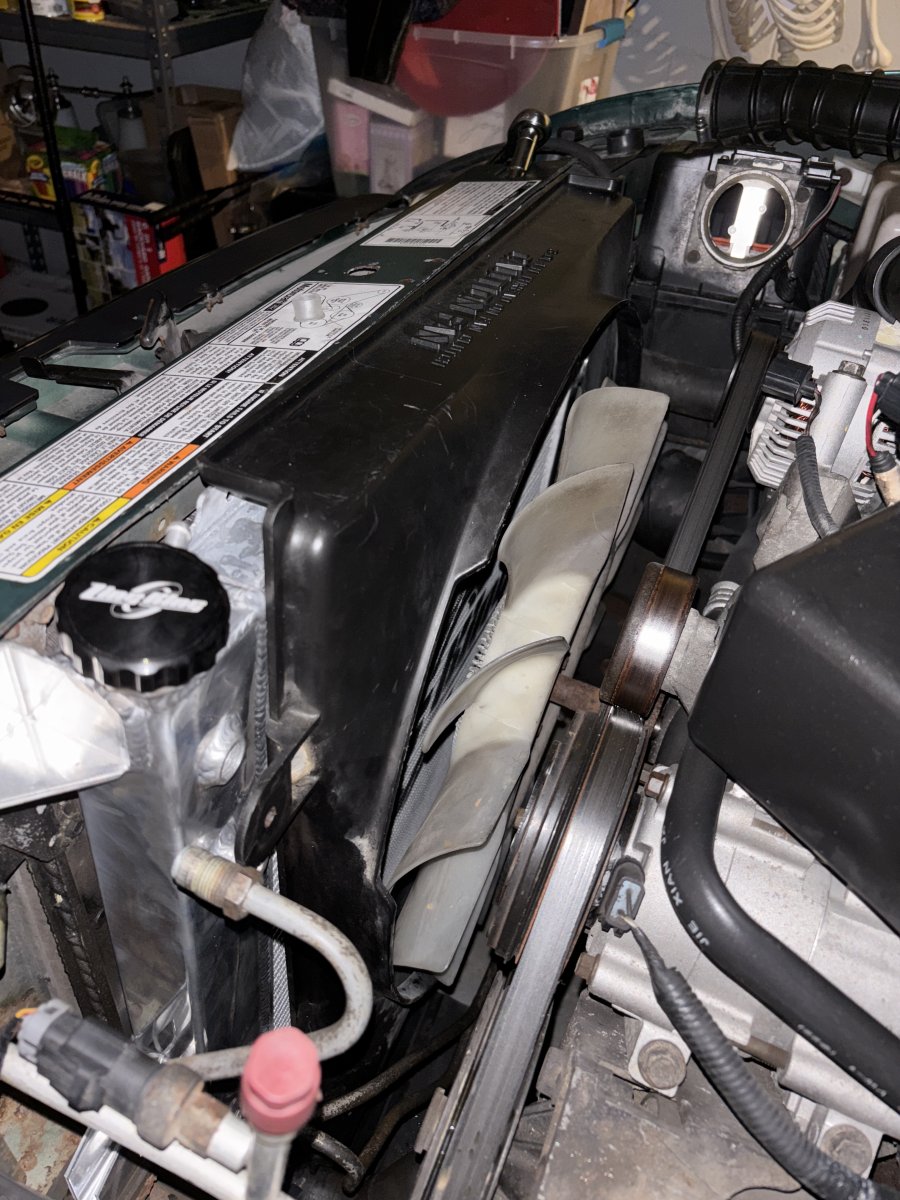

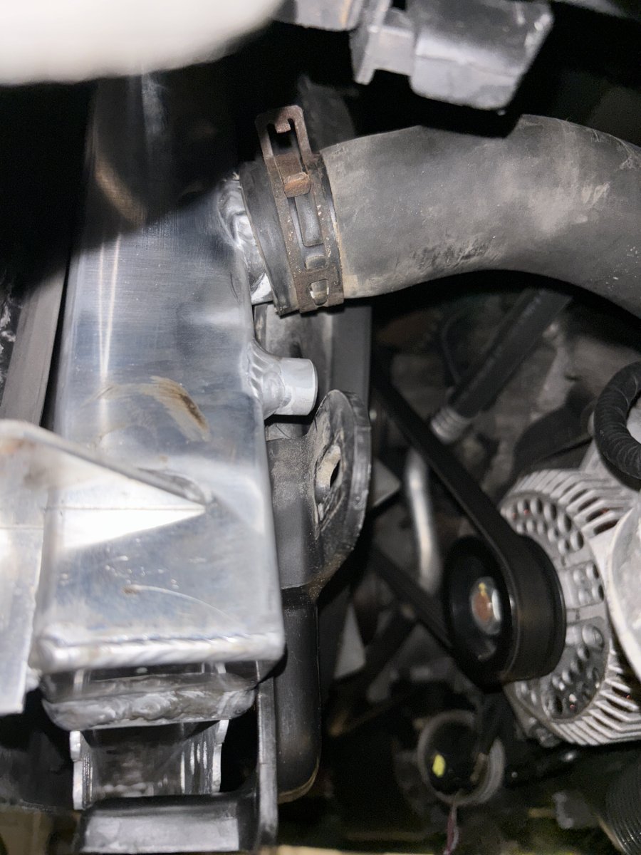

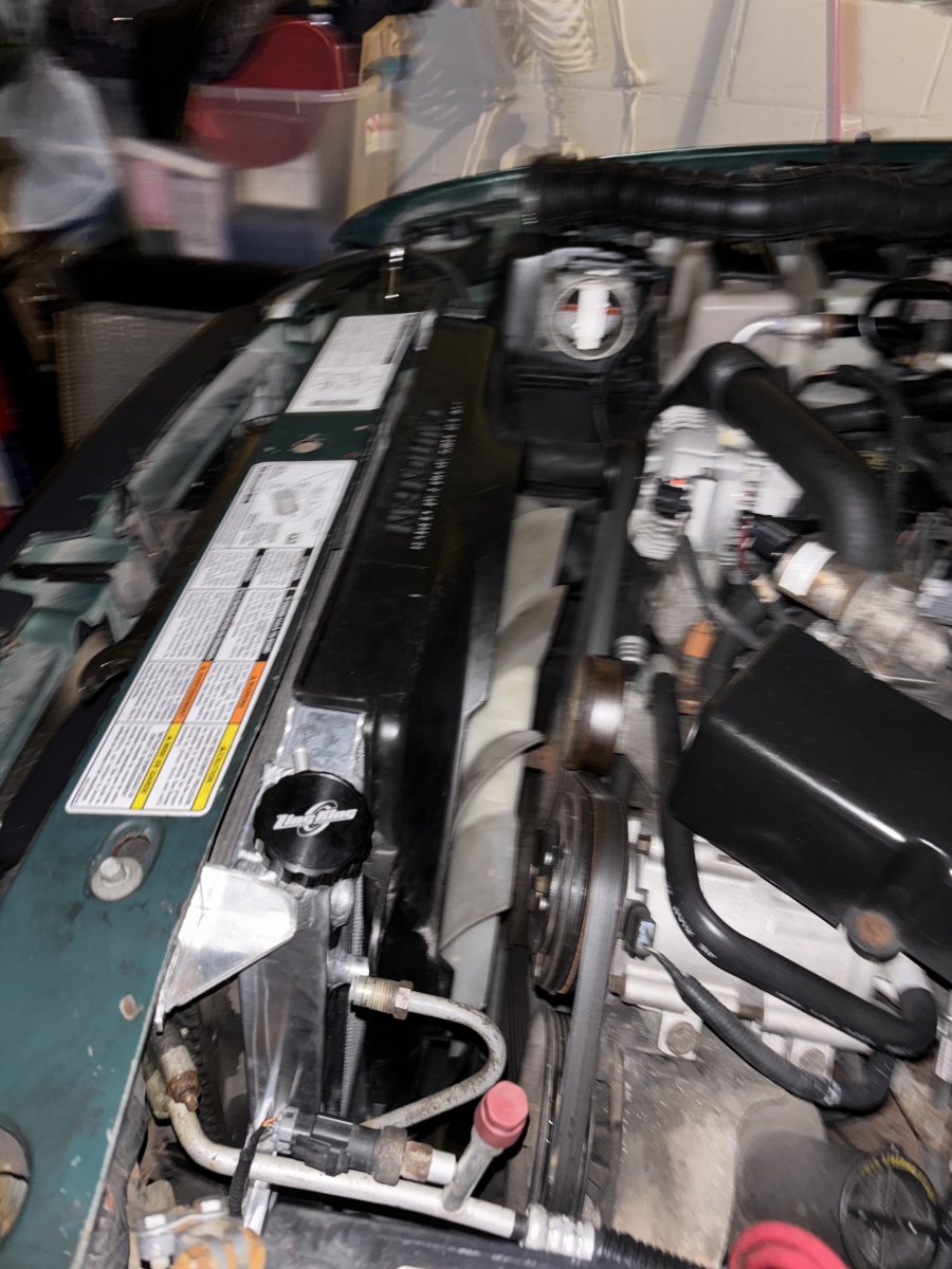

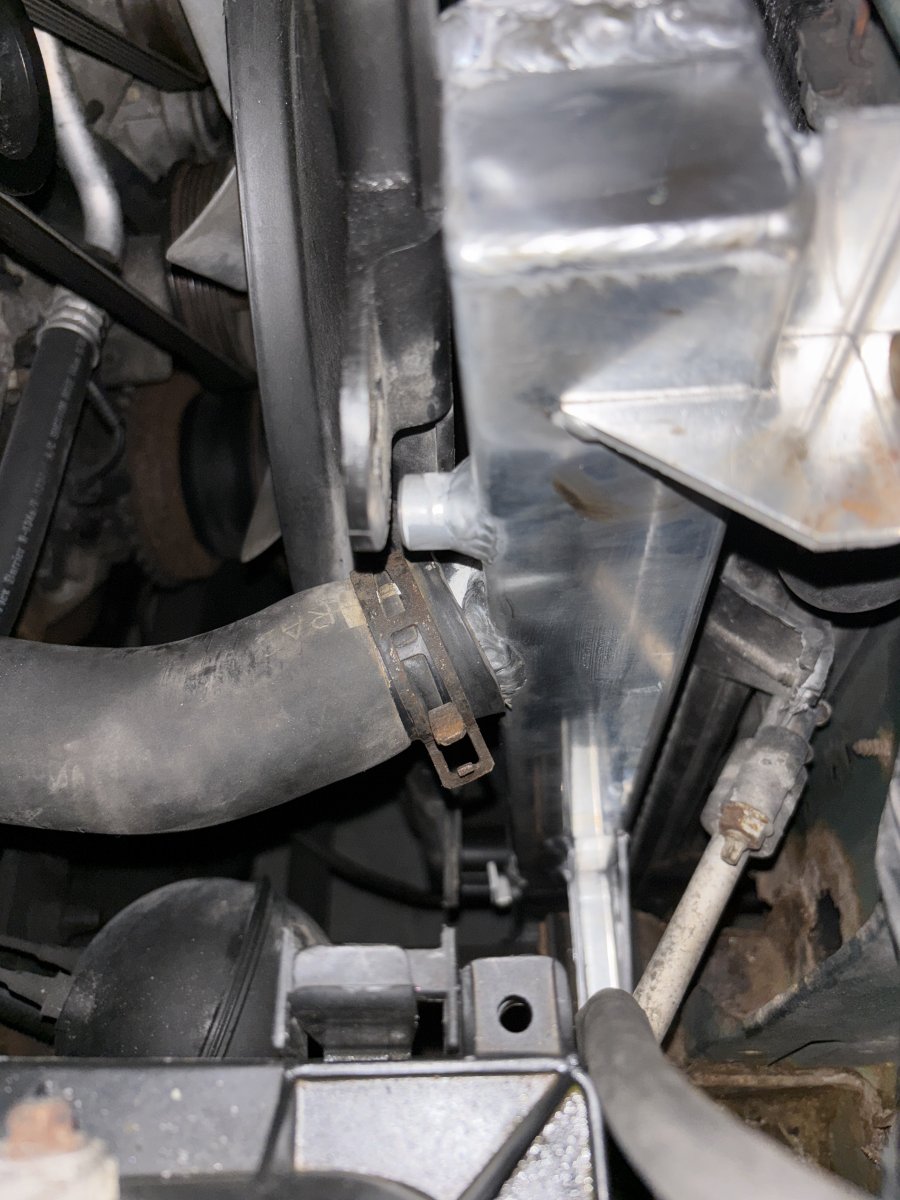

Just bought my first Ranger. 2000 XLT 3.0. Had to swap out the radiator so I bought an all aluminum one from a company called Zing King. Installed it, and the transmission lines fit, but don’t thread in. The fan shroud also doesn’t line up properly either. Not sure if I have the wrong part, I’m missing something, or if I’m just supposed to make some modifications. If it’s the latter, any suggestions are greatly appreciated as I’m semi-new to working on vehicles.

I would call them or send it back. Get one from the local store, it may fit better.
Update: the company actually confirmed I have the right radiator. I guess the fitment just sucks. I might end up just getting an adapter for the threading and make a plate to get the shroud to fit, unless anyone has any objections. I’d hate to return it because it wasn’t too bad of a price for an all aluminum.
My suggestion was because it sounded like you had no fab skills. if you can adapt it, that would be the best way to go since you already have it.
