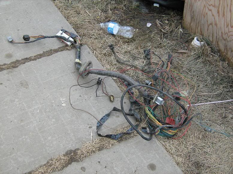

Im in the middile of doing a duraspark conversion on my 85 B2. Does any one have a wiring diagram for which wires do on the trany/tc. Its a 2.8l with auto trany with od.

Now I did something stupid. I cut all the wires from the computer out but didn't check to see which wires were (+) (-) on the lockup for my OD. Does anyone know what the colors on the wires are. Then cleanup the wires and im done.

Best thing to do would be to get a Chilton or Haynes that has a wiring diagram in it. Most people on here won't have the information you need off hand.
This link has on-line manuals. Should help you find what you need.
http://www.therangerstation.com/forums/showthread.php?t=319

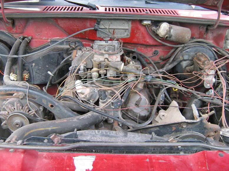

I saw your pics on the other site, you should post them here,too. You should also try a cowl induction like I did on mine. I just used a 4" dryer vent hose and ran it to the plate on the firewall driver's side. It's a plate that is to get to the driver's side wiper arm.
This pic is before I did the duraspark.

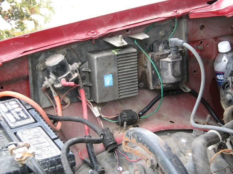

Well its all done here are some pics.
Wires for the OD are red(+) and orange/yellow(-)
