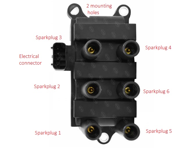

the engine order is fixed.View attachment 131227
Back to the question. The diagram. Plug side is 1-2-3 and is nearest to the engine when installed. So mentally rotate the diagram's coil pack rectangle 180 degrees.
That's the explanation. The diagram does not show the orientation of the coil pack relative to the engine.
