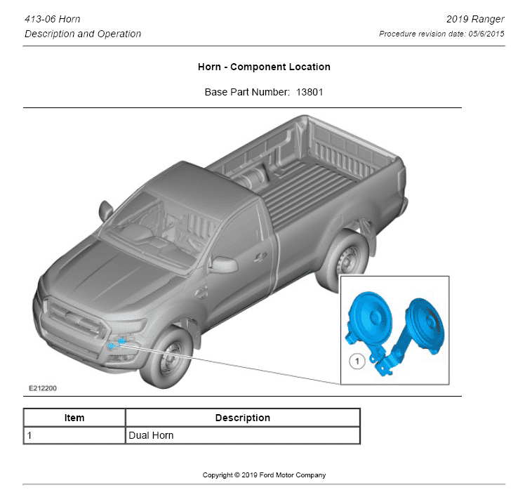

Gonna take some digging..
Do I need to remove the Grill to access that? Can't tell with that general image...
CMOS
I'm not entirely sure.. gave up the ranger for a bronco a while back.
After a quick look on Google.. seems like your going to need to remove the bumper to get super easy access

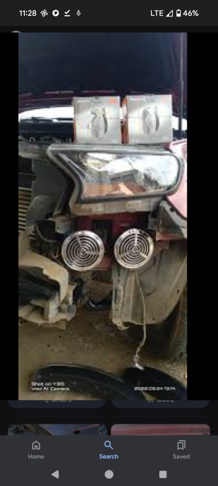

Going to install a Train Horn, need acces to factory horn wires: How?
I was able to see the horn assembly and connector by removing the front 4x4 skid plate, and looking from below the truck. The problem still is that while I can see it clearly, I am unable to access the connector and wires enough to tie into them.
So, I have decided to wire the Moto Horn to an independent Momentary switch that I can place somewhere on the dash, or maybe the steering column -???
I'll have to take a good look, but accessing those factory wires would entail disassembling that whole front end, which I'm not going to do.

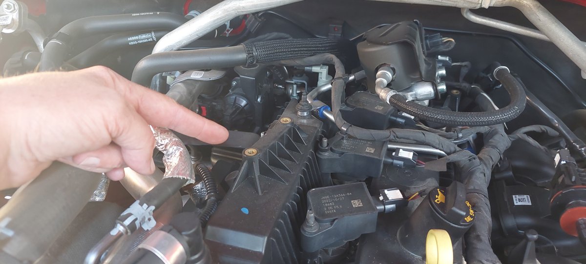

Some questions for the Hive:
1) What is the thread type for the Engine Cover Mount? I can probably use this to mount the Horn. (see pic)
