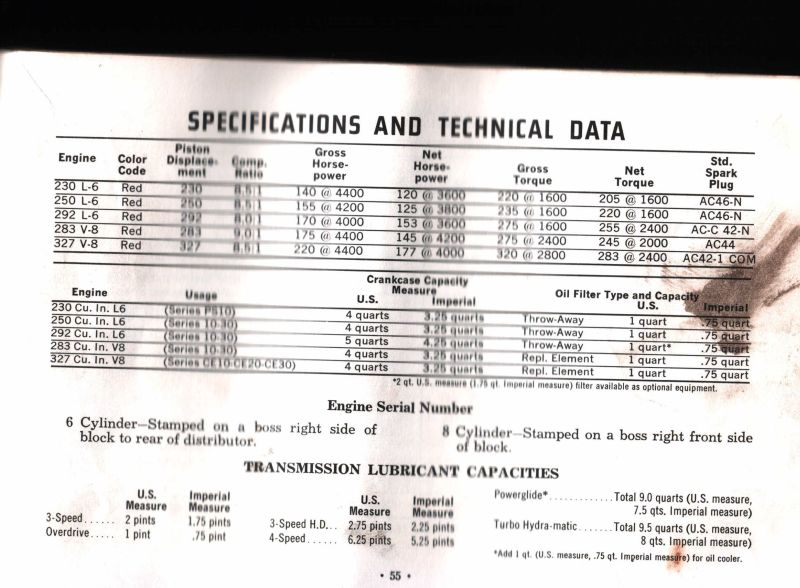

Some people throw the word horsepower around like it means something.
It only means something if you are comparing apples to apples.
Below is a page from a 1968 Chevy pickup manual. The give the rating in 2 ways--gross and net. In cars, they lsted only gross until 1972. The base Ford 302 that was rated at 200hp in 1968 was only putting out maybe 160hp by modern ratings. The 5.0 rated at 225hp in a Mustang would have been a 280hp motor in 1968.
So could you get 300 gross hp out of a 302 for $1,000? That would be 240 at the crank. If you had 5.0 GT heads you could. If you had a set of piece of shit heads, not a chance. If you want 300 modern horsepower--you need aftermarket head.
I always have to ask, where is the air coming from? You need air to make power. The street Boss 302 was rated at 290hp from Ford--which would be 230hp-about the same as a 5.0 Mustang and at a higher rpm. In fact, that was a popular race in magazines when the 5.0 GT was just out. I think the GT usually won. What are you thinking your wiffle heads are going to do?
