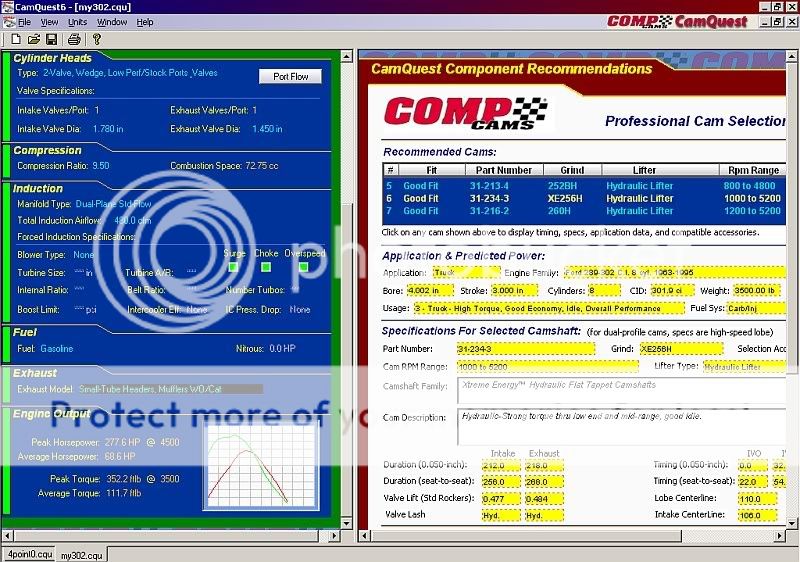

While the 4.0 does make impressive grunt at low RPMs.. it sure as **** doesn't make near the torque of my 302 nor does it have the top end power like my 302. The 4.0 just doesn't really like to rev as easy.
Some numbers for you. My 302, and 4.0. Put small tube headers on both, and a 256 duration comp cam. While according to the software, the 4.0 makes some damn impressive torque, the 302 makes more overall torque, and while it's peak torque is at a higher rpm than the 4.0, it makes more torque at the same RPM as the 4.0's peak.
