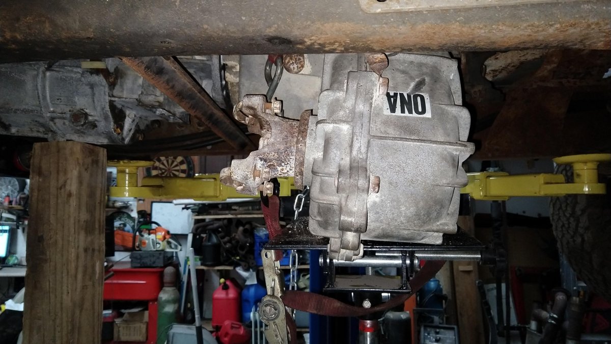

Correction, I should have looked at the TCase we have more thoroughly. It is a bw1345
Attempts to install 1345
39559
39560
Yes, the NP205 is a brute, but it fits without cuts and offsets in my Ranger. I tried the 1356 :( too. Been very happy with the 205 for several years.
Ok the answer seems obvious, if I can find a reasonably priced 205 near me I should go that way and build an additional cross member to support it.
