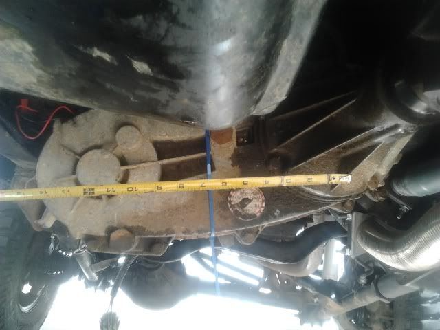

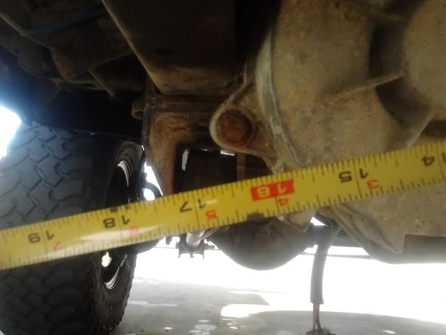

OK, it's part of my V8 swap. The V8 part is easy, but the transfer case gets tricky.
I believe the full size transfer cases that bolt up to, let's say a 4R70W are a little tight around the frame rails in a Ranger. Measuring my frame around the transfer case area says about 27" inside frame rails. I have an Exploder frame and I know it's about 7" wider than the Ranger at the back. Front appears identical. Looks like the clearance around the transfer case is around 29" inside frame rails. This has me thinking pros and cons of a frame swap. I've just about talked myself into this and yes, I'm ready and able to handle the fabbing I'll need to mount the body to the frame.
Any opinions as to how crazy I might really be?

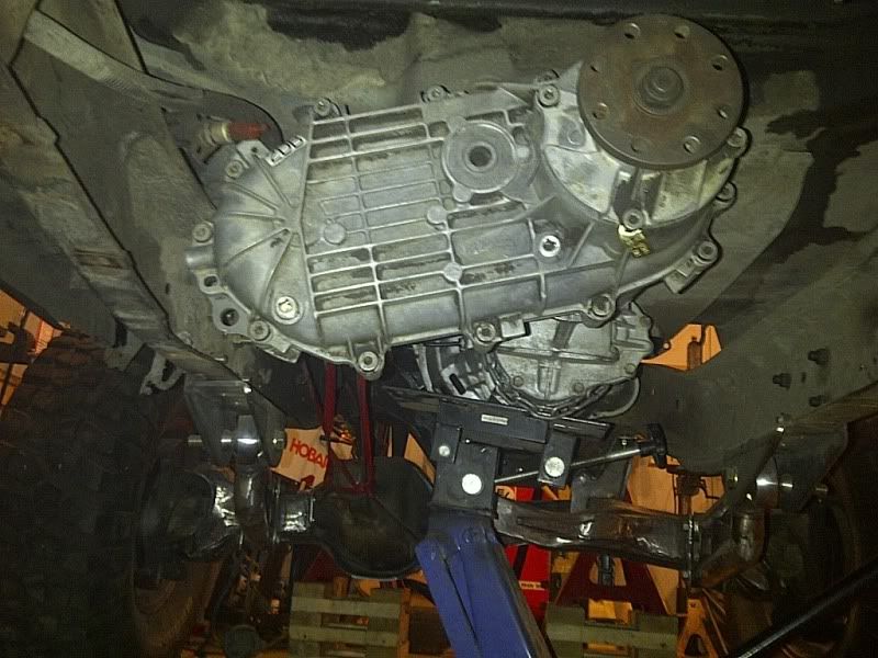

Good work. That is the best fit i have ever seen on one of those cases.
I'd like to see how much of the frame had to be notched.
none actually. I trimmed a 1/4 " initially, just to make things easier to install, but it wasnt necessary by any means.
not sure why people complain about these things being so big, theyre larger than a 1354 sure, but so are the axles/tranny/engines that we end up using, and we make those fit.
note that this pic shows the t case sitting on a stand, not in its placement. tcase is level with bottom of frame rails.
Full size transfer cases
I have pretty much the same setup and also didn't notch the frame just took the frame where the t case would hit and bent it down then ground back some of the webbing on the t case for more clearance.

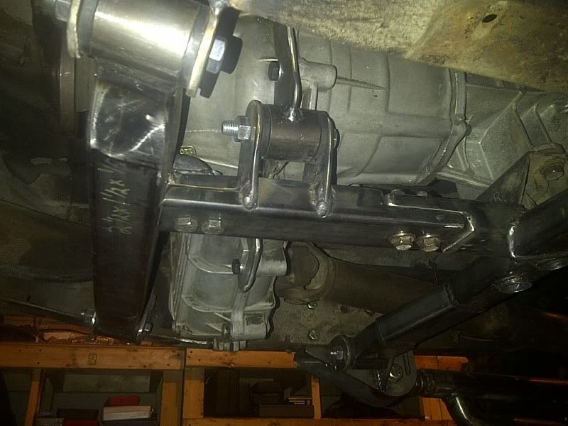

Do they normally require that extensive of a mount? What did you do for a linkage?
absolutely not, normally they just hang off the back of the tranny. used the stock linkage.
I plan on jumping this thing on a regular basis, and build things to withstand the apocalypse, hence the additional tcase mount.
All aside, if you don't want to notch or bend the frame at all; or have a boxed frame a 1356 isn't my 1st choice.
It is a good looking mount. :icon_thumby:
Fitment sounds/looks similar to an NP208, some require a little more butter to fit between the frame than others depending on trans placement. :dntknw:
Holy over kill on the trans mount batman! my trans mount is no where near that extreme and trust me I jump the hell out of mine.
