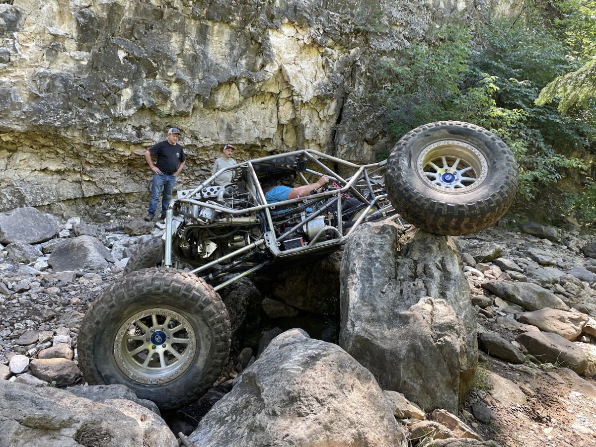

This dude was wheeling with us last summer and his little moon buggy had some little turbo 4 cylinder engine and a TH350 and an Atlas... there are options. GM is usually the cheapest.
