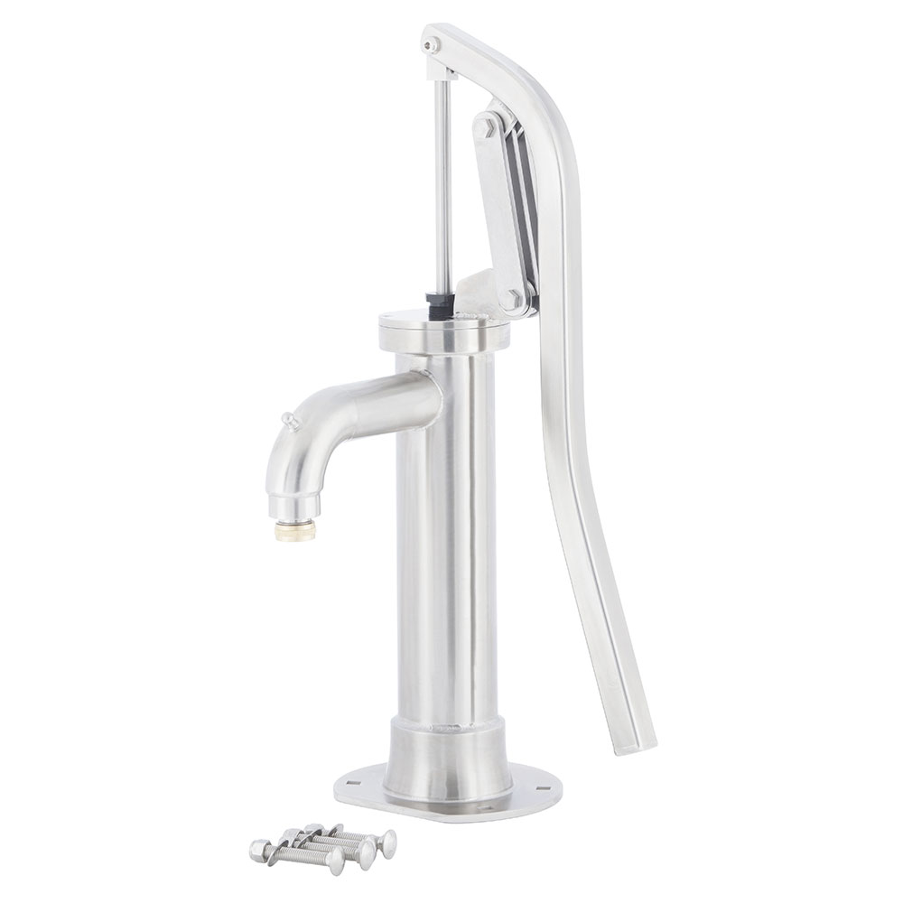

Since you enjoy older technology, install one of these within reach of the driver's seat and plumb it in accordingly.
