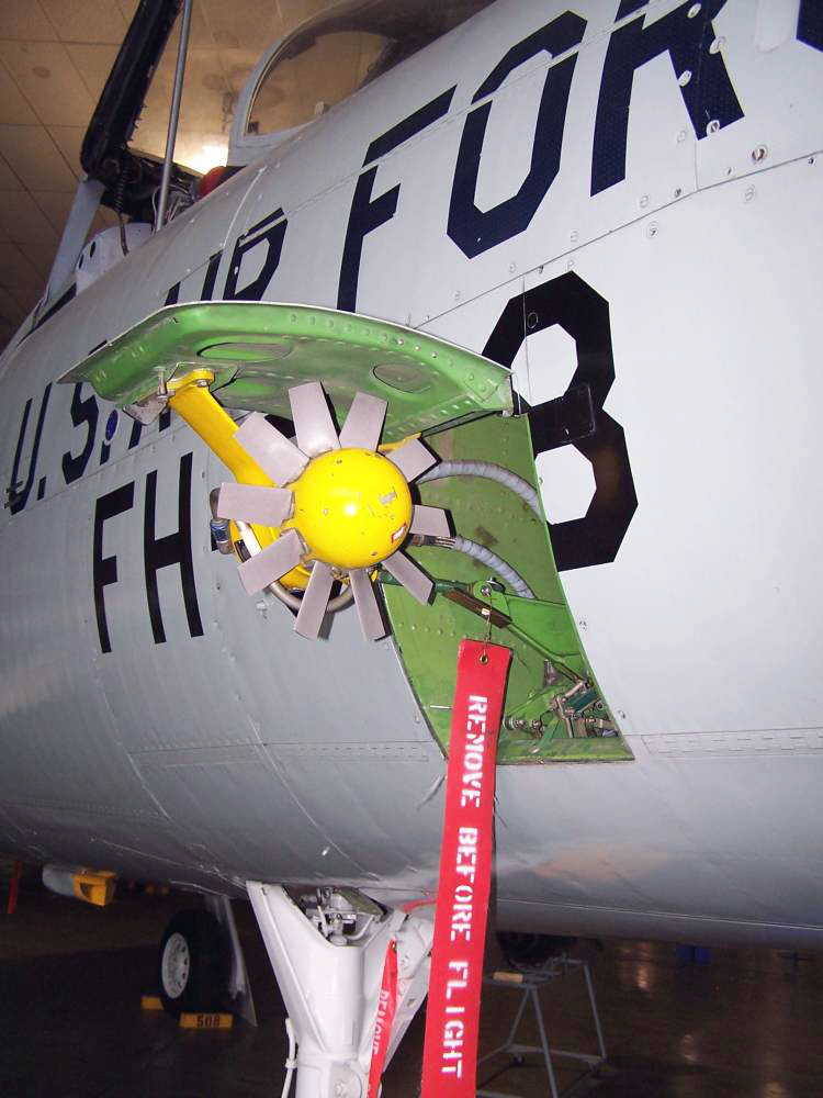

Not if he puts in a wind powered fuel pump ;) Then the only issue is always parking where you have a headwind, or pushing it fast enough to start ;)
