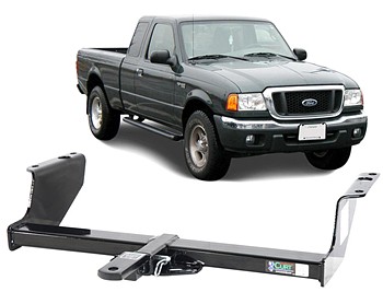

Can I assume your tow hitch is a bit more impressive than the bumper-plate ball I have on my '93?
I got a factory trailer hitch from the wrecking yard a couple weeks ago for free. I'd seen one with the ball hitch still in it and grabbed that, but when paying out they had charged me $22 for it, but didn't notice that till later.
The next day I mentioned being shocked they charged more for parts(that one anyway)than Wmart sells em for new.
Over the weekend I studied into it and realized they had charged me for the whole tow package, and went by there early the next week and asked if I could have the other half, and they said "sure"!
An hour and 4 tough bolts later I was toting an almost hundred pound factory jobber out to my truck :)
Those prices were on their 50% off special, but you'd still likely get one at a decent yard for under $50
Is this the part you're talking about (roughly speaking, that is)?
33635
(Asking because I'm pretty new to all of this and really unsure what all is included in a "tow package") :/
Yes sir! :) I believe the "tow package" included that and the tail light plug(which simply plugs into the L-R tail lights connection)
