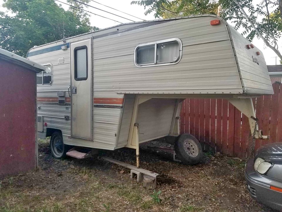

Guys, I think I just did a dumb. I bought a trailer. The positive: (1) it's really small (the window that's partially obscured by the shed in the picture is the back corner, and the Google search for specs turned up a weight between 1500 and 1900 lbs); (2) it's in pretty darned good shape considering (3) they were only asking $800.
Please tell me there's hope that I didn't do the dumb I think I did.
43291
Does it come with the 5th wheel mount for the truck bed?
Been looking for something similar myself.
