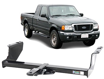

Is this the part you're talking about (roughly speaking, that is)?
(Asking because I'm pretty new to all of this and really unsure what all is included in a "tow package") :/
It’s all semantics but...
My understanding is a tow package from the dealer generally includes the receiver hitch, the wiring connections and sometimes a wiring harness for a brake controller and on newer vehicles with automatic transmissions there may be a special “tow/haul” mode that changes the way the transmission acts. The part that slides into the receiver and attaches with a pin is the draw bar. The ball generally mounts in a hole in the draw bar.
What’s pictured above is the receiver and a draw bar.
