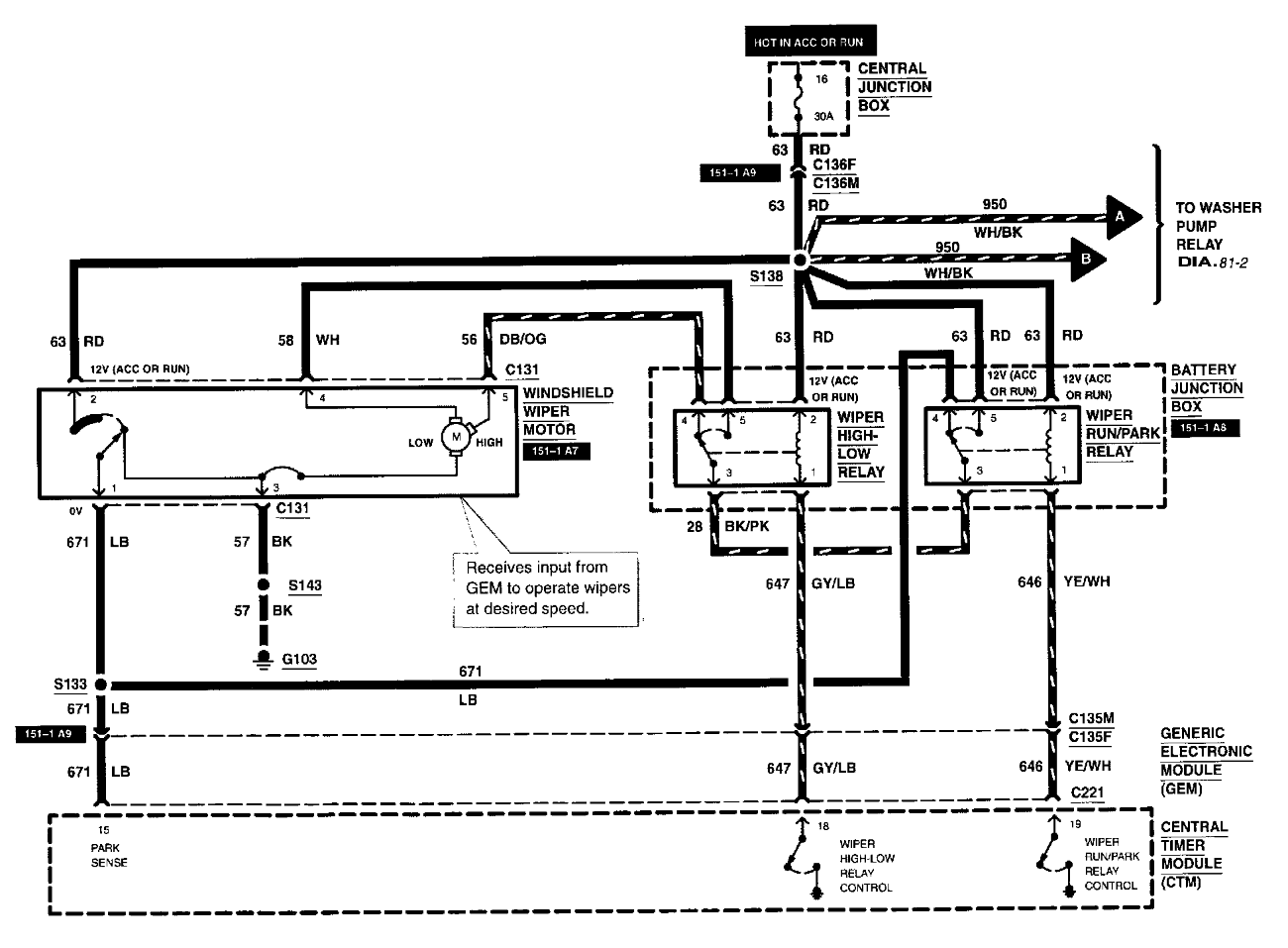

Have an issue where turning on my wipers instantly pops the 30a fuse. I unplugged the motor and it still happened, so I don't think it's the motor. The relays all test fine. I just cannot find anywhere a wiring diagram for 2000 that shows what else is connected to the wipers. I pulled the fuse box off an it looks like there's a black/green wire on that fuse, but also a red one. Before I go chasing all the red wires in a truck, I'm hoping someone knows already what else is tied into that so I can start there.
Thanks.
