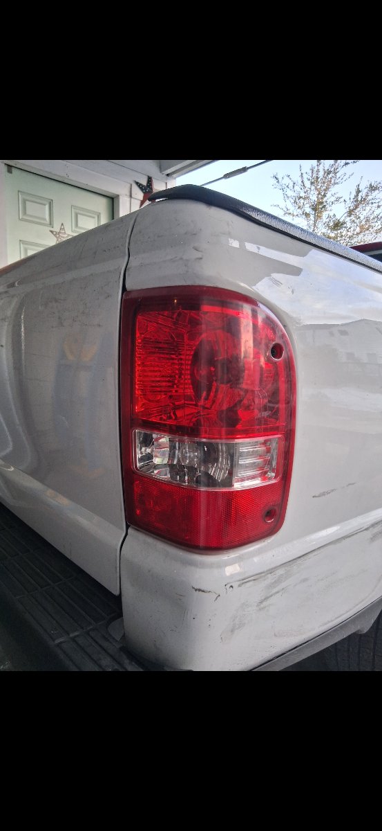

Bought on fleabay for $33, just installed so much better than the cracked one before.
