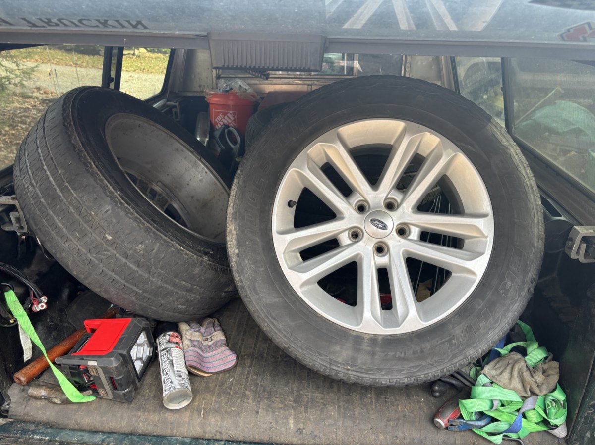

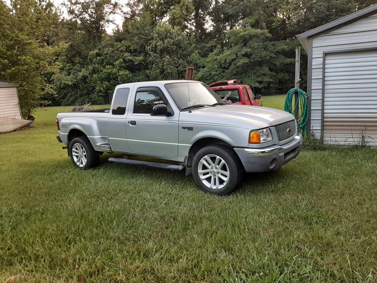

Speaking of the explorer wheels, and since everyone is showing off their new wheels, I guess I'll show off my future wheels. I bought these to go on my dark gray metallic 99 Ranger after I lower it and convert to live axle. These won't be the "forever wheels" but they were cheap way to get into a size I was interested in for settintg up and testing out suspensio and ride height. The wheels are 2011-2017 Explorer 18x8 and the tires are 245/60R18, so about 29.5" tall. Well worn so probably closer to the 255/55R18 that I want to run.
Dad wanted to try out the smaller diameter on his truck and see how it responded so I was able to get a sneak peak of how they will look on a 4x4 Ranger. My truck will hopefully end up sitting a little lower than this.
(Click attachment link, picture isn't showing up in the quote for some reason)
FWIW they should be using 1" front and 1.5" rear spacers in that picture of dad's truck. I think that we had the same issue as you encountered with the hub bore, but in our opinion these wheels have too much offset to run without spacers.

Ok, so spacers can fix it. I’m ok with running spacers. I was wondering about how it was going to fit, if I was going to end up set in too deep. That’s part of why I was trying to fit them. I have some shims coming today that will let me bolt these on as-is and determine exactly what I need to do to make them fit right. Really kinda like the look of these rims and other than a gouge in one, they’re almost brand new looking.

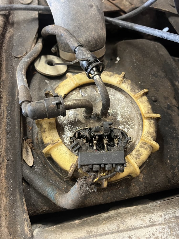

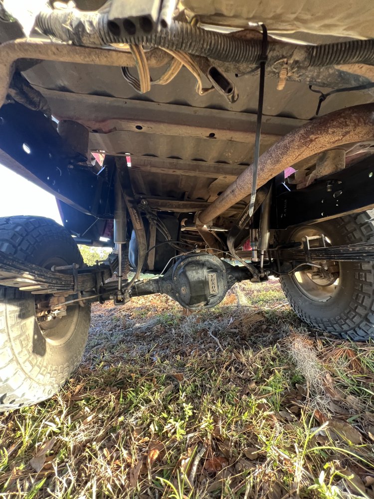

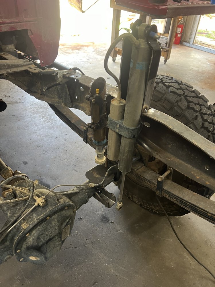

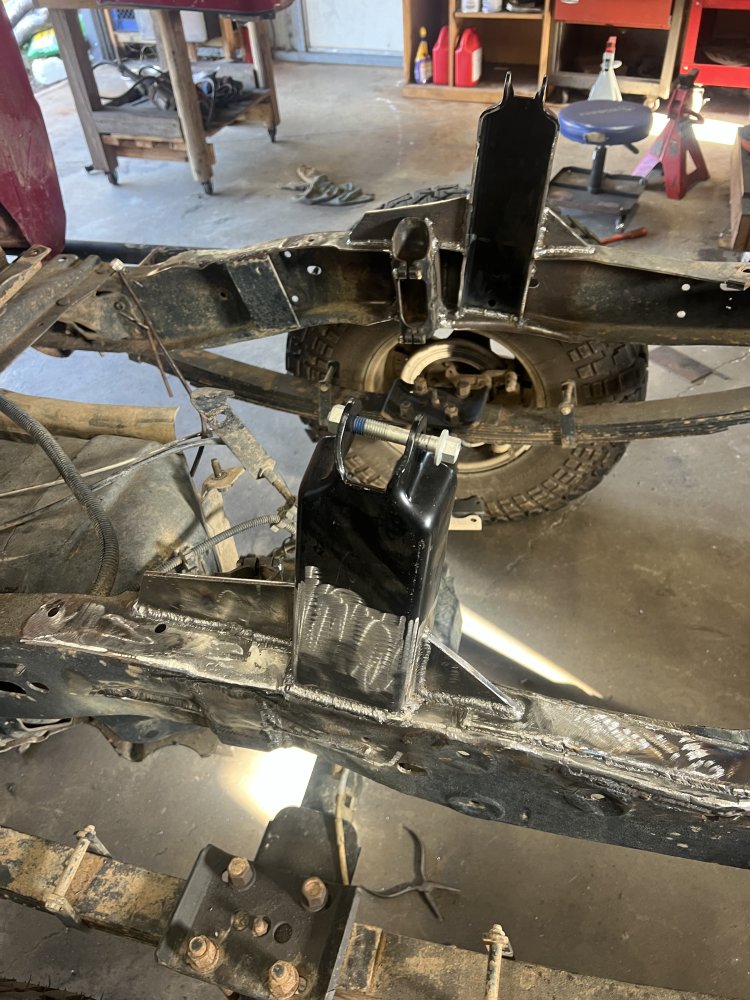

Redid most of the rear suspension over the last few days, not done but happy with it so far. I did notice however most of the fuel pump connector has dissolved. Anyone ever see that before?
Also did a little burnout to test the lack of wheel hop.
