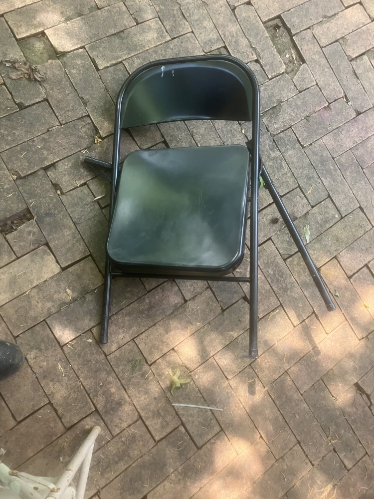

Why didn’t anybody warn me about the hazards of the workstation when you’re pulling on that 1-1/8 inch wrench with all your might?

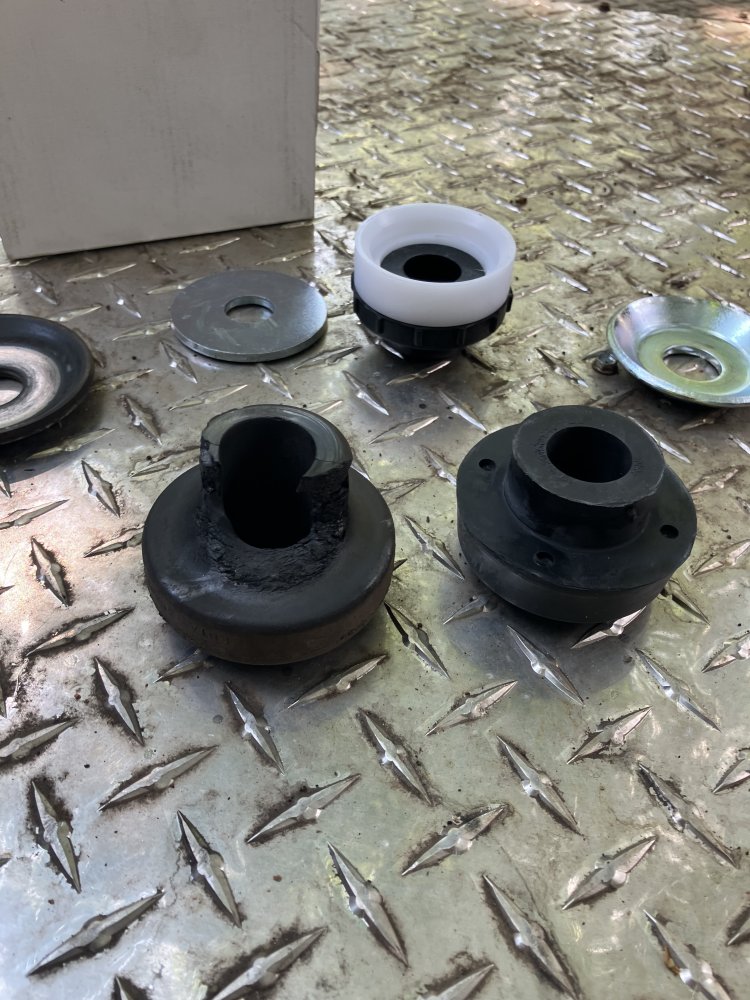

Job is done, but I haven’t gone on a test drive yet. I used option B. After unbolting the sway bar and the shock, I tried to commit suicide while I was taking the spring nut off. Fortunately, I just tumbled and didn’t get hurt. That was an almost brand new folding chair. I got one of the beat up ones that I’ve had for 30 years, and I used an 18 inch pipe wrench at the end of the box wrench to crack the nut lose.
With the spring out, I used two 500 pound ratchet straps to pull the assembly forward enough to get it out of the bushing hole. I had to push it all the way down, and then use granddaddy’s crowbar to finally pop the radius arm free.
You almost can’t tell which one is the new one and which one is the old one, huh?
Actually, getting it back together was harder than taking it apart. I actually had to use a third ratchet strap to pull the assembly towards the rear enough to get the pieces together and put the nut on. It was a piece of cake after that.
The first two ratchet straps were casualties along with the chair. I was using a pair of channel locks to crank them. One bent so bad that I actually had to cut the strap on the ratchet side to get it off. I was able to get the other one off, but the ratchet is ruined.

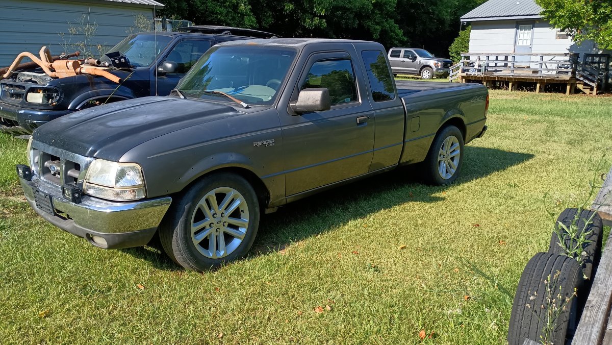

Today I got the suspension buttoned back up for now. In the last coupl eof weeks I've installed drop torsion keys and new lower ball joints. Removed the Explorer springs, and extended shackles in favor of stock Ranger leafs and shackles W/O lift block. Installed 1" BII rear anti-sway bar, and Explorer 1 3/8" front anti-sway bar. Stock bars were about 5/8" on the rear and 1 1/16 on the front. I'm sure they are actually metric, but I don't have a metric tape measure and wasn't looking for the calipers.
Headed in the right direction, but not entirely satisfied with the outcome. Close to what I want but not quite there. I like the front height and wouldn't mind being a little lower, but the camber is excessive. With the adjusters moved as much as possible I think I've still got about -4° of camber. With that front height I'd like to drop the rear down a little more to match, but I might have to lift the front back up to get the camber manageable. It's on a 29" tire there, I'd like to drop to a 27 or 28 eventually without a big fender gap. Height might even be right for that now, but the excessive camber is throwing off how it looks IMO.
Still need to pull and change joints in the upper arms and I'm going to try another trick to help with camber and ball joint angle when I do. Unfortunately, I can't remove the passenger side upper arm with the engine in due to the camber bolts hitting the shock tower and exhaust header. So when the engine comes out (hopefully only a few weeks off) I'll do that work and see what happens. If necessary I'll crank the front end back up some and maybe run a taller tire until custom parts become available.
Need to get an eraser wheel and get rid of that 4x4 sticker before I get it back out on the road too much.

That's not a wheel weight, that's the warning ticker for worn out tires...
They actually have a lot of tread left. I hesitated to post the picture because it looks like they’re worn out, camera angle/optics.
