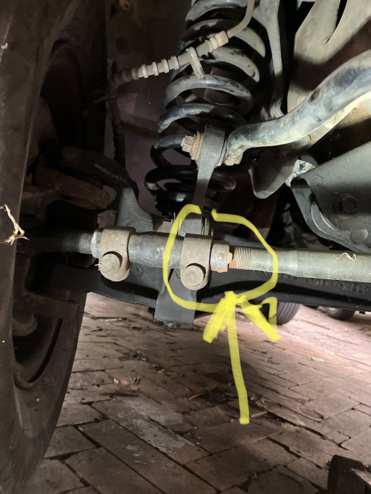

I tried the DDS&W alignment method on the 97 Road Ranger, and it actually showed that the toe in was good. Still has a little pull to the right and the steering wheel is off.
I jacked the truck up in the middle, and I just grabbed everything and tried to wiggle it. All of the ball joints, and such were very tight, but the passenger side steering link had a little motion in it. I almost crapped my pants when I found the bolt on the adjustment sleeve was loose. It’s probably been that way since I bought it.
The circled nut had to be tightened about a half turn to snug it. Then everything was tight. I love the grandpa who owned this thing, he took very good care of it. I’ll be taking it to the NAPA shop near me for an alignment, and straightening out the steering wheel. $89

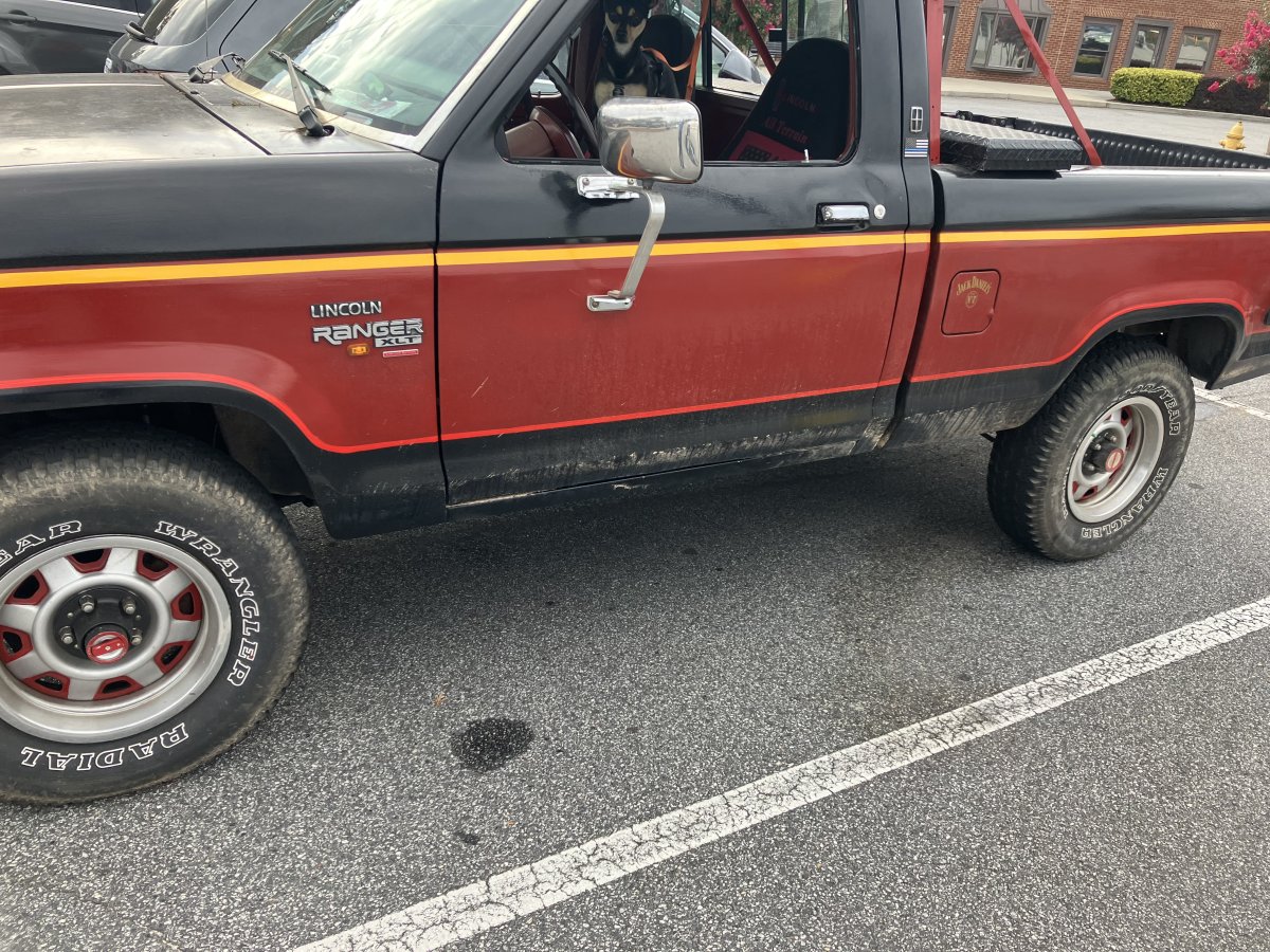

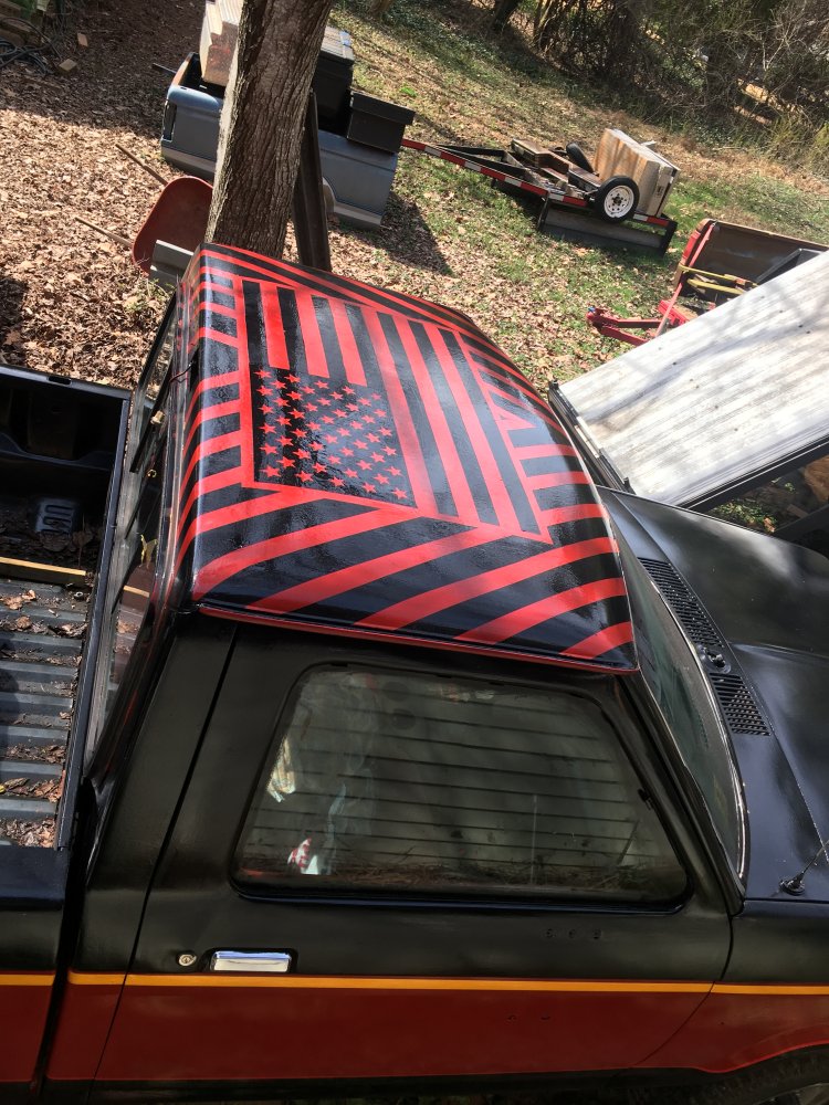

Never underestimate the value of a few pinstripes. Whenever I get a little dent in something, the first thing I do is put a pin stripe on it. People’s eyes are drawn to the pinstripe and don’t see the dent.
I was inspired for the yellow pinstripe when I put masking tape down the side of the truck to paint the black after I had painted the red. The lower red pinstripe was to mimic the OEM design. Both are reflective.
You can also buy stencils for stuff like the flag for pennies on the eBay (get the plastic ones and you can reuse them), and the stripes were done with a little bit of masking tape.
Having said all that, I really like the way you laid out the paint on your thing. Unusual, but it looks great.

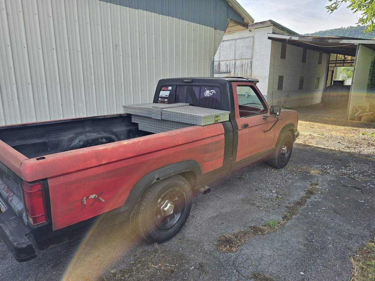

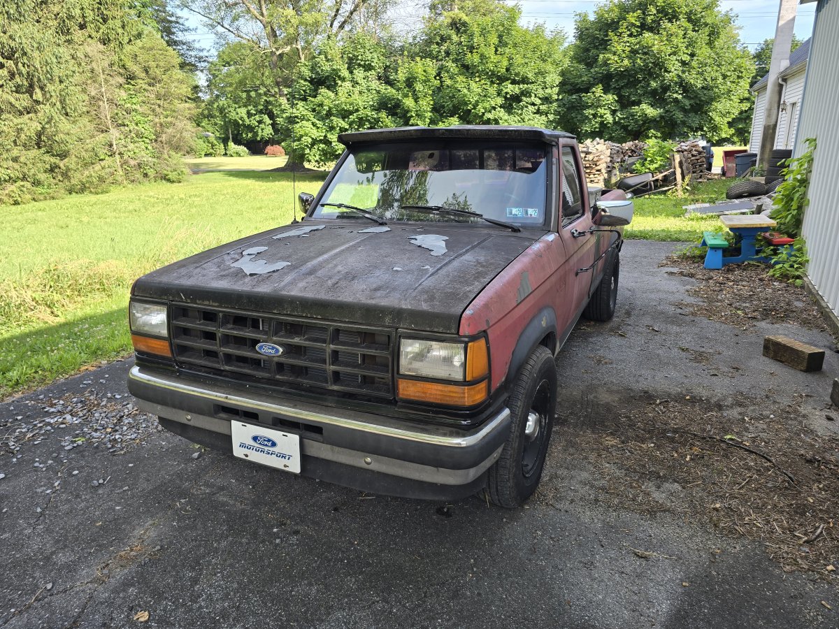

Where are you? When I went on a buying spree when I was all busted up and with the blood problems and wasn’t thinking right and I bought a bunch of Ranger stuff. I got an 1987 or 88 short cab short bed complete truck except the engine and transmission. The guy was in the process of doing a V-8 swap, and he got divorced, and then the project died and I bought the truck from his wife.
It’s straight as an arrow and completely rust free. I have a set of roller tires I can put on it, and I could also put on a tow tow bar. It would be an easy tow without the engine and trans.
I was planning on the third crazy project, but with my limited health and failing motivation, that one will probably never get done so I need to get rid of the truck.
If you want it set up with a tow bar and with lights like a trailer I can probably let it go for about $750, which is really just getting my money back. No profit, that’s what I have in it. And I have the title.
If you’re interested, I need a little time to find the pictures. Let me know.
I'm in central pennsylvania.
