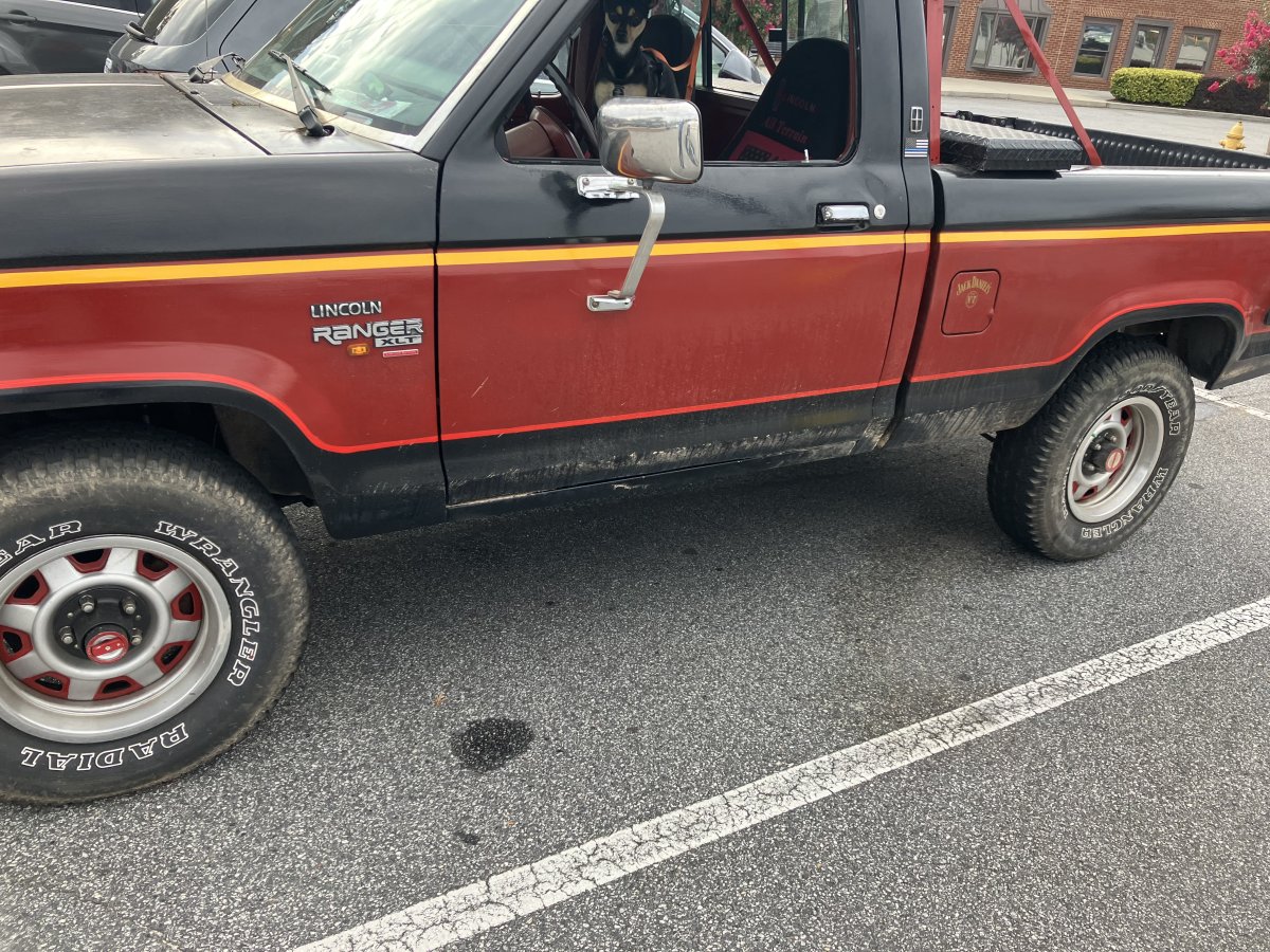

Got it back on the road after a charging issue still need to mess with the hydraulic clutch though and repaint it for Carlisle in August.
Dare I say it again?
Rustoleum w/30% mineral metal spirits and a foam roller. $50
You don’t need to repaint it, it’s fine.
Last year at Carlisle, someone yelled “ I’ve seen better stuff at the junkyard, what the bell is that doing here”. Then the ratchet strap holding the tailgate up broke and I had to get out and fix it.

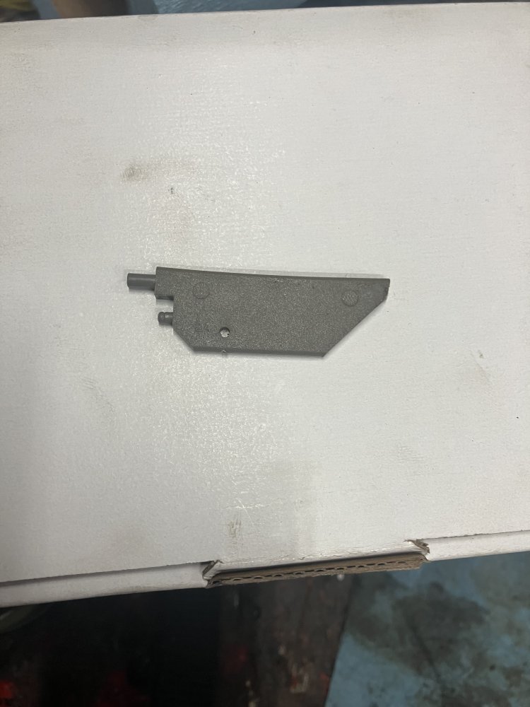

One of the missing pieces was inside the hole:
It’s missing the pin on the right hand side. I used that as a template on a piece of scrap gray interior I had (part of a door panel?) and cut out the two pieces and sanded them.

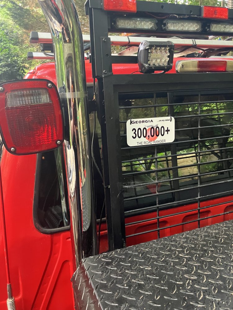

I didn’t like any of the stickers, so I had a bicycle lic plate made.

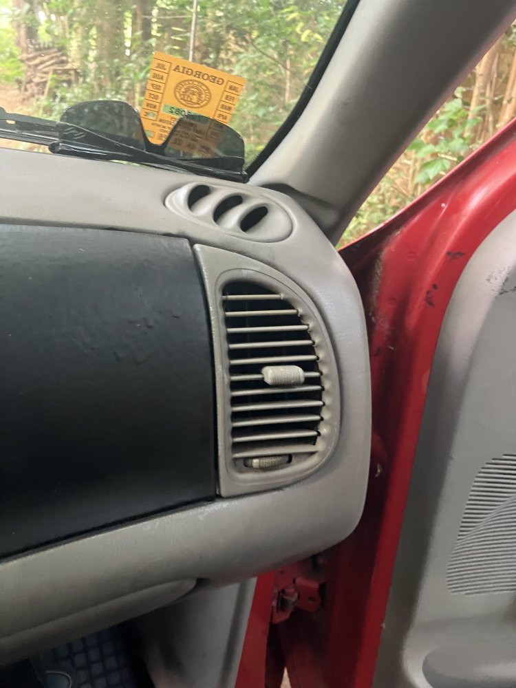

And, Before:

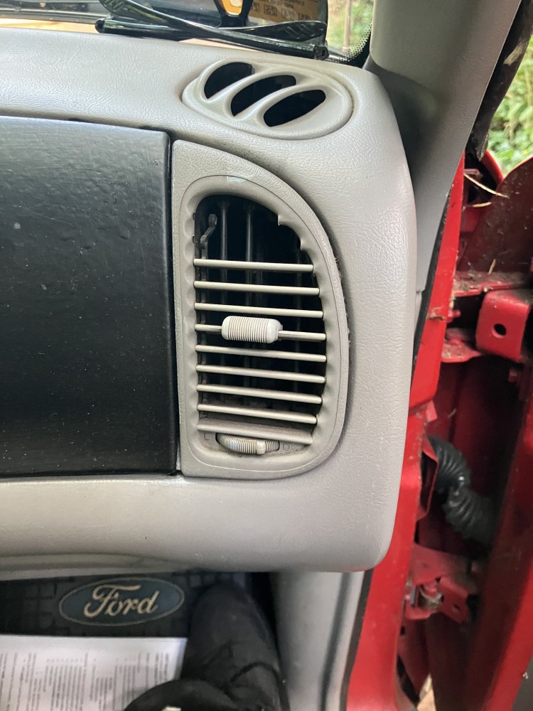

After:
It looks pretty again, but it doesn’t work right. I can open and close it, move wind up and down, but can’t direct the wind left or right. I have to find one in the scrapyard, the right color, or any color and I can make a good one.

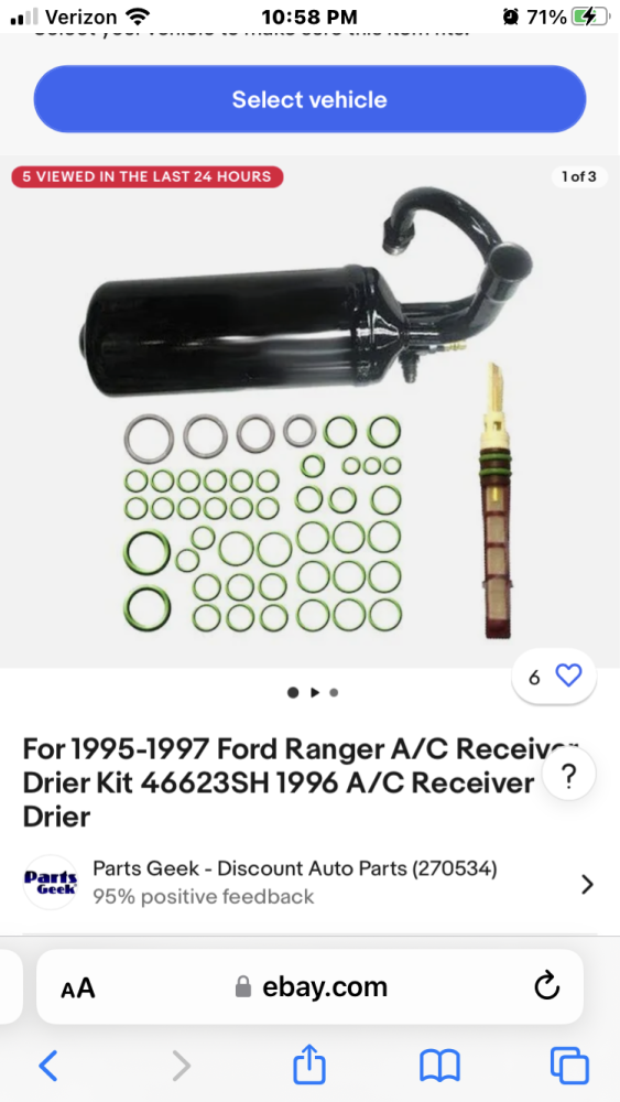

& they sent me the wrong accumulator/drier. With some help from @snoranger (thanks again) and a few videos, I bought the correct accumulator/drier with the o rings and the expansion tube.
Question: a lot of times on old fittings, O-rings or compression or whatever, I replace the parts, but I also put a little smear of silicone seal on them to get the micro holes. That or the E 6000/goop stuff. Is that a good idea or a bad idea on this thing?

Q1) PAG oil, same stuff they are going to pour in to lube the compressor. For all other o-rings, I'd go by the system. Most engine and fuel stuff I'd use something petroleum based, like engine oil or vaseline. Seriously vaseline, dad has had a tube on the shelf for decades for that very purpose and we use an industrial version to lube new seals and o-rings being installed on airplanes fuel systems. Door seal and weatherstripping type stuff, silicone based.
Also silicone for oxygen systems IIRC, didn't work with that much as there was a separate shop that handled most of those sytems. I wouldn't even mentioned it as that is something that most people wouldn't touch without special training, but I seem to recall someone around acquiring a whole truck load of oxygen cylinders. He's also got this weird attachment to a coffin so who knows what he's likely to try. Just never know with some people. :derisive:

PAG oil on the O-rings. No sillycun geese. I poured enough clean oil out of the lines to use to lube my O-rings before I installed them. Remember to sit your compressor on the clutch while you work. The oil will flow down and around the front seal and help prevent any leaks. It also stops the oil from puking out of the back of the comp when you take the cover off.
Thank you thank you!
On the PAG oil/silicon issue: I was thinking of silicone more along the lines of sealing any possible pin holes around the O-rings in this 316,000 miles system. When it’s fresh, it helps it slide together, and when it sets, it should plug any holes from corrosion or such.
Is there anything chemically in the silicone that would interfere with the AC mechanism and chemicals? I know there are other parts of the engines where you can’t use silicone because it interferes with the sensors.
Yes/no?

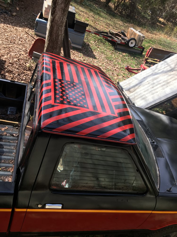

Or just roller and rustoleum and a case of beer.
Like6-7 years ago.
Never underestimate the value of a few pinstripes. Whenever I get a little dent in something, the first thing I do is put a pin stripe on it. People’s eyes are drawn to the pinstripe and don’t see the dent.
I was inspired for the yellow pinstripe when I put masking tape down the side of the truck to paint the black after I had painted the red. The lower red pinstripe was to mimic the OEM design. Both are reflective.
You can also buy stencils for stuff like the flag for pennies on the eBay (get the plastic ones and you can reuse them), and the stripes were done with a little bit of masking tape.
Having said all that, I really like the way you laid out the paint on your thing. Unusual, but it looks great.
Yes/no?
You're talking about RTV or Caulk type silicone? I wouldn't do it. Install new o-rings and vacuum the system down to see if it leaks. If it does then something else needs to be fixed/replaced. If the lines are leaking through pinholes then they need to be replaced, not patched with silicone. Not worth even trying to get around it. Pretty sure if who ever services it sees that, they won't service it anyway.
I don't know the condition of your system. Honestly if I were working on a nonfunctional system and suspected a leaking hose, I'd replace them. Get on RockAuto and they ain't that expensive. Even if you DIY the charge, by the time you've recharged it a couple times the hoses will be cheaper than R134.
I wasn’t thinking of patching hoses in the lines with the silicone, just as an overkill around the new O-rings in case the fittings aren’t perfect. When I bought it, it would get cold if you put Freon in it, but it would leak down.
