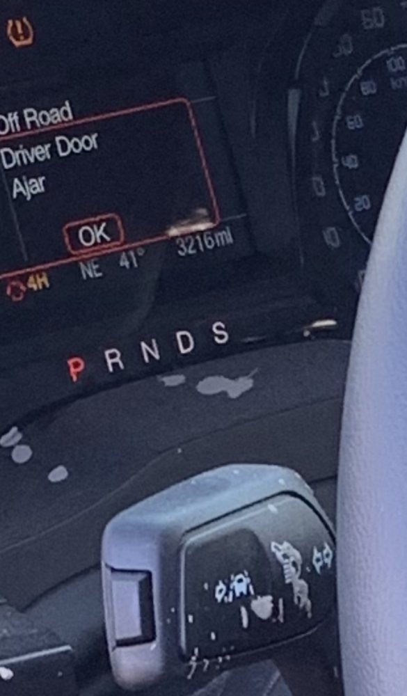

Haha!
Maybe yours is the Star Trek alternate dimension of mine. Mine looked worse than that when I got it, and little by little, I’m cleaning it up. It looks like a little by little, you’re destroying yours, and it will soon look like mine, when I got it!
And I was kidding @lil_Blue_Ford about a new one. Sweet pea just doesn’t understand that they’re toys, and therapy, and half the fun is putting them back together! (Of course, her German convertible rocket is fun on occasion…)

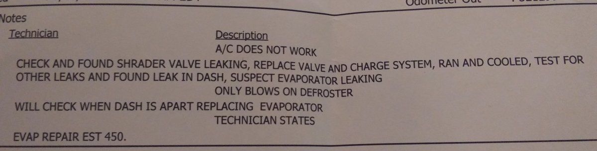

Dropped her off at the shop to get the AC fixed.(2001 XLT, 2.5, 5 speed). I thought it was a bad compressor. They said no, compressor ok but refrigerant leak under the dash, probably the AC evaporator. Do you have to pull the dash to access the evaporator ? Thanks ahead.
I'm pretty sure that comes out through the engine compartment on most Rangers. But it's not fun.
Pain but not dash remove thankfully. Here's an Exploder video of it being done. Should be the same or very similar.
It’s a lot easier to do the evaporator core without the pesky engine in the vehicle...
Forgot, this was the actual diag from the shop.

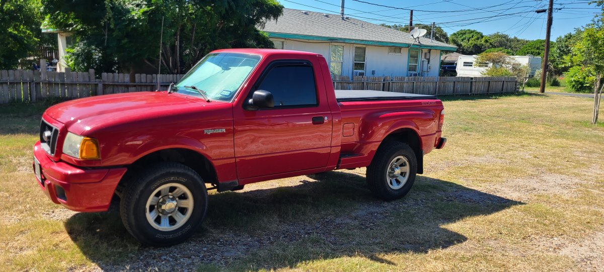

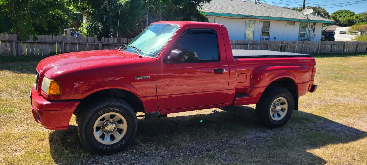

Just went and picked it up from the tint shop. My wife was complaining about the truck not having tint so she wanted it tinted. So here it is is. No rolling windows down for three days
